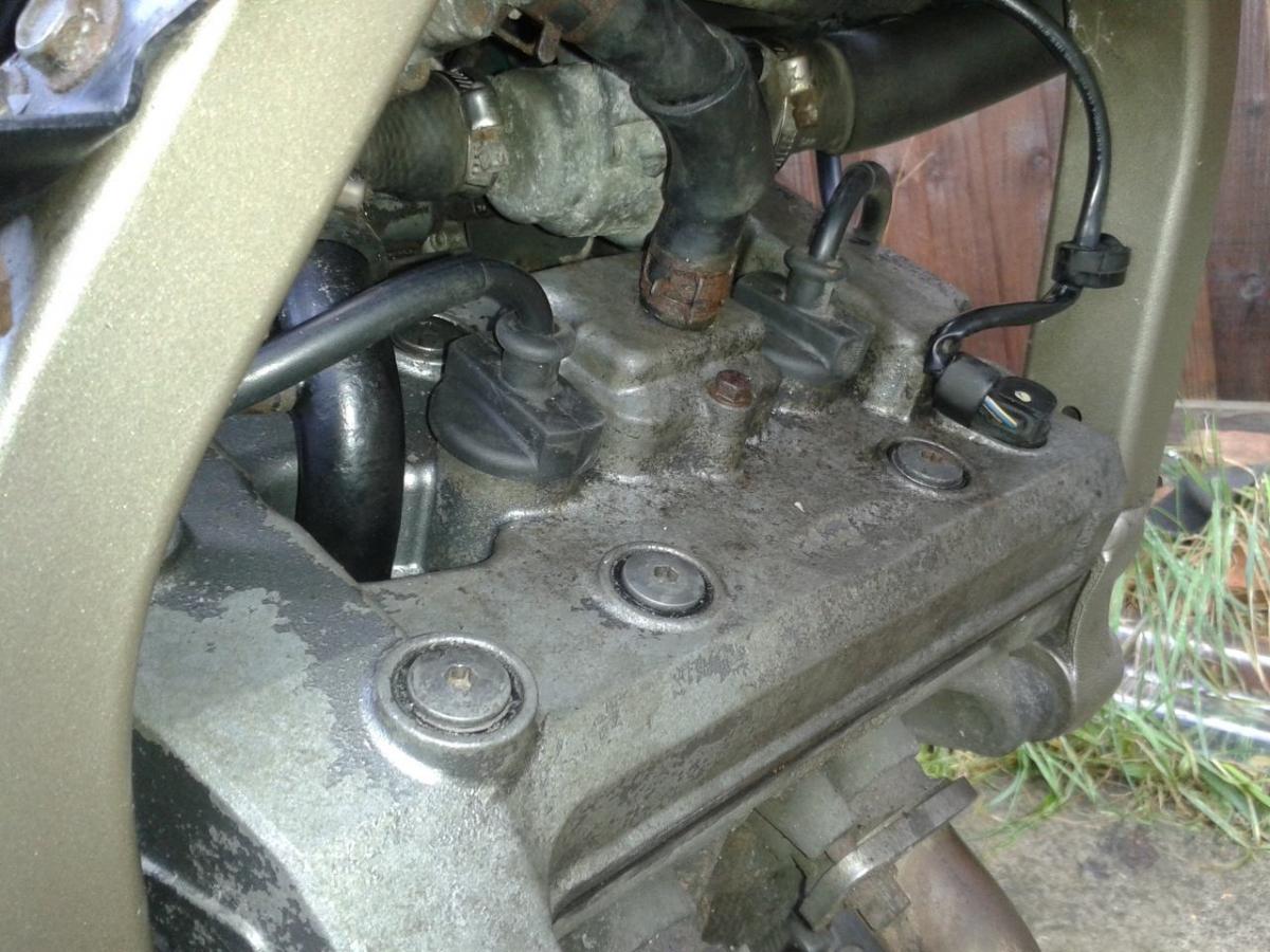

Since I had in mind to do a valve clearance check this ...ahumm... winter, I started removing all neccesary items.
This went fine, untill I got to the point of removing the 6 mm allen bolt, holding the top coolant tube. This little bugger resisted so hard, that I ended up damaging the inside of the bolt. Dammaged to the point that normal tools dont  get a grip on the bolt. Heating it, hitting it with a hammer, and the  sorts don`t help to get it fixed.
So now I am looking for tips, tricks or advice as to how get past this problem. All comments and tips are welcome.
And yes, removing the  tube  by means of sawing it of (kind of neaderthaler-way.. but maybe effective) is at this point the way I am thinking.
There must be an alternative that I haven`t thought of.
Thanks in advance.
Velf2003.

A good 3/8" drive torx drive battered in the mangled allen head, but needs to be slightly over size so it's good tight fit! the shock of knocking it in might help shock the bolt as well....but a word of warning!!!! it's alloy your working with "Dont go mental with the hammer" :good:
Bin there, done that.
And with succes
:good:
The silly bolt didn`t have a chance and was removed so easily that it me wonder why it couldn`t be removend  at the first attempt with the propper allen key.
@jono49: Thanks for the tip!!
Now the process of measuring the valve clearance, and if out of specs, shim the buckets will be the next thing to do.
By the way: whats with the whole labyrinth of bits, things and stuff onder the breatherpipe, between the two spark plugs.
It almost seeems that there are a pair of spring acuated valves there. Maybe there to prevent air going the wrong direction?
Cheers,
Velf2003

The valves are for the auxiliary air system.
EDIT - They do nothing to help performance,it's instead an emissions control device. If you don't have a cat in your exhaust they could be blocked off, but leaving them in place gives you the option
