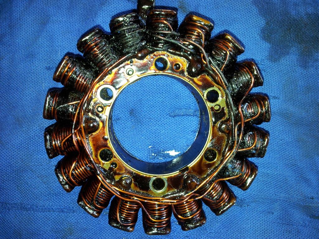

Here's mine

Here's mine
What's the other side like ? Any sign of burning where the lead-out wires connect ?

No pictures but it was OK, I think on this stator assembly that the core was bad and chafed through the insulation shorting out the windings because mine always went to earth and it was always the same group of posts.
If I'd had a spare I would have stripped it and polished the posts then re wound it.
