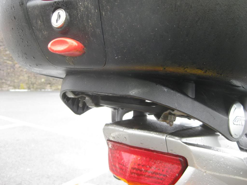

My bike came with Givi top box and pannier mounting kit fitted, the plate is an M3 for a monokey top box. I've already removed the side mounts and the brace bars for the top box mount as I think that if I need panniers then my soft ones will suffice. I would like a top box however and if I behave or more likely play my cards right then Santa might bring me one!
If I'm going the Givi route then a plain V46 which costs around £200-£210 should fit straight on. But ideally I'd really like to tidy up the looks by getting rid of all the clutter and bars off the bike, reclaim my bungee hooks which had to be removed to fit the givi bars, and then fit and use one of the mounting plates that sits above the grab handle.
Never seen one of these mounting plates in real life and can't figure how they are fitted, there only seems to be 4 threaded holes under the grab handle. Anyone got close up pictures of their set up or like to recommend a plate/box combination of around 40/50litres that carries a reasonable amount of weight. And importantly one which won't bankrupt Santa?
Ta .... John

#10 paddy900
Posted 13 November 2011 - 06:29 pm
I fitted a new Givi Monolock plate to my bike today,
I got the plate of E-Bay from this guy
Givi Plate
It came with everything you needed,
Here is some photo's from the fitting--15mins in total
Hope this helps..
Hope this helps..
Thanks Paddy it does up to a point. A couple of questions though.
1/ Monolock, most of the these are rated 3kg carrying load AFAIK, why not Monokey which all seem to rated 10kg?
2/ Does the plate touch the rear handle or are there spacers between the plate and handle? I don't much like the look of the rear clamps either (See pete7s post) as they touch the paintwork on the underside of the handle. As already said I'm a bit anal about avoiding scratching paintwork laugh.gif
I like the look of the Alurack, a fool and his money eh? ohmy.gif It'll probably be one of those or keep the monorack arms and just buy a box. Should make my mind up by the end of the week.
Thanks again Paddy.

#13 paddy900
Posted 13 November 2011 - 10:46 pm
QUOTE(tullyhubbert @ Sun 13th Nov 2011, 09:18 PM) <{POST_SNAPBACK}>
Thanks again Paddy.
I know that i have carried more than 3kg in mine, lots of chocolate cake rotflmmfao.gif
I dont have any spacers between the grab rails and the plate, you could make up some yourself if you liked,
When i told off the old rack today, which has been on 4 years there was very little marks. good.gif
