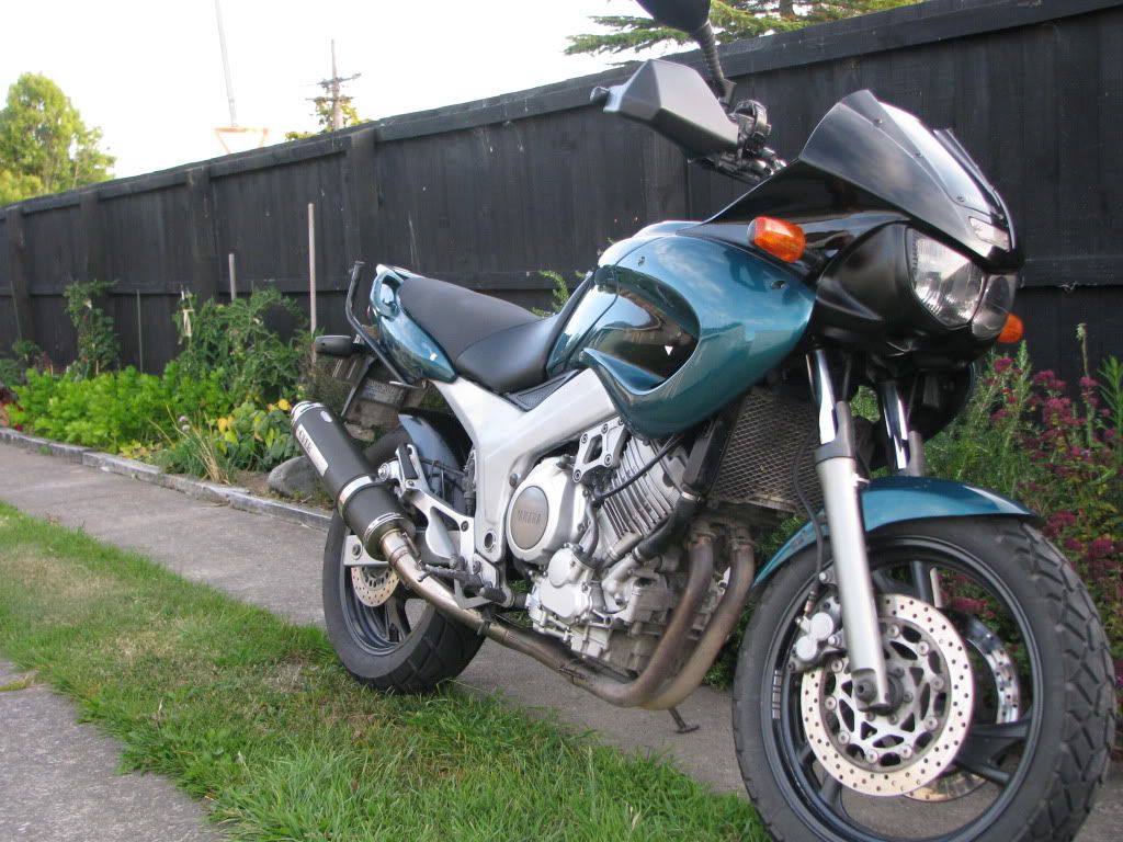

I've got a Pirelli Scorpion A/T on the front & Shinko 705 rear. Next time I will put on a matching pair of either. The profiles don't match, so I'm awfully close to running off the edge of the front. I'm happy with both tires (apart from profile) on gravel & tarmac. Very cheap too.

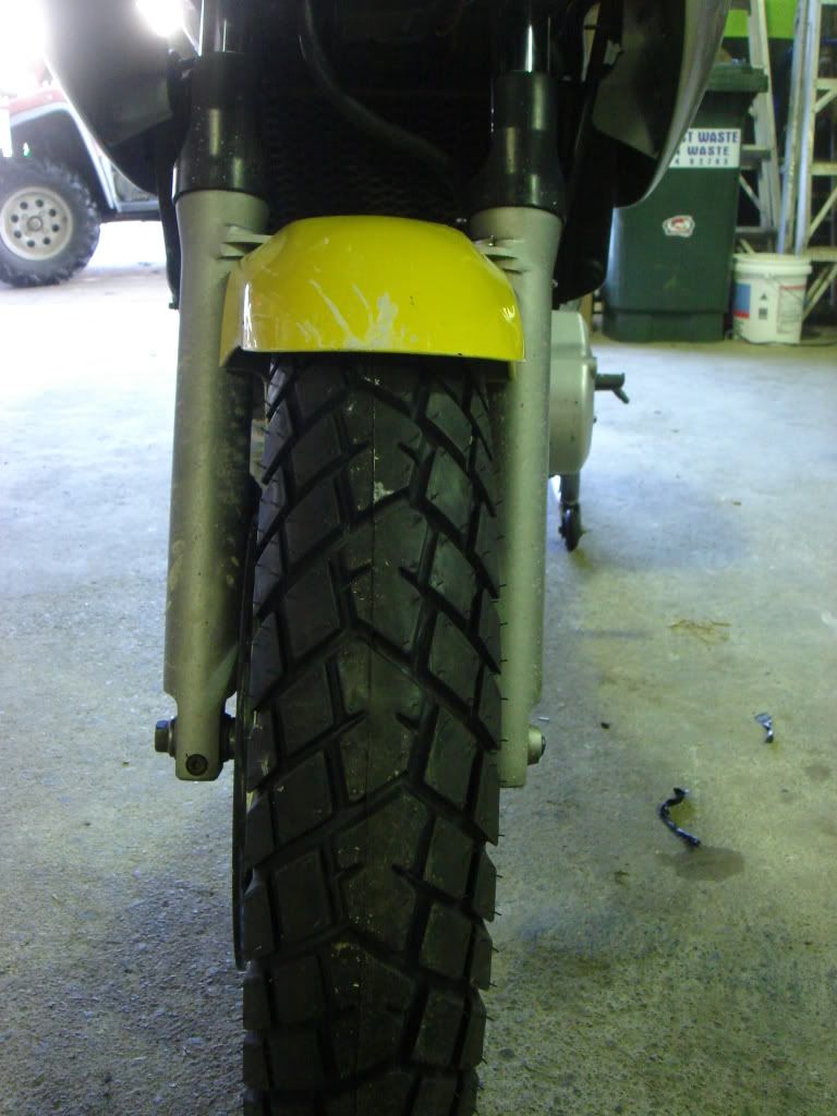

QUOTE(peve @ Mon 2nd Apr 2012, 09:28 AM) <{POST_SNAPBACK}>
Certainly did - here ya go.
Although these days, because of the very high proportion of sealed kilometres I've done recently, the bike is running Continental Road Attack 2's - not my first choice, but it's a long story...

I'm happy with the Scorpion A/T front on mine. As stated you loose a bit on the tarmac & gain a bit on gravel. All in all, I'm happy with the compromise. Not having quite as much confidence in the tires on the road has slowed me down slightly, a good thing, I have chicken strips for the first time in years. The tires perform way better than anticipated on gravel, my confidence is growing with them in leaps & bounds.
The G/F & I are playing about with gymkhana courses & practice braking technique every time we ride (she's a n00b rider) & the tires stick like poo. Braking performance is excellent & neither tire has let go on the courses even though I'm right off the edge on the front. Well worth a punt if you want to do a variety of riding. The rear Shinko 705 is lasting better than the BT 021 I used to ride with, 5000 km & it has not even started to square off yet, could be a throttle thing, though.....
