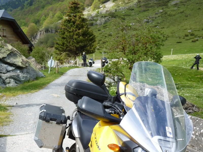

Interesting - I had something similar on my Niner when I did a Picos/Pyrenees tour back in 2010 with Hartside & a couple of others
The screen was a TDM Toraneko Tiger screen, designed & made by an old Carpe member from Oz
It was very effective - but I took it off in the end, as it was starting to stress the screen mounting points on the fairing - something maybe you should be looking out for Eagle6
Piccy here -
That's the beauty of Carpe - everything has been tried out before ![]()
Piccy here -
I'd thought of using a similar mounting method to the one on yours, with the sleeved bolts, and I thought stress would be my biggest issue. That's why I went with the brace at the bottom, hoping it would stop any shake. Also the top brace should help.
Time will tell!
