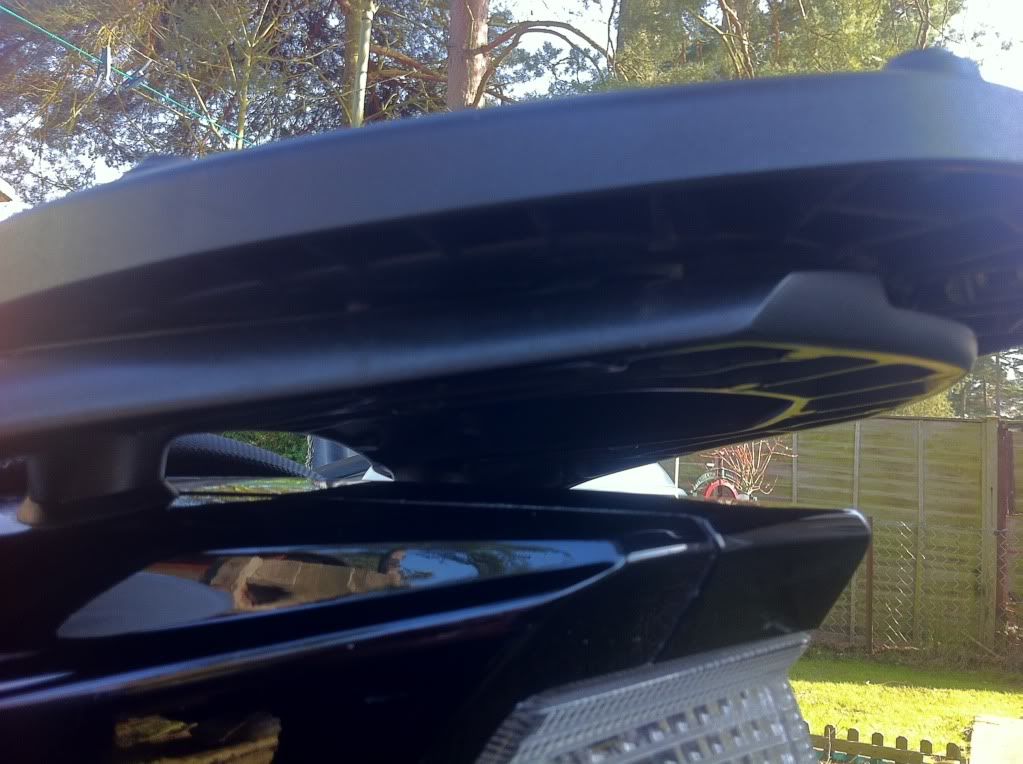

Hi GHL
I've fitted the Universal Givi Plate. I used the original front bolts. They don't line up perfectly but they do fit. I found that after tightening the front bolts there was a small gap at the rear of the original rack. The W clamps will flex the plate slightly to take that up. I'm planning to put a small shim on either side at the rear in the future to tidy up the fit.

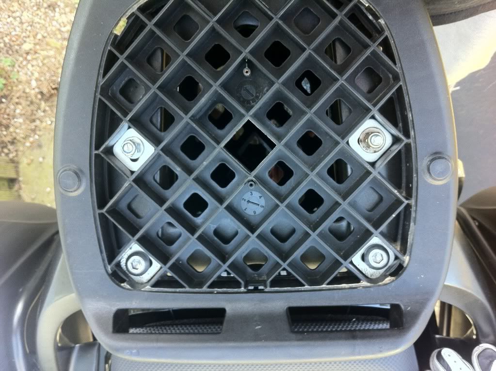

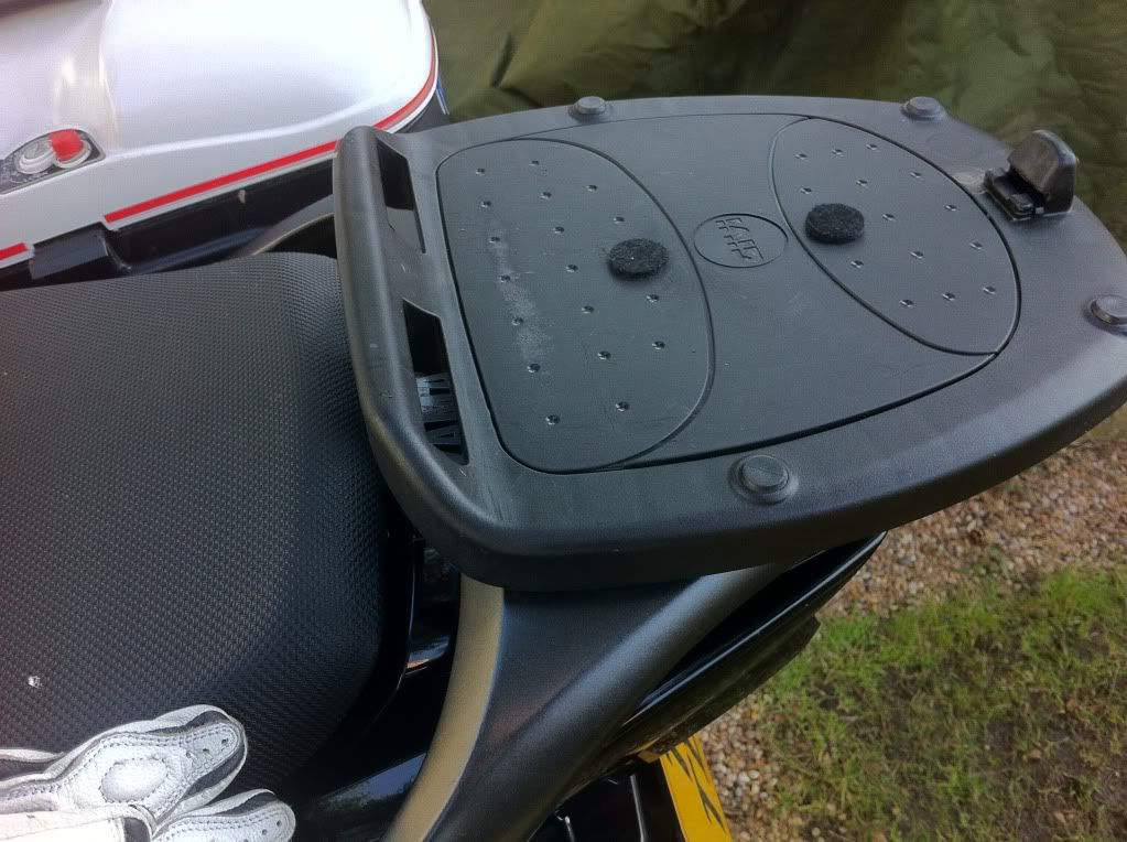

Here's my mounting
Used the Top Bolts that secure the Grab Rails and then drilled 2 holes further back. It's nicer as you cannot see any fittings. Solid as a rock too. good.gif

Many thanks Soapy and Cats for your replies.
Cats - unfortunately it appears that Givi do 2 universal plates, one is for the Monolock (like yours) and the other for the Monokey (like Soapy's). It appears that although a lot cheaper, the Monolock ones only go up to the 46 litre version (I think it's called a V46) so although it'd be good from cost (I am Yorkshire after all) - it's a little small to fit 2 helmets in.
Soapy, on yours, does that make the top box tilt up a bit, that is, if I was to do it the same way as you, do you think it'd be better to put the spacers on the front bolts and leave the back ones (on the W clips) directly bolted through?
It looks like the AluRack one have the spacers in the front

Hi GHL. I'm away for 2 weeks with my work. I can't remember there being any marked tilt. But if you can wait till I get back I will put up a sideview picture with the box on. Cheers John S

Hi GHL. Got home today and went for a run, the weather is unreal. I have sent you a couple of PM's but they are not showing as sent. The box has a slight nose down attitude, it follows the profile of the rack.
