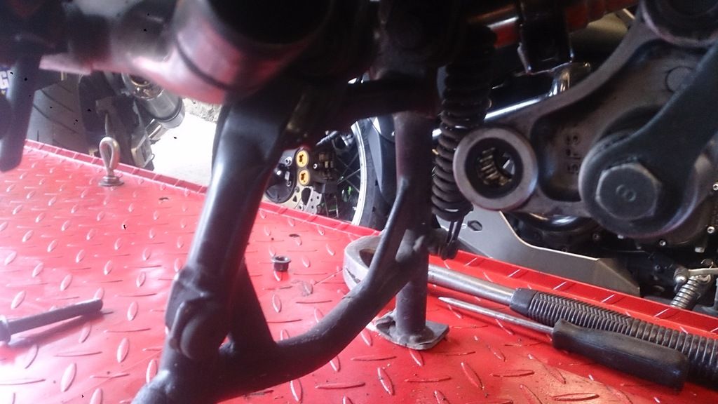

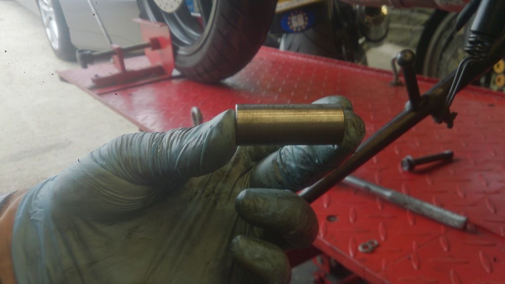

#99 big dave
Posted 19 July 2015 - 05:11 pm
Invited Martin (Bathy) up to use facilities at chez BD to get the reluctant bush out.
It were a tough little bugger to extract. The 6mm rawbolt wouldn't fit down the bush centre, so with a little help of the grinding wheel and an expanding bolt I found in my odds and sods tub we came up with a expansion bolt that would fit.
Still wouldn't come out (little bassad).
We only succeeded in extracting the bolt from the bush.
A quick roughen up of the bolt on the grinding wheel in an attempt to get more purchase and a spray of RAF "freeze and lubricate" finally resulted in the bush admitting defeat and a smug smile on both our faces.
Edited by big dave, 19 July 2015 - 08:08 pm.
