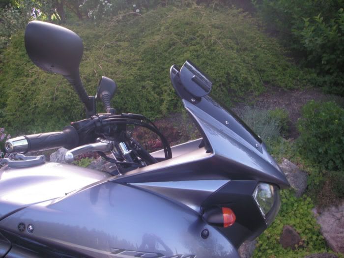

Today I decided to do what I'd been thinking of doing as soon as I got round to do it. Today was the day.
I took my PUIG screen (yes, I've got myself a Puig screen after our last screen discussion...) and drilled four holes in the main screen and fitted this MRA spoiler to it.
And I went for a solution that's slightly different from the original:
First; the Puig screen is not as tall as the original MRA Vario; Puig has the same size/height as the stock Yamaha screen.
Secondly I fitted the spoiler piece a little lower on the main screen than how it's fitted on the MRA.
Then I went for a ride...
And guess what? It worked like a charm!! Better than anything I've tried before biggrin.gif
It was a perfect day to roadtest the new 'vario-screen' because it was a very windy day; side winds and head winds.
No buffeting at all to talk about and very much quiter inside the helmet and not to forget; clean air and almost no 'dirty' air.
All in all; very much better than any other solution I've tried!
Right now it seems I've found the perfect solution I've been looking for:
A 'Vario' spoiler fitted on a short screen (like Yamaha's stock screen) might be the rigt solution for people like me that's about 6 feet tall (184 cm).
And it seems like it works best at the lowesat setting - check out the photos below...:
Here's how it looks in the highest position:

thanks for the info AJ! looks like an original one!
A 'Vario' spoiler fitted on a short screen (like Yamaha's stock screen) might be the rigt solution for people like me that's about 6 feet tall (184 cm). And it seems like it works best at the lowest setting

That does look like the perfect screen, at least for folks our length. A bit shorter, but still wide, nice.
