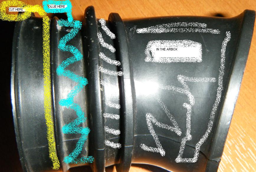

Cut me a coupla 2.5Cm edit: ta Steve again sections off (one fur each rubber). I found a band saw to give the the cleanest cut. If ya dunnae have access to wan then put a jublee clip round the toob where you want it cut and then work round with a nice sharp blade..........WATCH YER FLINGERS!!!!!! Else a cardboard tube inside the tube and a hacksaw maybe?
Then oi cut the existing mullered rock 'ard rubbers as shown below:
Attached File  airbox_rub1.JPG   119.86KB   142 downloads
http://www.carpe-tdm...-1279297081.jpg
Next oi used silicon adheeeesive to stick on the 2.5Cm edit: ta WiCkY replacement section. Did it really need glueing in place?...mayhap snot.

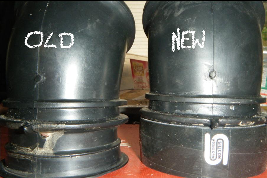

Here's one I made earlier:
Attached File  airbox_rub2.JPG   74.85KB   175 downloads
http://www.carpe-tdm...-1279297216.jpg
The new wan is a likkle taller...cous 2.5Cm edit: ta Steve was on the generous side to give us a likkle squish whenst fitting.

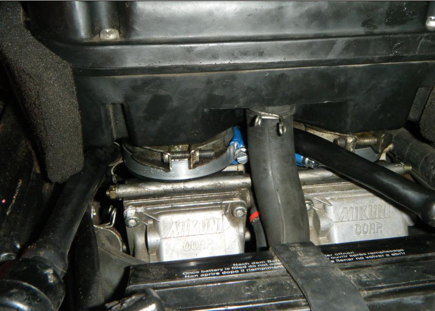

Since the phirrips clamps are a pain and the clip rides up oi decided instead of lobbing it in the bin, to move the thing to the top of the silicon tube for extra clampability and to stop the new lower hex headed jubbly clip from drifting up (not that it should now it has flat pipe on the carb lip.
That left me ear:
Attached File  airbox_rub3.JPG   58.92KB   157 downloads
http://www.carpe-tdm...-1279297706.jpg

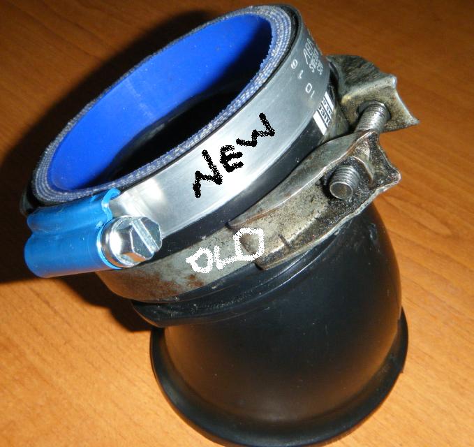

All thats left now is to fit em on, clamp em down and rag hard on the airbox to see if they pop.
Attached File  airbox_rub4.JPG   82.97KB   113 downloads
http://www.carpe-tdm...-1279297779.jpg
I ragged hard enough on the airbox to start to worry about the inlet to carb rubbers coming off...at which point oi stopped and concluded....THE JOBS A CARROT.
