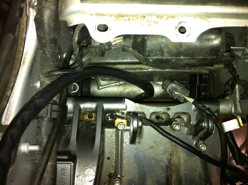

So now i had an engine i could use. There were still some questions about the wiereing.
I am trying to fit the new motor in the frame.
First change the botom motor bracket. The TDM900 aluminum bracket on the photo. The TDM 850 steel bracket fits right on. It is a good idea to fit the starter motor to the engine while it is still loose.
First get the bottom engine mount bolt in place. Then jack the motor up till the top/rear engine bolt can be put trough. My frame was a little to narrow for the new engine at the top/rear engine mount. There are two bushings welded to the frame, the engine slides in between them, and then the bolt is passing trough the frame, bushings and the engine. The bushings on eather side of the frame were about 1 mm to tight together. I grinded them down so the engine coulod be fitted.
It loks doable. The right hand upper engine bracket does not fit. There is a casting of the cylinder block that is not used. But not in the same place as on the 850 engine. It is easier to make a new bracket than modify the old one.
The left hand will not fit either. There are no moutning points on the castings.

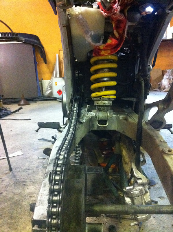

The aligning of the chain was one of the problems i know of. The 900 engine has 6 gears it is a little wider, and the front sprocket is moved further out.
I shortened the outgoing shaft. In the 900 it is used for speedometer, and i will not be using it.
The chain could be fitted. And it seemed like the chain could be aligned.
The C-C distance for the carbs seems to be the same. This makes it much easier.
The oil fil tube could be fitted.
The oil tank from 900 seemed to fit.
#48 dapleb
  • 18,393 posts
Posted 27 December 2011 - 04:06 pm
Allorra work to do their. Very interesting to see what does and doesn't fit directly.
Not familiar with 9'er output shaft but is that the thread what holds the front sprock nut on that you have cut off?

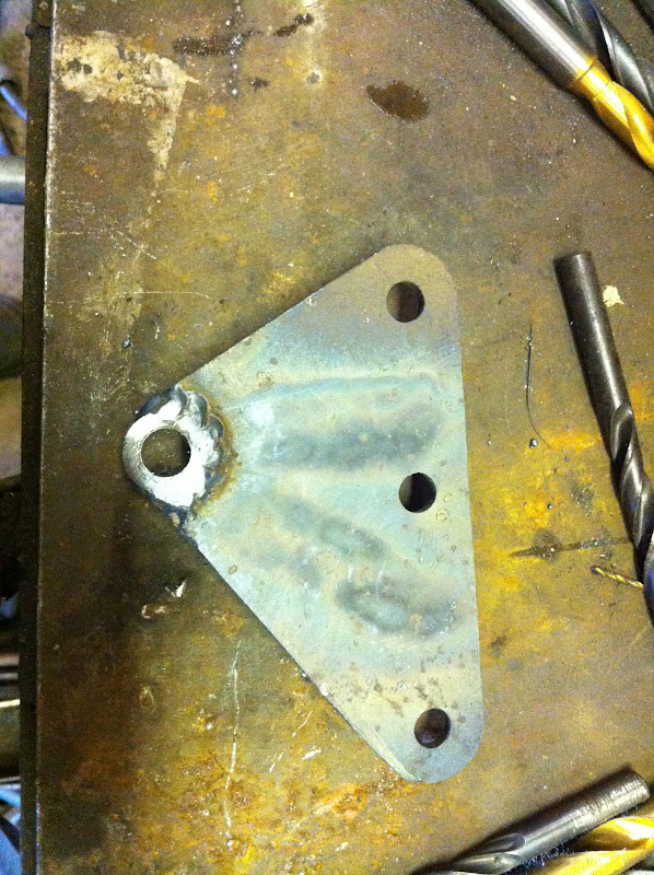

The new engine brackets

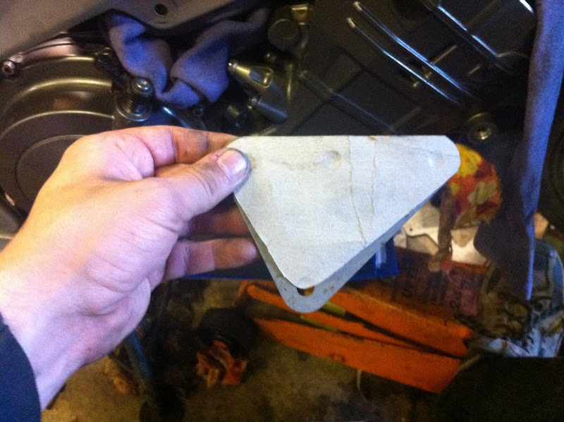

When the engine was in place, templates for the new engine brackets were made. Great care should be taken when making templates. I was a bit careless, which resulted in more work later.

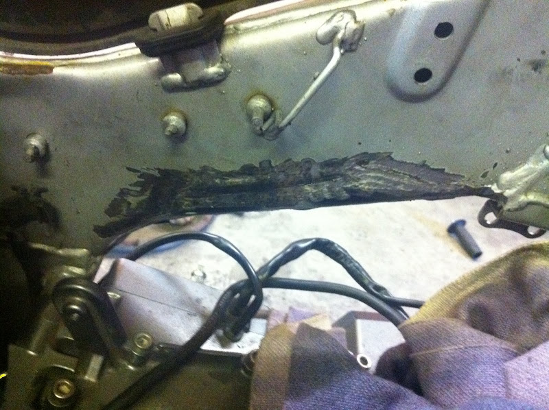

The casting on the 900 engine is prepeared with a mounting "ear", but it is not drilled or threaded.
For the right side bracket i moved one of the mounting points on the frame. I used the same mounting "ear" on the front of the cylinders that is used in the 900. Sorry for the shitty pictures,
Just pased the point of no return
Inside of the frame
The new location of the mounting. I will later realize that the coolant hose from cylinders to the radiator pases there.
A friend had acces to a water cutting machine and he helped to cut the brackets from 5 mm construction steel. He cut both engine brackets and a 5 mm spacer for the rear wheel.Unfortionaly my templates were not that accurate.
Made a new template
Grinded the bracket to correct shape
Then prepared the engine castingsgrinding the surface of it, drilling a hole, and threading it.
M12 x 1,25 same pitch as on the 850 engine.

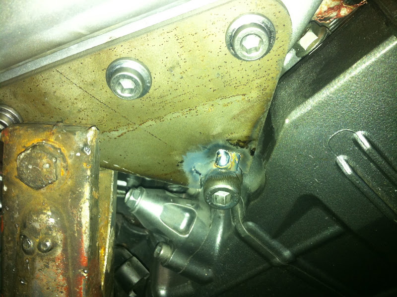

Grinded some more on the bracket
I used the bolt from the 850 engine and fastened a bushing. The bracket was grinded until ut fittet with the bushing and the three other holes.
Then weld them together.

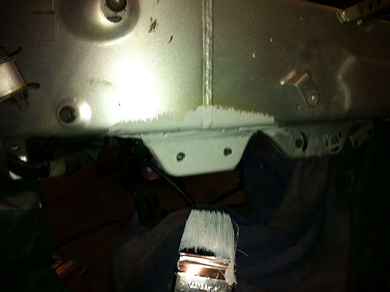

Welded the bushing properly, and welded on some flanges to make it stronger.
The flanges were grinded down somewhat later

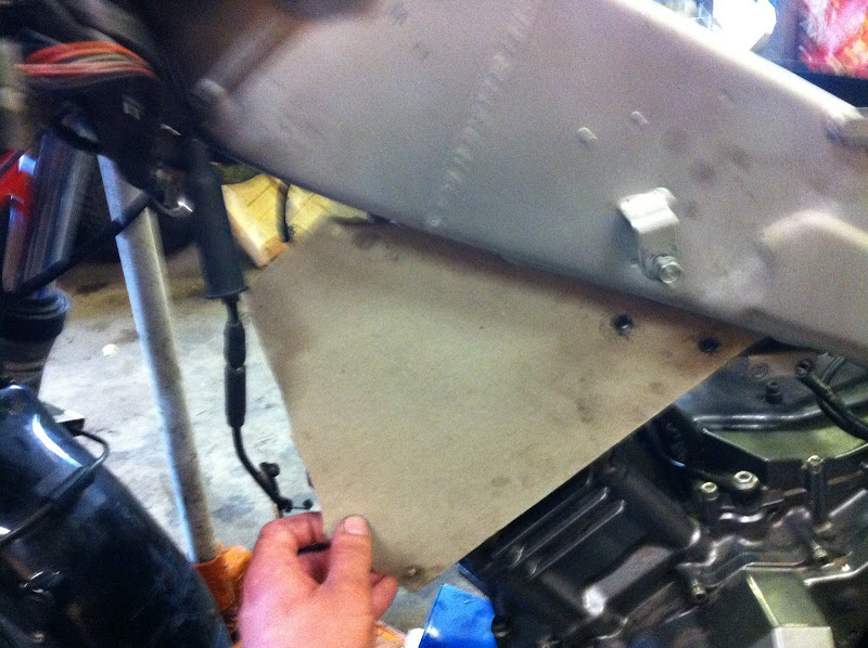

The left side bracket
I bought a bolt that fitted. M12 x 1,25
I am in need of a better looking bolt,
The bolt was fittet with a bushing, same as the other side. And the bracket grinded and fitted.
Then welding it to the bushing and fitting the engine mount. The engine is hold in place by the rear mounting points. Note that the bushing takes up some "axial" play. I dont need to bend the bracket to make it fit properly.
Welding the mount to the frame

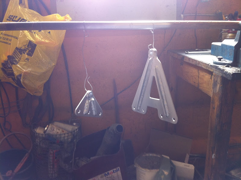

Adding reinforcement flanges, and welding the bushing properly.
Grinding down the flanges and cleaning both brackets.
Then painting. First ground, then silver.
Also ground paint on the welded mount on the frame. This was also spray painted silver later.
