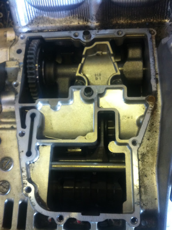

So, first take appart the 850 oil tank. After 50 000 km there is quite much dirt in the tank. I think it is a good idea to open and clean it sometimes.
Then take the bottom part of oil tank of the engine. One can see the gear shift drum and balander axel. The balancer weights pases the same place as lover end of the conection rods. good.gif
Removing the same cover from 900 engine. Looks similar.
Here the 900 engine with a new gasket for the 850 engine.
When comparing the covers one can see that the oil groove is curved on the 900 engine. Otherwise the covers are identical. The oil groove is probably for lubrication the outgoing shaft bearing, wich is located further out on the 6 speed 900 engine.
When fitting the bottom of 850's oil tank to the 900 engine the oil groove is sticking "out" from under the cover. See center of the image.
I was thinking that the best solution would have been to modify the cover by adding material to it (welding), and then evening it to get a good sealing surface. I think this would have been easier and more durable than using the 900 oil tank. But I did not have a aluminium welder, and didnt think that it would be so hard to fit the 900 oil tank.

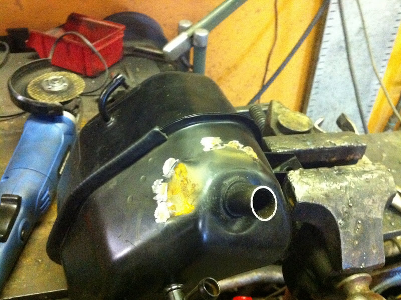

There is no oil pressure sensor, so I wanted to be able to check the oil level in the oil tank. I will not be able to use the oil fil tube from the 900 oil tank, my new engine bracket was in the way. So it will not be possible to check oil level with the 900 oil stick.I am thinking of runing a transparant hose from the bottom of oil tank to the top. One will se the oil level in the hose.
Chopping of the oil filling tube from the 900 oil tank.
Trying it out and then cutting away some more.
More like it
I am using the oil filler cap assy from the 850, but with new hoses. It took quite many tryes to get it right. I do not remember if this is the final design.
Welded in a connection for the oil level hose at the bottom of the oil tank. One of my ugliest welds, and reason to use the 850 oil tank. But after some salant it didnt leak. You can also se the oil level sensor. It will not be used.
Painting it, and securing the oil level sensor cables. Then cleaning the tank so no residues from grinding remains in the tank. It looks terrible, but no one will se it. :/

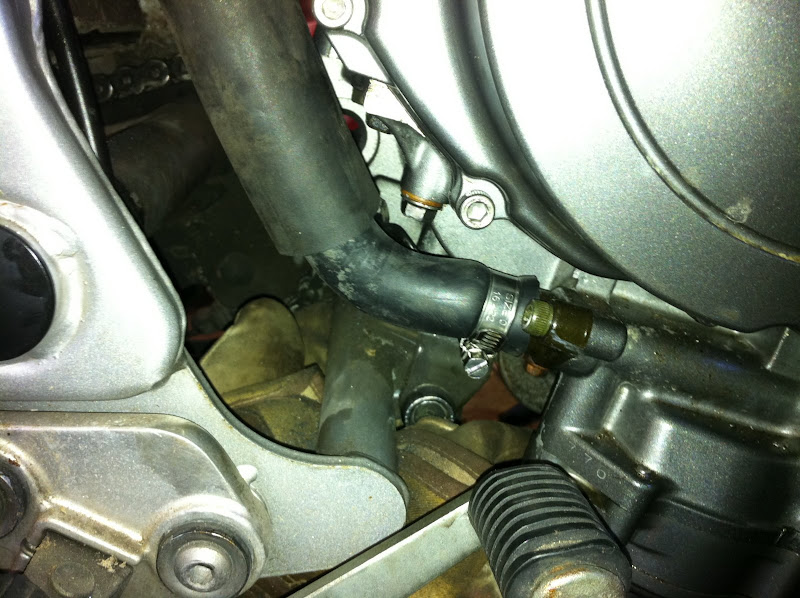

The hose from the oil tank to the oil filter did not fit, nor the one from 850 or the 900. The swingarm and other parts were in the way.After sarching I found this one at Biltema. People knowing of Biltema may be a bit sceptical, but it holds until now.The thicker part is another hose that sliped on. It is for not waring against the swingarm.
The new oil hose installed.
Under the engine
Behind the engine
The connection from oil pump to the oil tank fitted without modificationThe oil level hose. The T coupling will intersect the breather hose from engine to the top of oil tank.
Oil level hose installed. I can see the oil level on the hose. One can see that the idle adjuster will not fit for the oil tank. One more reason to use the 850 oil tank.

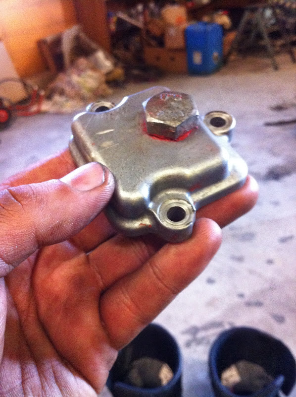

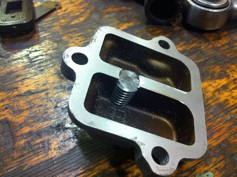

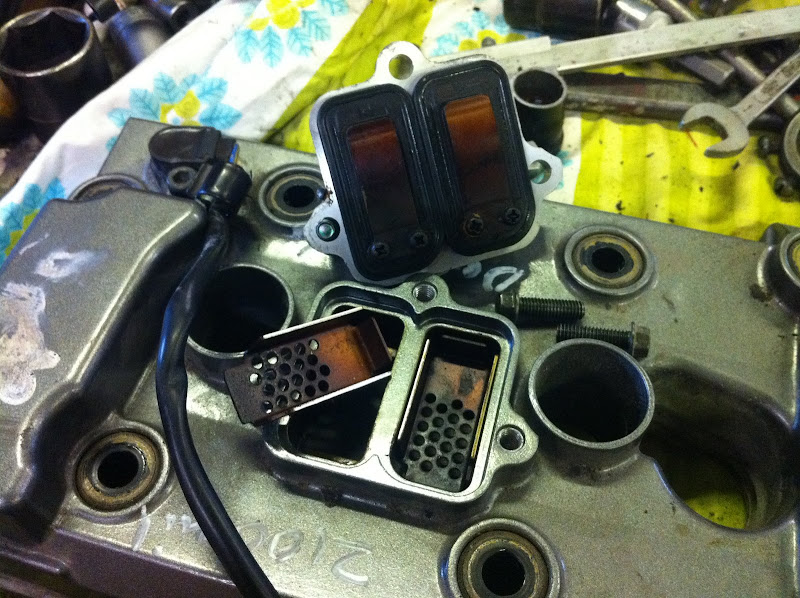

Then there is this. Exhaust gas recycling? There were no such things on the 850, so I had nowhere to connect it. I decided to plug it.
First attempt with a plugged piece of hose did not work. It interferes with the fan. :/
It must be smaller. So I cut of the connection
Threaded the hole in the cover with M10 x 1,5 (regular metric 10 mm). And prepared a bolt with correct length and a exit for the thread under the skull.
Sealed it with heat resistant sealant and torqued down.
Then assemble the reed valves and such back into the valve cover. The head of the bolt is not interfering with the fan.
