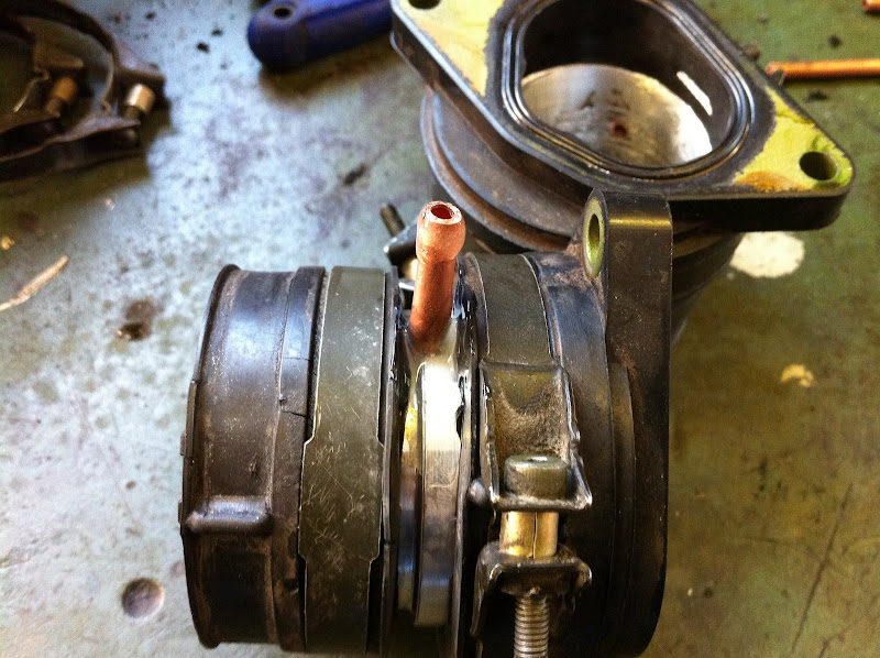

With the 850 rubber boot it has the same height as the 850 inlet. The 850 original inlet on the left.
Between the boots there is enough space for a vacuum tube connection. It will be used for synchronizing the cylinders.
The connection is made of copper car brake tube. It is pressed down in a tight fitting hole and glued.
Since the 900 inlets does not have a cylindrical shape, some grinding was necessary. I used a dremel like tool to remove some of the vulcanised rubber from the 900 inlet manifold. Metal was exposed in some places.
By doing so the cross section area was not constant trough the inlet manifold. It increased when near the 900 inlet and aluminium adapter mating. It is not good, but I do not know if it is critical for this engine. There are no sharp edges tho.
It is better to make the inner diameter of the aluminium adapter cylindrical, and then grind it to fit the shape of the 900 inlet.

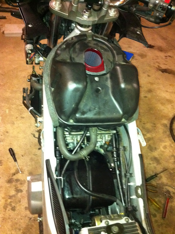

Then installing of the carbs. Some wires and hoses needed to be rerouted due to the same bracket. Choke wire was a pain.
Here is a pic of the oil fill hose.
And all the tubes and stuff surrounding the carbs. Here I also discovered that coolant is circulating into the carbs and heating them :/
Then on with the air filter box.

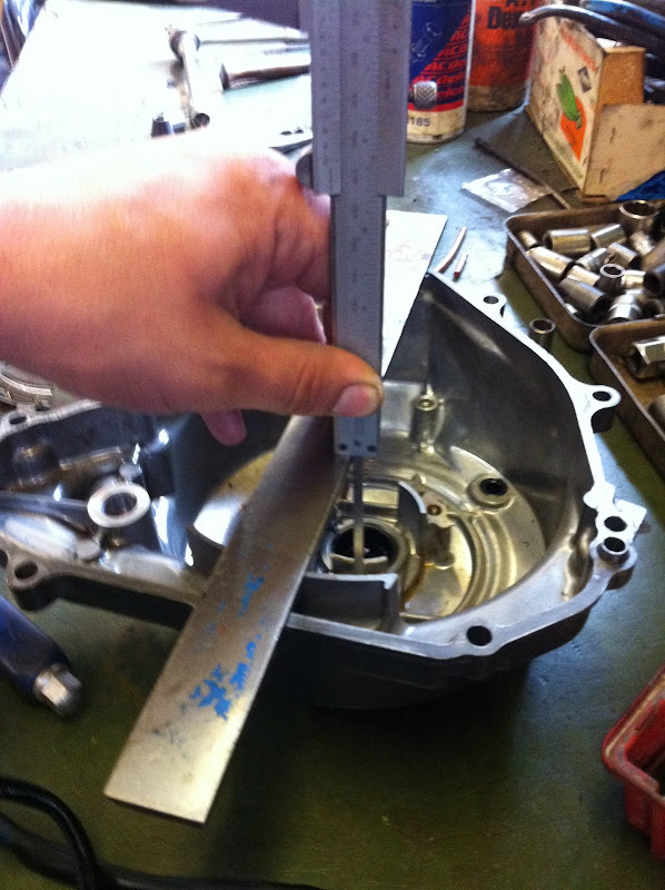

The 900 generator to the left, and 850 to the right. It is also quite easy to figure out the electrics. 3 cables from the generator winding. And 2 from the pickup coil.
One difference that I noticed, was that the 900 engine has a bigger generator, both windings and the rotor. I wanted to use the bigger generator, but the windings are mounted on different depths in the cover. The 900 winding can mot be mounted on the 850 cover, and then on the 900 engine with 900 rotor.
The winding. The bigger 900 winding on the left.
Measuring the mounting depth in the cover. The 850 cover is more "shallow" and will not allow the 900 winding to be fitted. Winding will interfere with the rotor.
In the end I used the 850 cover with the 850 windings, but with the 900 rotor. Both 850 and 900 rotors has the same number of magnetic poles, and both winding has the same number of "slots". So it should be no problems. Since I am using the 850 cover and windings the connections to the bikes harness are no problems.
