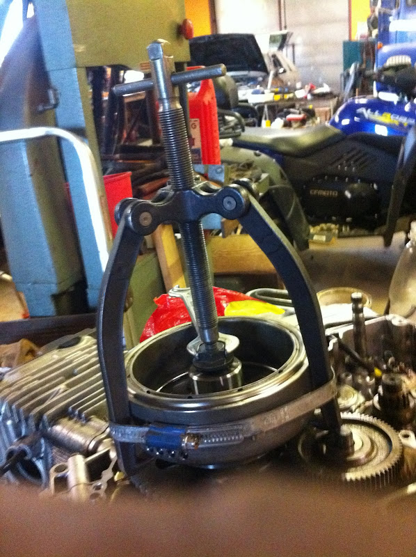

The first attempt with some kind of rotor removal contraption, it failed of course smile.gif
Then, after reading about some kind of special removal tool, and finding three M8 threaded holes in the rotor, work with designing a special tool could be started.

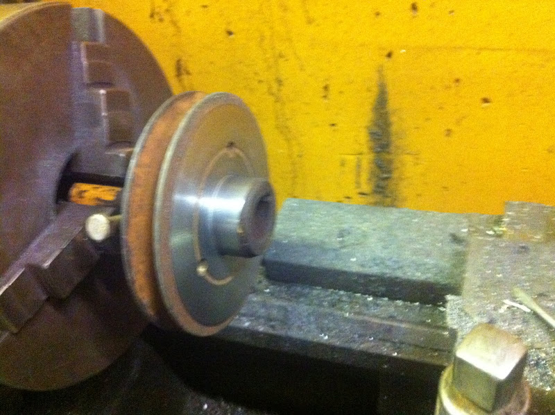

I took a used pulley, made a grove with the right diameter in the lathe....
And drill 3 holes in it with 120 deg pitch. Same bolt pattern as the threaded holes in the rotor. The bolt pattern didnt match perfectly, but good enough.
Then turn away some more material
Prepare some bolts, and assemble the new special tool

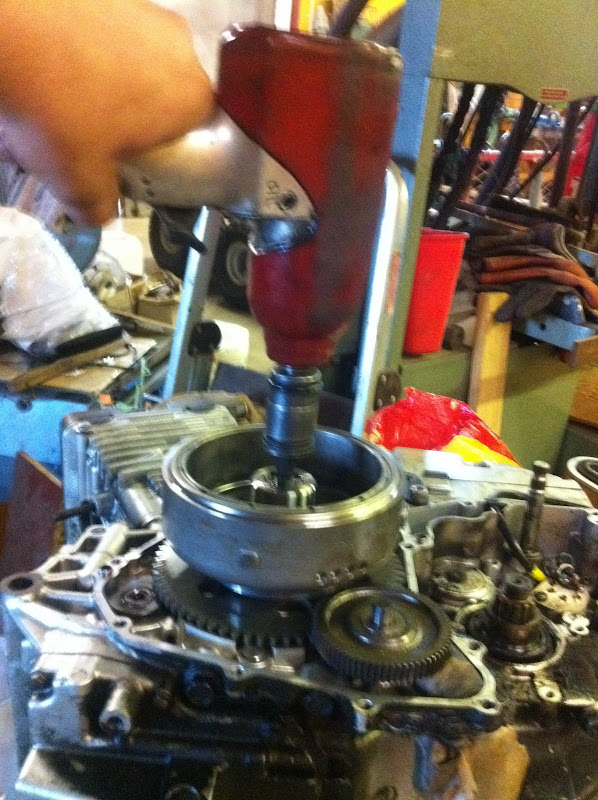

well, until now it was easy. The rotor did not want to let go of the crankshaft.
I tightened it down properly, used a small hammer, then the bigger hammer, nothing.
Tightened the bolts down some more.
I did not want to heat up the rotor, or use too much violence, the magnets could get damaged.
I bought a pneumatic rivet hammer, since some had succeeded using one. Hamared with it until I destroyed one of its tools.
After two days with the special tool applying pressure the rotor it finally let go of the crankshafts end.
The same procedure on the 900 engine went much easier. Maybe because it has not run as many miles.
Here are the tools I used. The thing with 3 arms, is not really necessary tho
Then the both rotors could be compared. And great success. It seemed to be the same taper on both rotors.

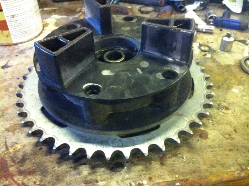

Since the new motor has 6 gears, the front sprocket is moved outwards. This messes up the alignment of the chain.
My first idea was to move out the rear sprocket a little and move in the front sprocket a little.
The rear sprocket, spacer plate and sprocket hub.
The thickness of the plate was 4 or 5 mm.

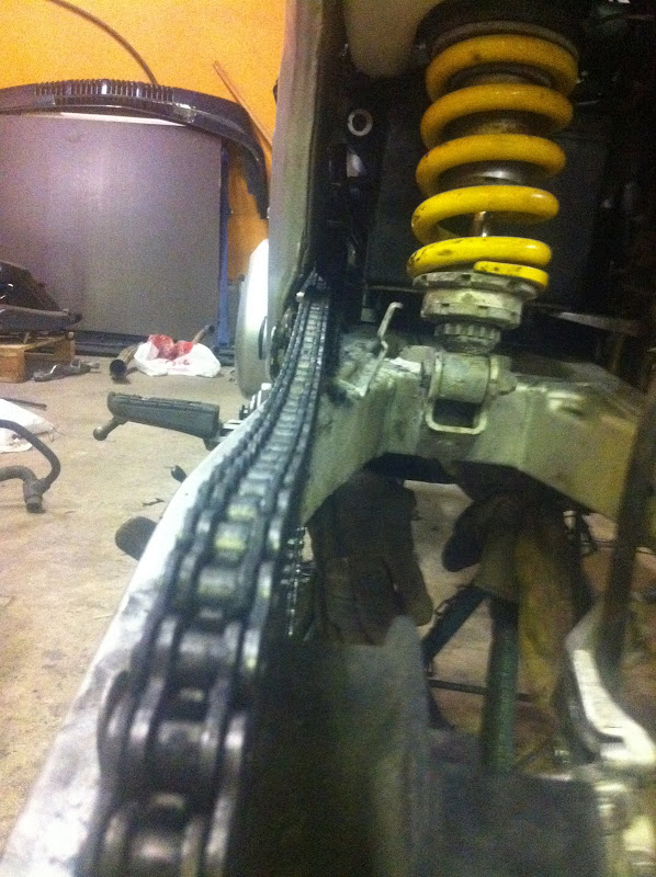

But immediately a problem, the interference between the chain and the frame was too big. You could not hear the motor over the chain grinding against the frame.
#117 anda3243
anda3243
  • 89 posts
  • Location:Stockholm
Posted 09 November 2012 - 11:46 pm
The chain cont.
The chain needed to go inward. And the frame needed some work too.
The rear sprocket spacer was removed.
The bushing behind the front sprocket needed to be shortened. But it was stuck on the shaft. It is interference fit. I did not want to heat it upp to much as the rubber seal could be damaged.

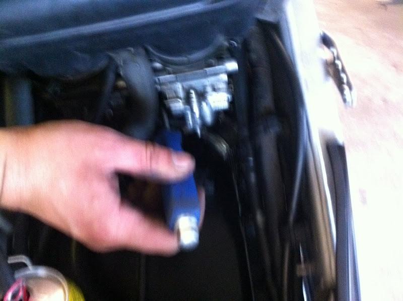

I did some carb tuning
One can reach the carb balancing screw without removing the air filter housing.

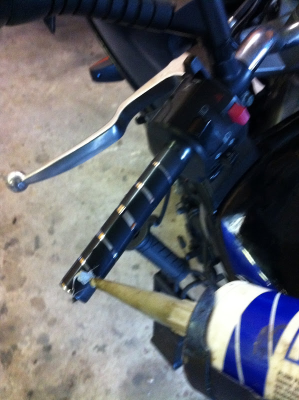

Also attaching the handlebar grips properly. Tape to take the play and strong glue.
