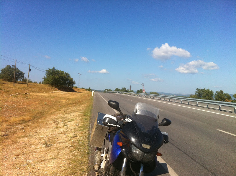

The windscreen
As I was riding, I did some experimenting, putting my hand up making the screen taller. It seemed as if the screen was 5 to 10 cm higher it would become much more effective.
I was thinking about buying a different screen, but it was quite expensive, and how well a different screen would perform was not known.
I went wit the idea of fitting an adjustable wind deflector. (as on many MRA screens).
I purchased 2 MRA sparepart "hinges". And a piece of lexan
I was told by the glazier guy that lexan was the way to go for a windscreen, much better than the plexiglass. It could also be bended without warming, he told.
The lexan cost me about 2 eur. :)
The sheat begining to take shape
Posted Image
The shape is about right,
These are the hinges I will be using.
Posted Image
The bending of the lexan sheet was very difficult. I could bend it so the shorter edges touch each other, but the sheet regained it original flat shape. After much shaping aginst a 40 mm steel tube I got the curvature. Some careful measuring and drilling and it could be attached to the original windscreen.
Downside was that the lexan became a bit "milky" because of the bending. When flat you it was fully transparent. I wonder if it would have been better to form it with a heat gun.
Posted Image
For my lenght and riding position this works ok up to 90 km/h, with higher speeds it more windy but still better that without.
The total cost for this mod was under 30 EUR. The result was not as pretty as a new purchased part would be. But it does its job, and unless you examine it in detail, you cannot tell its homemade.
And some action pics of the finnished result.
Posted Image
Posted Image
Posted Image

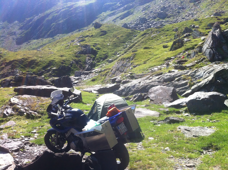

The panniers
I did some searching for different off the shelf panniers. I didnt find anything that I liked.
I wanted panniers that are opened from the top, so your stuff does not fall out when you open them. I would also preferred aluminium as It looks better.
Most of what I found was in plastic and opened in the "wrong" way. Some were for the 900 bike only. Some were very expensive. Some were very ugly.
After some time I started to look for aluminium boxes, ex military equipment boxes...
After some time I found a small company making what I wanted,
A simple aluminium box with a lid. The box has a lid on hinges and small latches that can be locked with a small padlock. Each box is 33 litres.
These were actually custom made as I wanted 33 not 40 or 45 litre boxes.
For attaching them I bought a used set of givi racks. Can seen in background on the first pic.
Posted Image
Posted Image
It took some time to make the givi racks to sit straight. Then there were some manufacturing, welding and grinding. No pics of that. The idea was to bolt the panniers to the racks with 5 pc M8 bolts and big washers/brackets from inside that spreads out the load.
Here I am cutting out a piece of rubber that will lay inbetween the pannier and the rack. Racks are modified and painted.
Posted Image
Then I attached a cut up sleeping mat as lining. The mat is attached with double sided tape. The lining will prevent my stuff from rattling around too much and rubbing to the aluminium.
Posted Image
The finished result:
Posted Image
Posted Image
The opened lids work as temporary storage when packing and unpacking from the panniers.
But I will need to reinforce the givi racks and attachments of the panniers to the racks. The boxes started to deform after some time.

:badgerrock: Nice set up Anda, Nice and light and not to big!.......Give us a hint of how much the boxes cost?????

Anda they look the biz,
ditto above, any link, approx cost?

The cost for the panniers including shipping and padlocks was 634 USD. or 500 Eur http://www.coyotetri...e/shop/shop.htm
The used givi racks 70 gbp or 90 EUR
Other bits of pieces, 300 sek or 30 EUR
And some labour
The total for me 620 EUR
It is not the cheapest solution. But I am happy with the result. And I think that its worth the money.
One downside is that the panniers makes the sitting position for passenger uncomfortable, The front inner corners for the panniers will be cutting in the passengers legs. The panniers could be placed further back, but I did not.

I decided to continue the trip despite this mishap. In Budapest I changed the main jets to size 150, the ones that were fitted were way to big. The stock size is 142 I think. Spare spark plugs were bought. Air filter was oiled up again.
After this the bike run well. I wisited Romania, Bulgaria, Turkey, Greece, Serbija, and back to Sweden. And did some riding in Sweden during the autumn. I had no problems with the bike at all.
