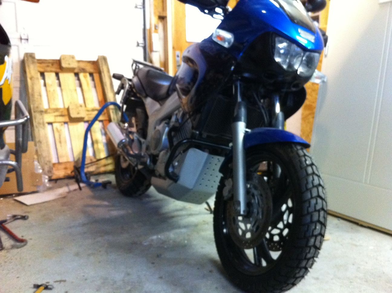

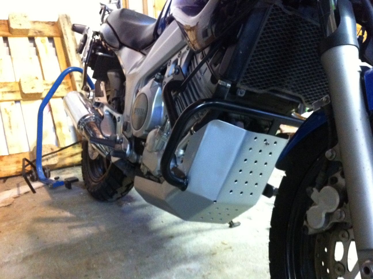

Hi.
A big "Thank you" to Kyotoviking for inspiration http://www.carpe-tdm...o...c=19803&hl=

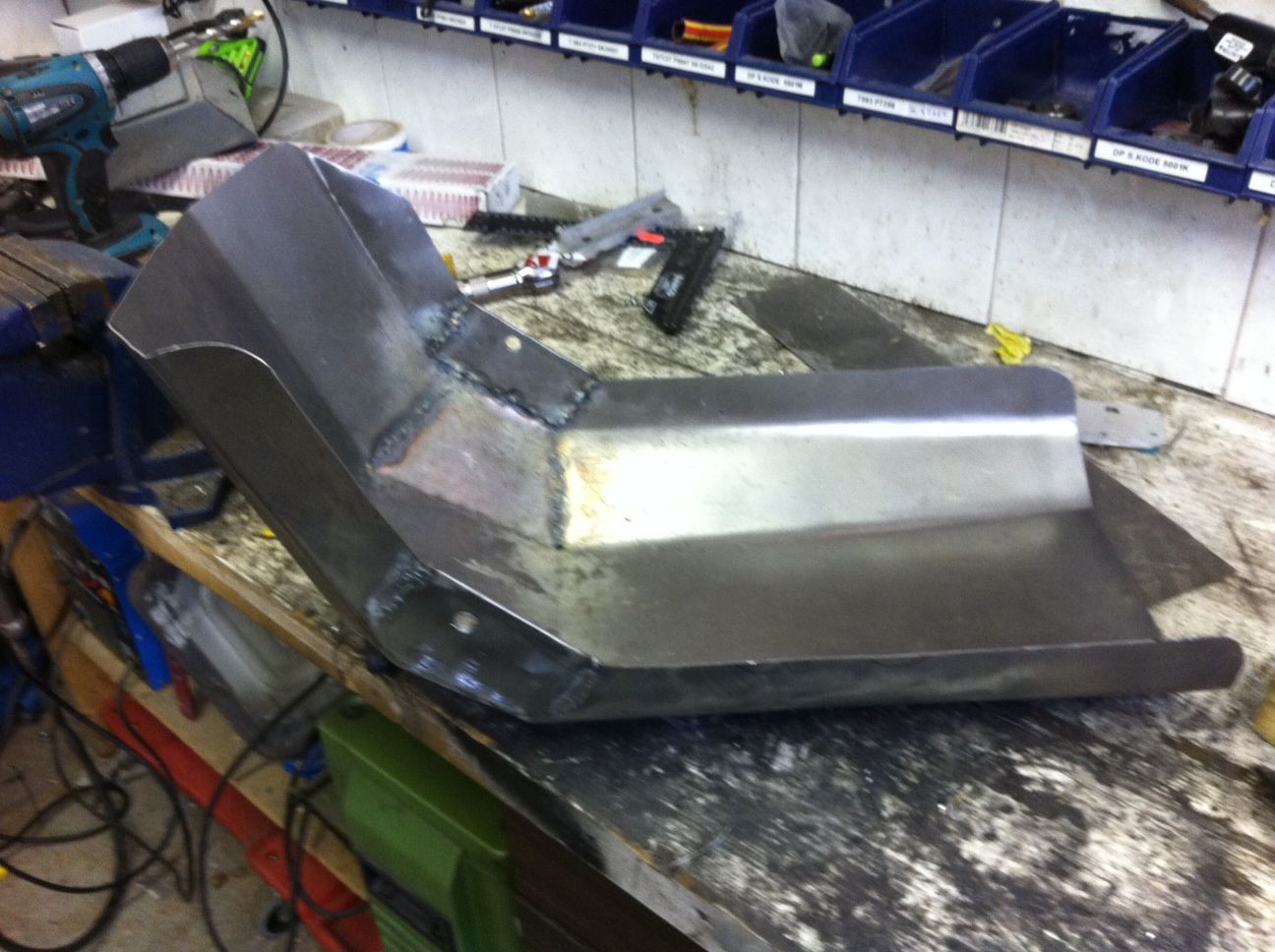

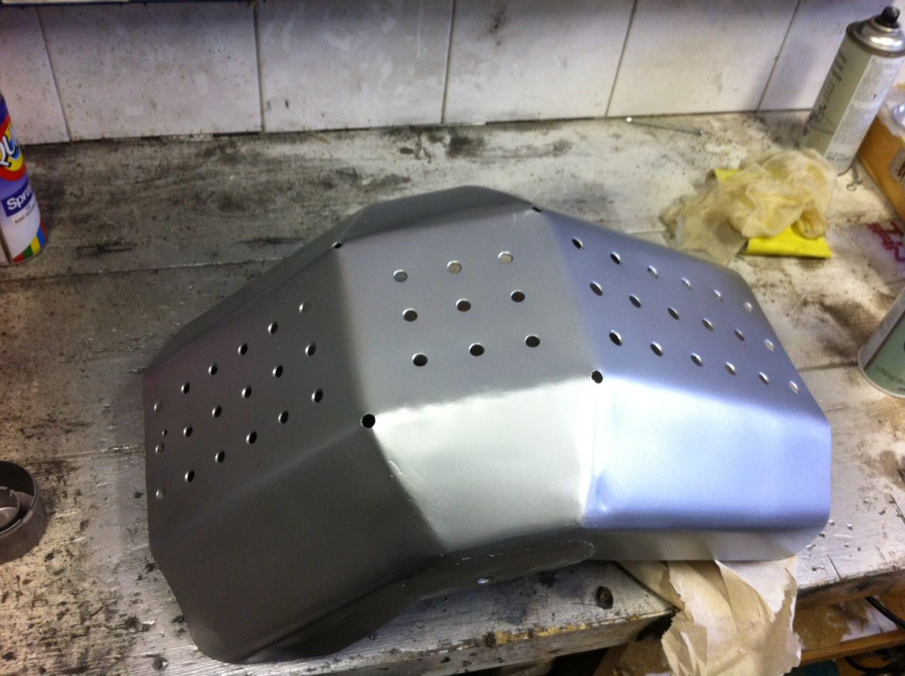

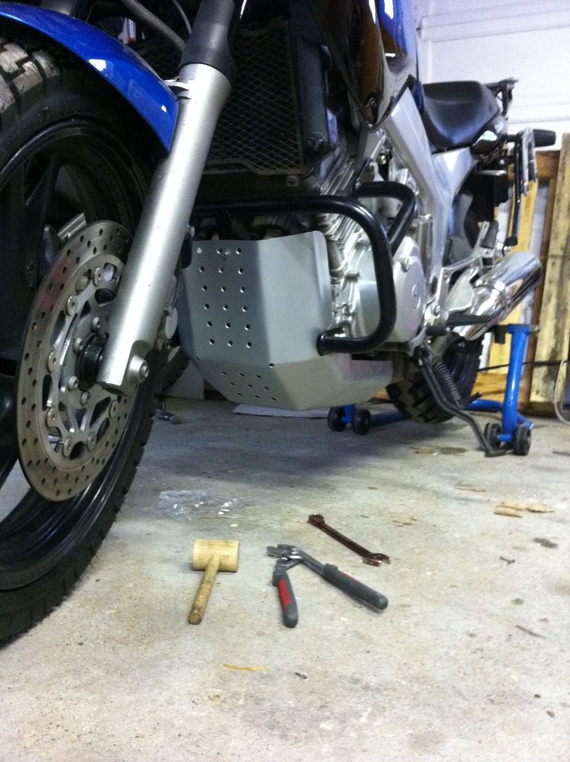

I didnt have alu, so I used 1.2mm steel to make a stoneguard for my 850, as noone sells anything proper.
Ive put on xtz1200 handguards, new wheel bearings, Wirth springs and Renntec-copy..

Nice craftsmanship
Maybe you should have it hot dipped galvanized. With a bashplate this size your biggest enemy is corrosion.

Looks like it's in stainless already - excellent work Ozzy - you could sell those if you set up a production line good.gif

Have you got a templete or layout for this bashplate?

very nice what tyres do you have ?

really loike that Ozzy, well done. Do you need to remove the engine bars to remove the bash guard to do an oil/filter change ??

I have made a template at work so will see how well it work and then i will post it up for you all if its anygood
pm me if your interested and I will look into costs. of making some and selling them

Looks good, but do you really need that much weight of metal up front which will effect the engine block cooling, when a plastic fender extender/mud flap will protect the front of the engine?

My prototype is allmost done

Any pics?
