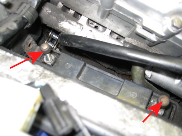

For charging and measuring, these wires connect directly to the battery:

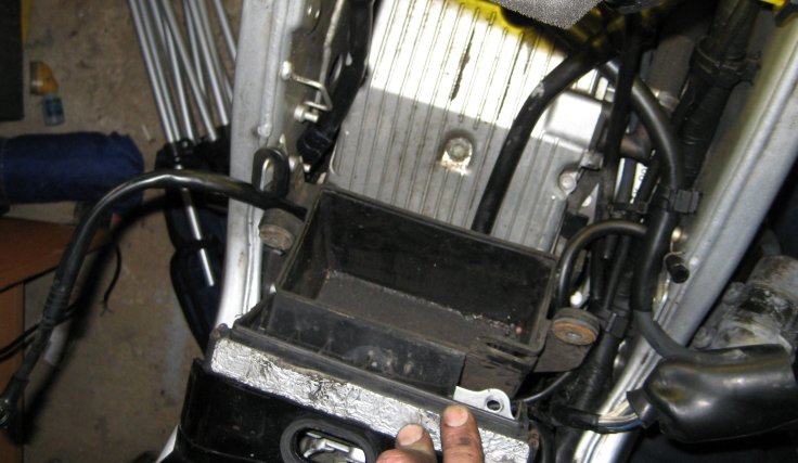

QUOTE(dandywarhol @ Fri 13th Jun 2008, 02:28 PM) <{POST_SNAPBACK}>
Hi Pa
Battery is fiddly but you don't need the back wheel out! You unbolt the battery cage and lift it up from under the seat - done 2 that way.
Just done that on my '01 MK22a, here's the empty battery holder:
I removed seat, tank, airbox (probably not needed but doing headstock as well at the moment), disconnected all cables in this area (good opportunity to give it all a nice squirt or WD40) and unbolted the battery holder. A little tip: the holder-bolts nicely fit the connectors which make great handles (like in "four candles") to lift the battery out:
It still seems like a needlessly depressing job but that's Japanese bikes for you tongue.gif .
I just ordered a new WestCo battery for £39 + P&P from 2ndbite.com. Probably not quite as good as Yuasa but supposed to be OK and £20 cheaper (I don't intend to keep the TDM much longer anyway). Anyone else ever tried WestCo?

Battery box will come the side of the rear shock - just removed RHS footrest hanger and rear master cylinder, and it'll slide out nice an' easy
