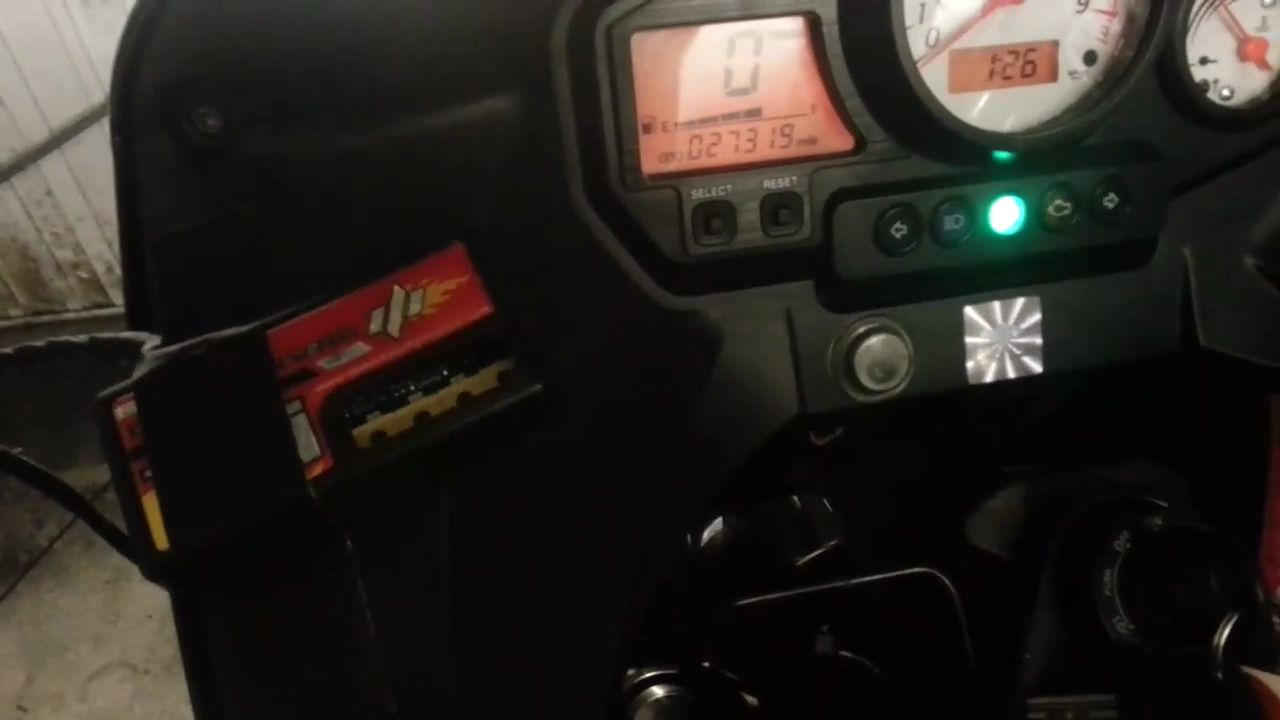

Well thanks to AzzA's excellent instructions I have managed to install the Dobeck TFI in less than 30 mins. Tuning the box was a bit of a faff at first but I think I have it close, but a test ride is needed to finalize that wont get that opportunity until Monday at the earliest .
I have attached a pictuce of the setting I have prelimanarly got do they look right to those that have fitted the TFI.
Also took a small video of the LEDs on the Dobeck
Edited by TDMTAM, 05 January 2013 - 10:34 pm.
#125 AzzA
AzzA
  • 1,548 posts
Posted 06 January 2013 - 02:33 am
G'day TAM,
Looks like you've done everything the correct way; Dobeck say you should be able to tune between 2&4 o'clock, and it looks like you've got just shy of 3... which is about where mine is.

#127 TDMTAM
Posted 07 January 2013 - 01:50 pm
Update on my Dobeck TFI install.
I had chance today on the commute to work to try the Dobeck TFI out. At first I did not really notice anything new but I start my commute on a twisty A road.
However the moment I got into traffic and negotiated a couple of round-abouts that is were I did start to notice the improvement. Almost gone is the On-Off-On snatchy throttle, there is now a nice almost smooth usable power from 1800 rpm, 14mph in 2nd gear or 18mph in 3rd gear, right the way through the rev range. I can also hold a steady throttle between 2500 and 3500rpm without it hunting like it used to.
I still think my setting need a small tweak as I think I am now a tad rich on the Green section, but a great start so far.
