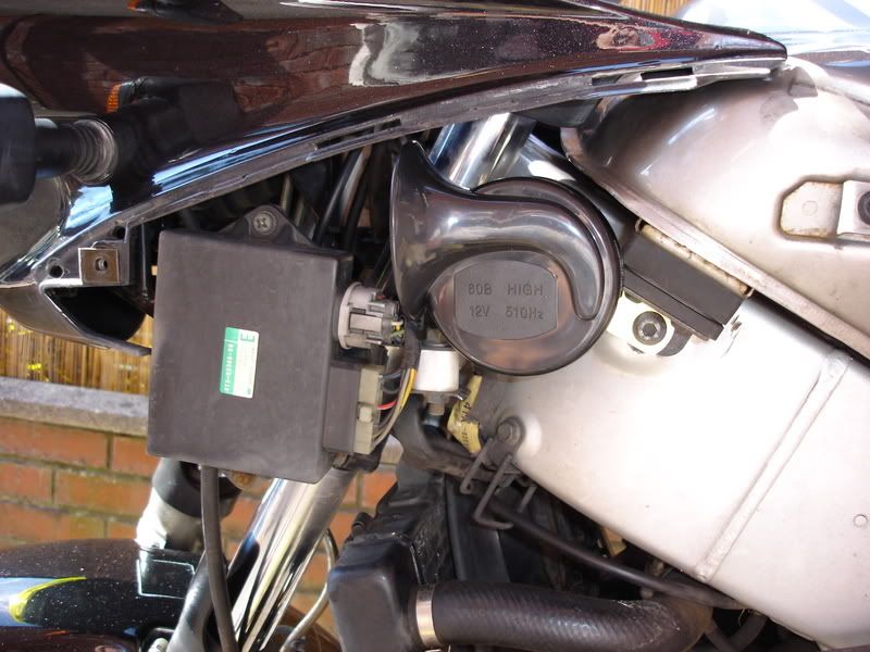

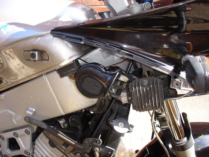

QUOTE(danceswithmopeds @ Sun 15th Jul 2007, 05:30 PM) <{POST_SNAPBACK}>
At last a dry day, warm,sunny,and I'm not on call. Extended wires to reach down to Stebel. Short strip of stainless used as a bracket. I'll probably re-position it next week.
Loobman fitted in out of the way. I can't really reach it while riding, so it will probably move as also. Well you gotta have a hobby.
Ran a cable under the tank to fit a pair of Ring fog-lights under headlights. Have to make 2 brackets first. Bit awkward fitting them so they don't interfere with anything else.
Sorry to hijack you r thread, but I use Fiamm Horns (130dB - so they are LOUD)
They mount up just great underneath the fairing, out of harms ways, out of sight, out of mind until you press the magic button, then all hell breaks loose yahoo.gif

QUOTE(GuyGraham @ Mon 16th Jul 2007, 07:03 PM) <{POST_SNAPBACK}>
I have just fitted similar horns, Motrax Hootaz again 130dB, fit just under side fairings.

Posted 21 April 2014 - 08:26 pm
Hi,
i'm planning to fit Fiamm horns - i've no real electrical ability - could you outline what's involved wiring-wise please, rgds, Pete
