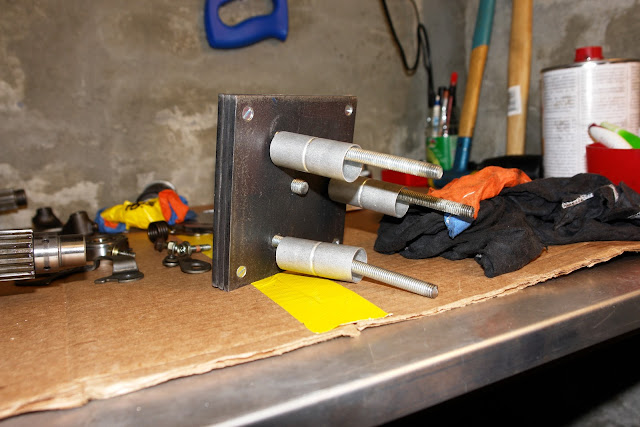

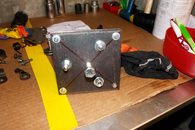

i build something like that during mine engine rebuild!
it was really nerve braking procedure since i managed to brake 3 VW golf head fastening bolts
in the end I changed the diameter of the central from M12 to M20 which delivered lovely result with a laud bang!
also some heat had to be applied
p.s. I used 3 pieces of 4 mm steel plate and to make one laminated base for the puller
any way u'll need to apply some heat either using heat gun or torch
p.s. I also welded one steel bar to be used like a handle because it has tendency to spin with the rotor tongue.gif
Edited by danbara, 09 December 2010 - 01:02 pm.

now when u start pulling that rotor off dont take that bolt out but just unscrew it for 2-3 times ( 2-3 mm)
what i did is that i also drill a small 6 mm hole on the bolt head ( actually just scratch the surface) so that the puller has better and more even support
anyway it is nice job and the resulting sound is really nice ( kaboom like some gun went of)
