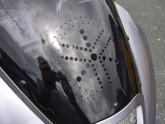

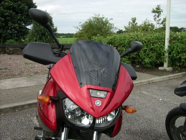

I tried the holes in my flip up screen an have had great success in reducing the turbulance, So...
I had the bright idea of doing the hole trick on the standard screen.
That works a treat, much better ......

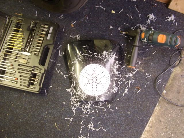

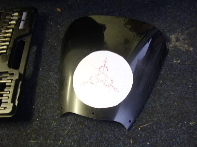

Holes are on a word document attached.
I changed the holes slightly , you can see them in the picture as red.
(first time I have done this so fingers crossed.)
I just printed it off, cut it smaller, stuck in on with some paste, and drilled it carefully.
Good Luck.

#33 Geordie Guy
Posted 05 September 2009 - 06:09 am
QUOTE(norty @ Thu 3rd Sep 2009, 11:30 PM) <{POST_SNAPBACK}>
In your opinion does it make a lot of difference?
Yep, its up to personal prefferance. buy Im happy with thr reasults good.gif

No the inner ones are bigger. I think I used a 3.5mm and a 2.5mm for the outer rings.
On the pattern on the word document, I followed the same size as shown. I did that on the skidmarx touring screen, with brilliant results, aswel.
Screen seems fine obviously there will be some comprmise in strength but I cant tell the difference.
