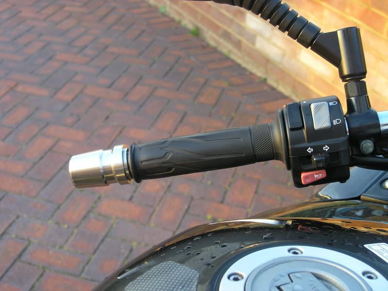

Different bars or bar-end weights may help. I still have standard bars, but in an early effort against turbulence I picked up a couple of stainless steel TRX 850 ends which are heavier than the 900 stock ones and seemed to help, so you may like to consider that. They are each about 1cm longer than stock, though, which I don't mind, but some may object to the "wrangler" look

Not having a vibes problem, but I did fit heavier S/S bar ends (Oberon, marked for a TRX) early on, so maybe they helped?
