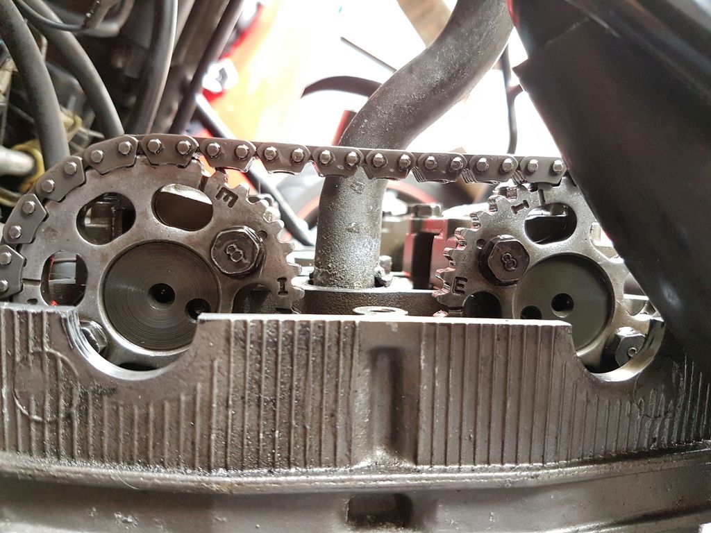

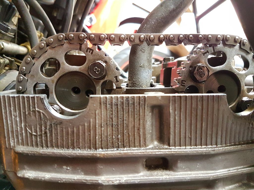

Ok..problem solved! Tyredngrumpee's post was right but it's clearly easy to get confused with what's in the manual and reality...
This pic shows the timing at the start..
This pic shows my adjustment...
Needles to say the timing is now back as per the first picture and problem gone.
