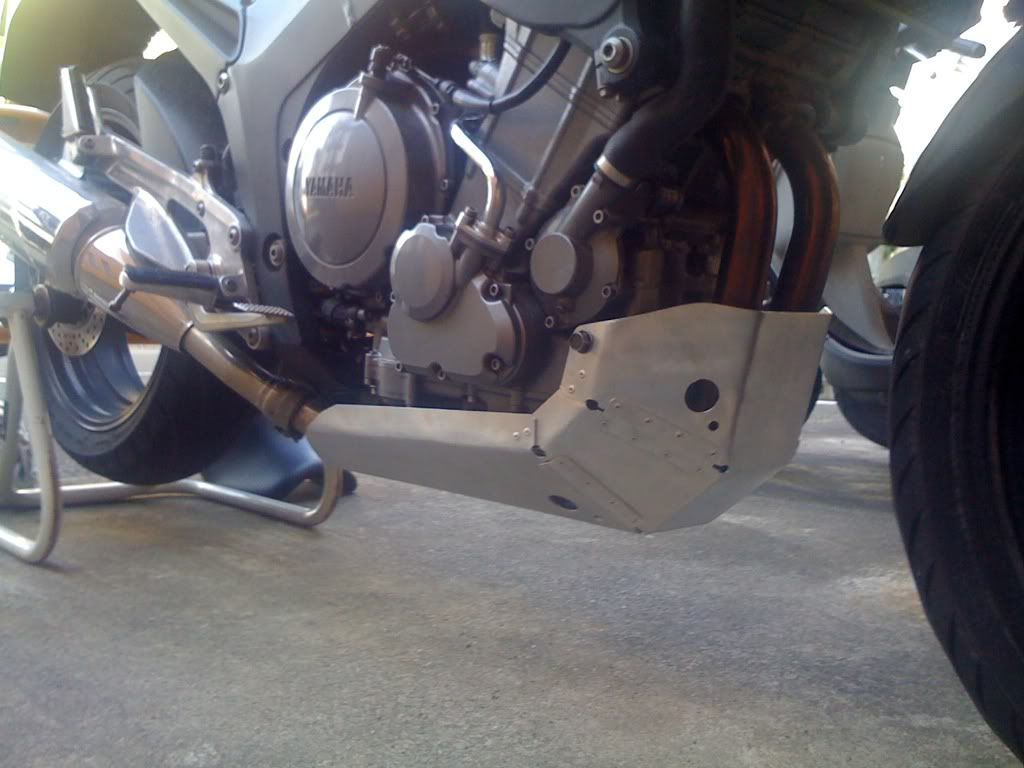

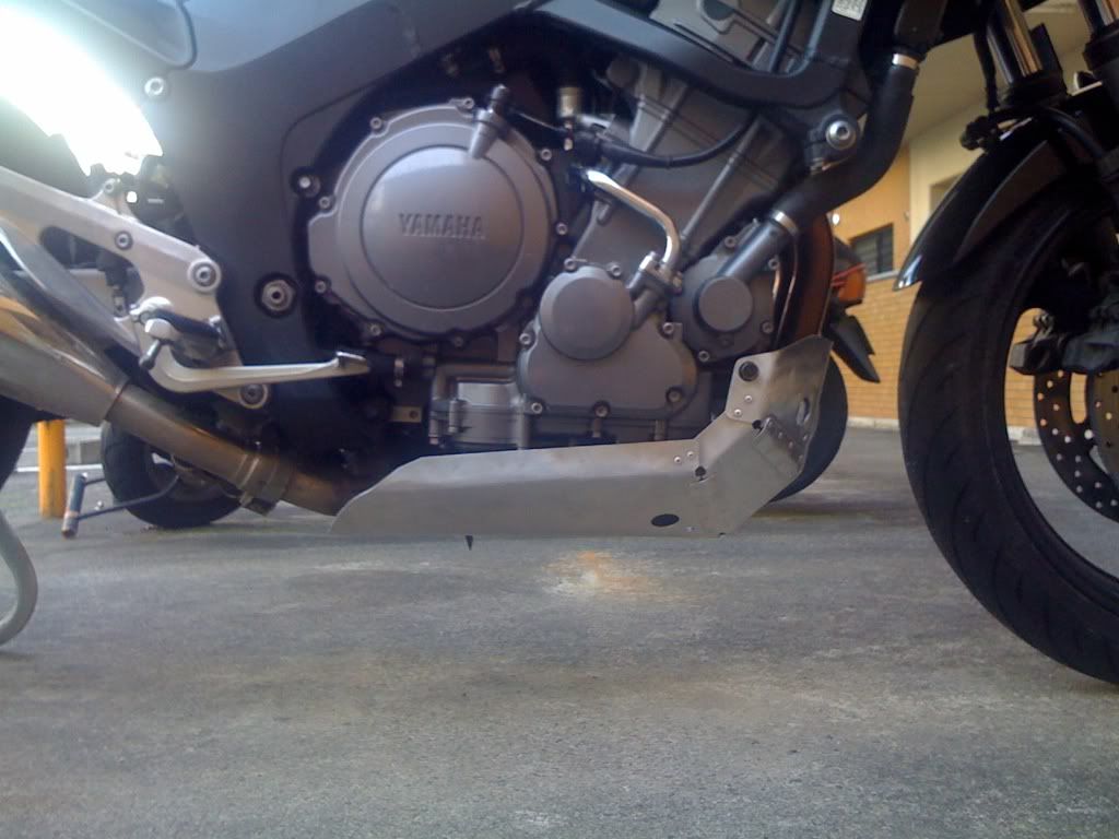

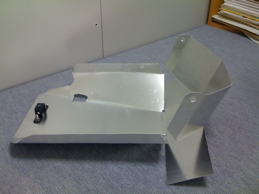

Made this in 10 hours, 60x40cm, 2mm aluminium.
Going to post more photos and some measurements next time I take it off.

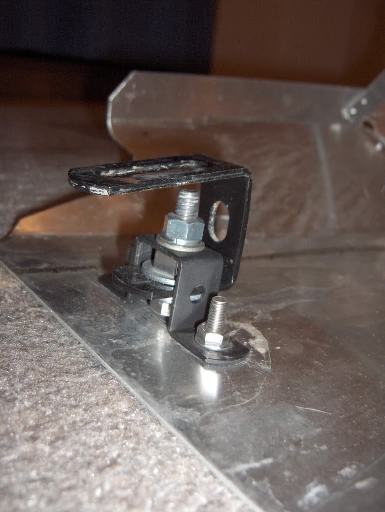

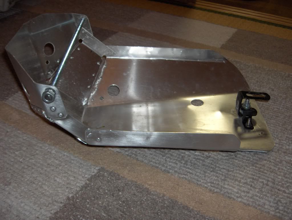

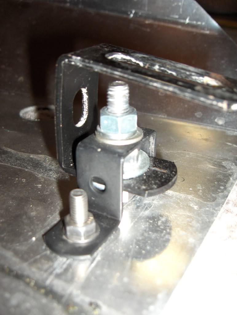

Look at one of the first photos. I just fitted a u-shaped brace in the screw holding the muffler, and it connects to this black brace in the back of the plate. So when I hit something, it just flexes, not braking the exhaust or the plate.

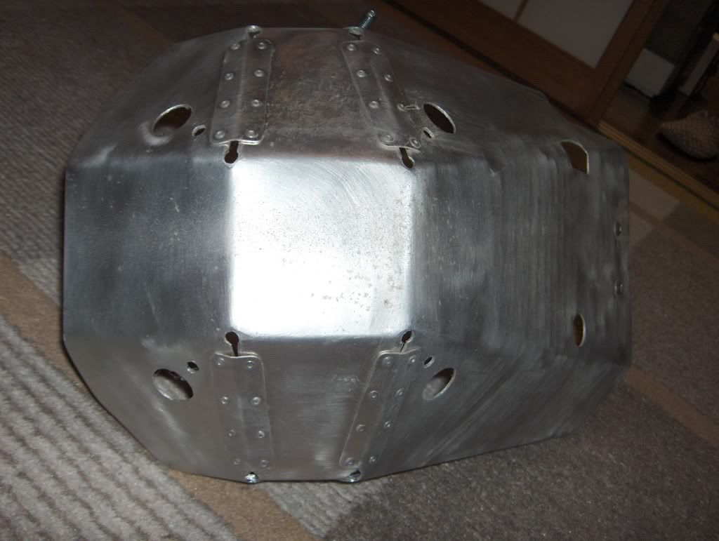

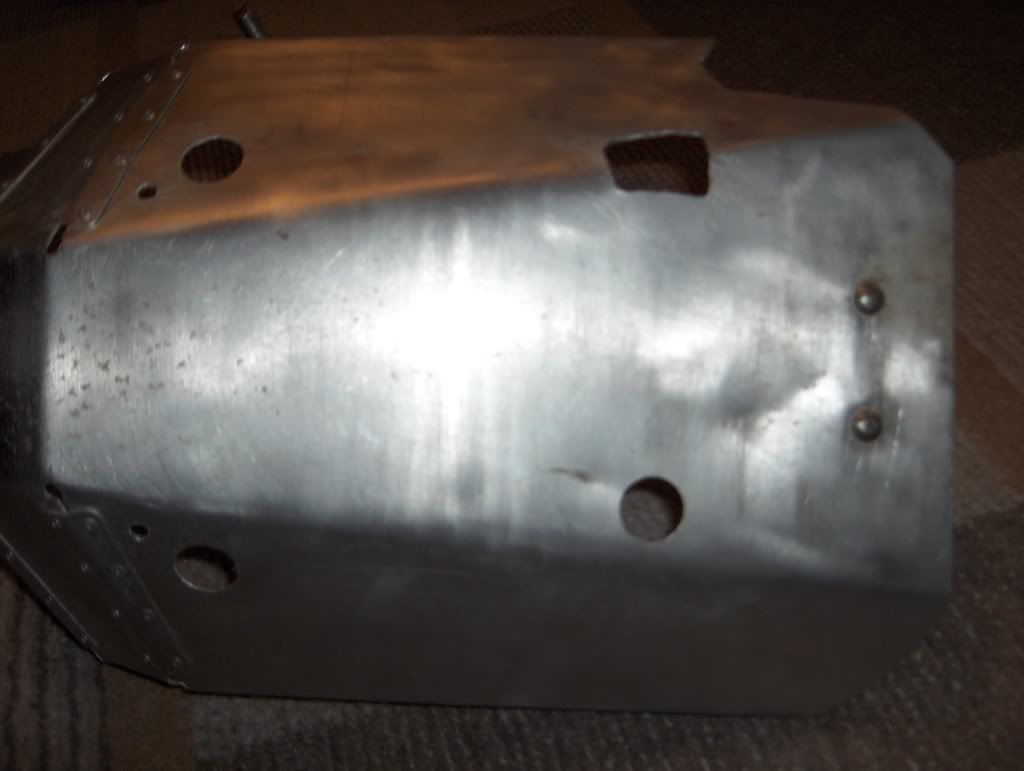

Posted 23 January 2011 - 12:34 pm

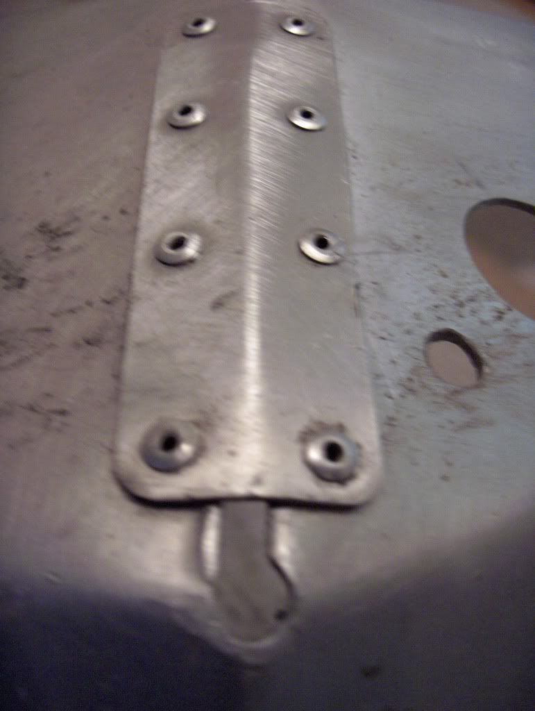

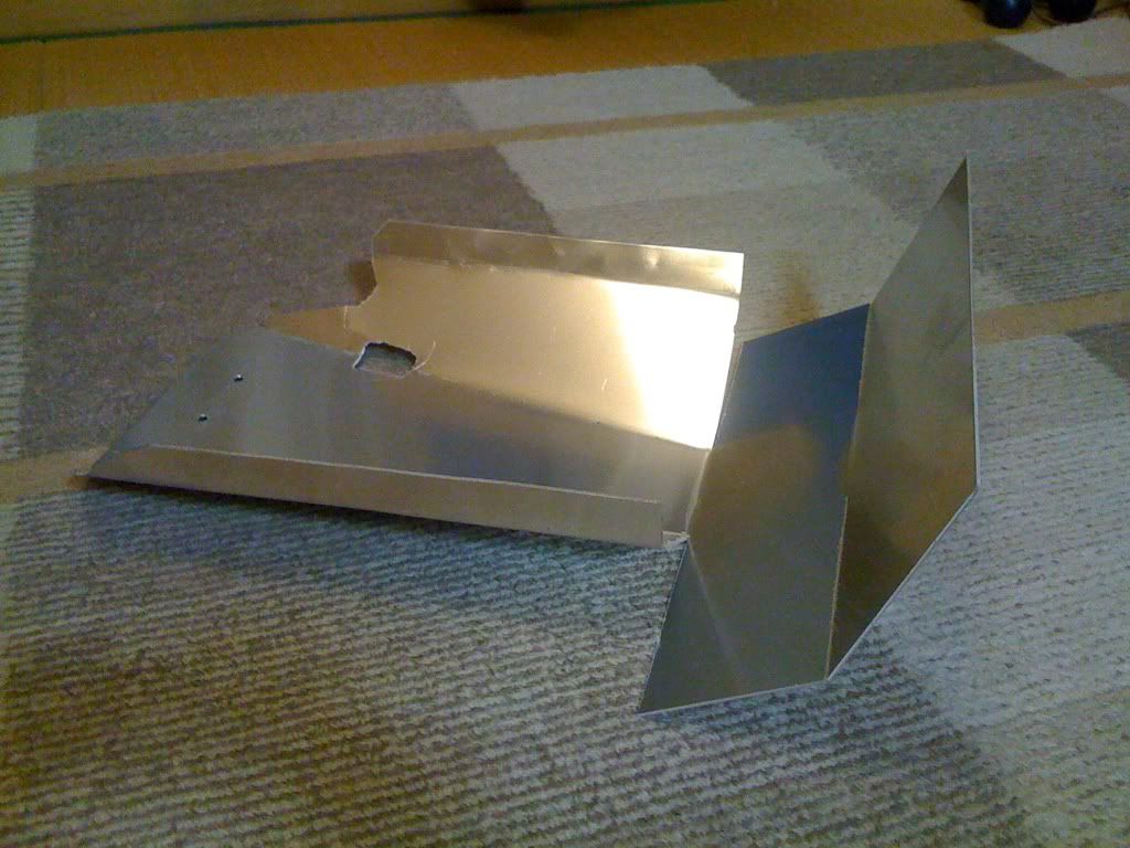

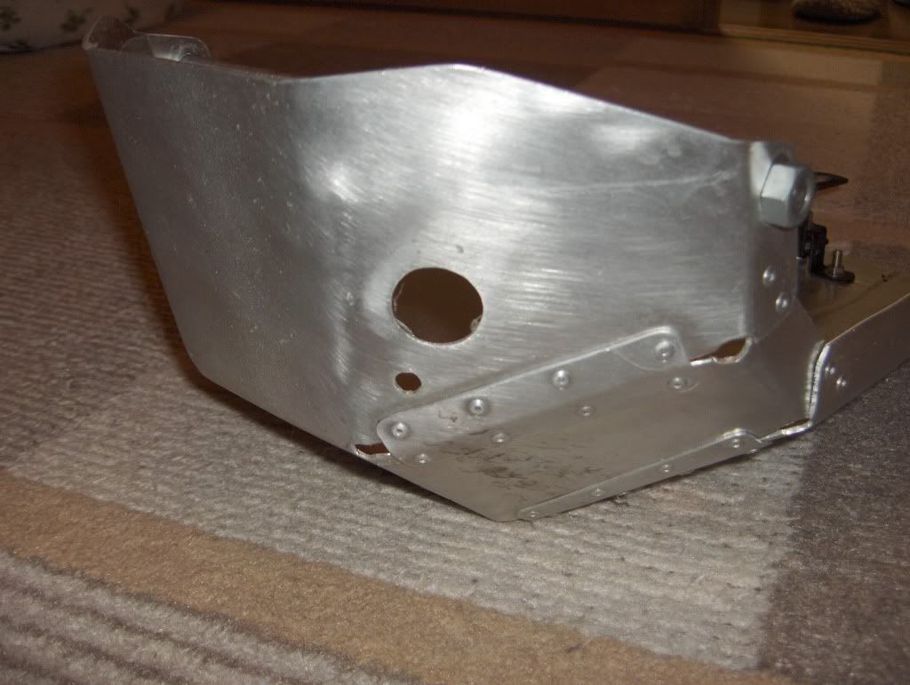

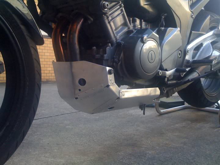

Some more photos

QUOTE(dablik @ Sun 23rd Jan 2011, 09:42 PM) <{POST_SNAPBACK}>
Well done Kyoto,, what a great piece of DIY,, do you intend to paint the bash plate or will you leave as is tup.gif
Well, I think I'm gonna do some bashing, so I will just leave it. I will also move the rear mount one centimeter forward. As it is now, it's in conflict with the bolt to the exhaust.
