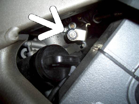

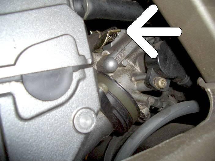

Just in case anyone else has had the same trouble as me with the cold start seizing, here's some info for this time of year.
There's a spring loaded brass bar by the injectors. When the bike's cold the bar is fully to the right (i.e. in the cold start position). After the engine is started and the temperature begins to rise, a wax element inside the coldstart mechanism expands and gradually moves the brass bar across to the left. If you give it a push here (see RHS view) while the engine is running the revs should drop as it moves in. Its full movement when cold should be around 20mm.
The brass bar can seize in its mount, the effect being that starting from cold in the winter may be difficult. All you need to do is spray with WD40 or light oil after cleaning to keep it mobile. (Grease may be too heavy to allow it to operate freely?) If yours has seized (like mine was) spray the area with penetrating oil and push - or in my case give it a gentle tap from the left hand side (see LHS view) with a piece of wood propelled by a hammer. If its moving OK and the cold start still does not operate I have heard that the wax element can fail - but that's another story.
RHS view
LHS View

Good one. Had exactly that problem on my 900 and fixed it by the same method.

Have had the same problem on my 900 on a few occasions. Need to find a more permanent cure, as WD40 only works for a short while. It seems to be worse now I don't use the bike as often.

I thought I'd posted this solution yonks ago? I know somebody contacted me last year for a more detailed discription which I sent to them. It needs repeating though especially at this time of year so nice one Minty.
Without changing the whole choke system the way to recitfy it is to lift the fuel tank, remove the air filter - so you can see the whole set up. Then clean all the crude from around it and grease the the two sliding arms. Then a good squirt of WD40 all around. Yamaha told me that you should use a graphite type WD40 spray. They are aware of this problem but as always they do bugger all about it. Now how many years has it taken for them to get to the bottom of the idle problem? Must have mentioned it every service for the past 3 years!
Don't forget to add this malarky to your list of maintenance chores on the TDM!!!!!
