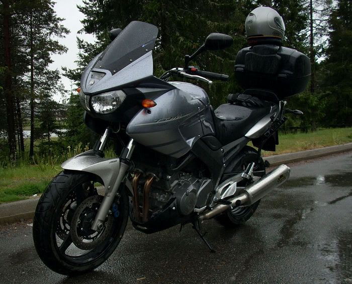

My new SECDEM double bubble arrived a few days ago. It looks good and it's the best screen I've tried so far!
A lot less buffeting, almost nothing, and it keeps most of the wind under control, to put it that way...
Check photo below...:
