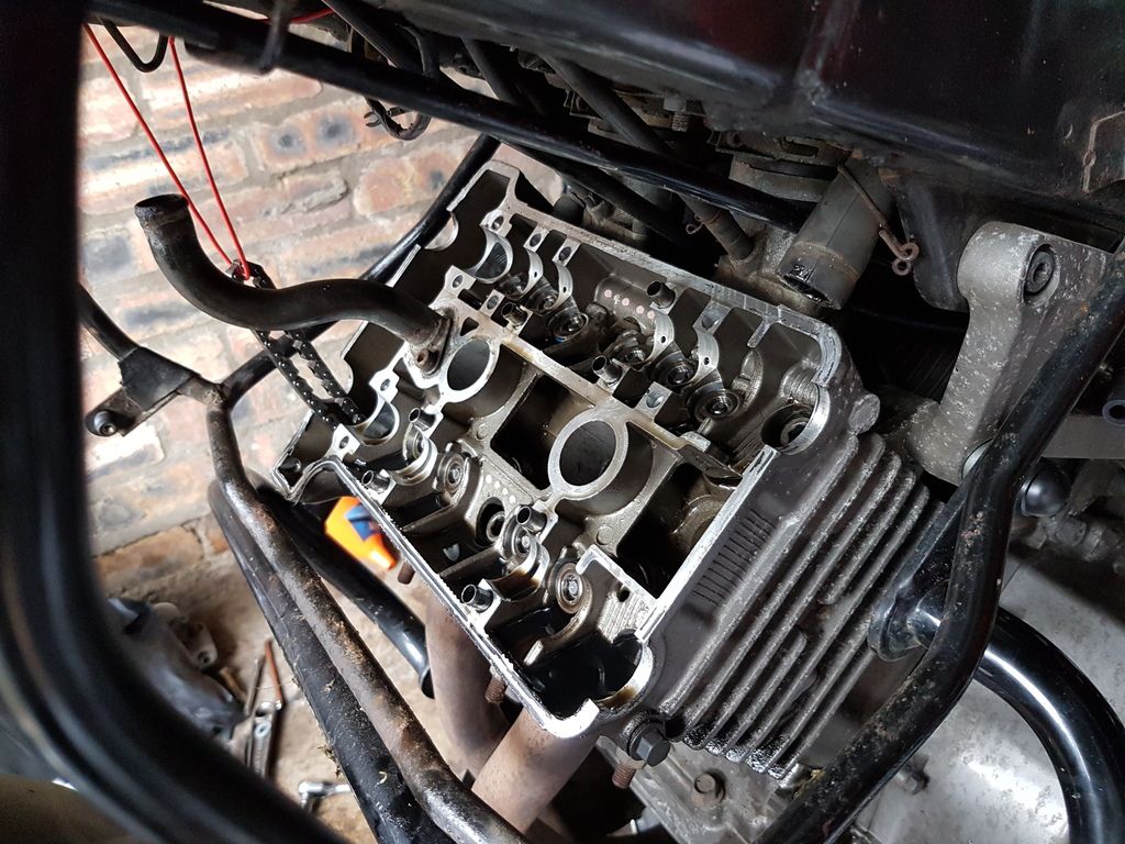

Stripped the mk1 head and finally found a use for that old parts box

You should get that crankshaft journal checked for roundness as well.
#2000 Studley Ramrod
Posted 11 July 2016 - 01:48 pm
Also worth fitting new valve stem seals. :)
