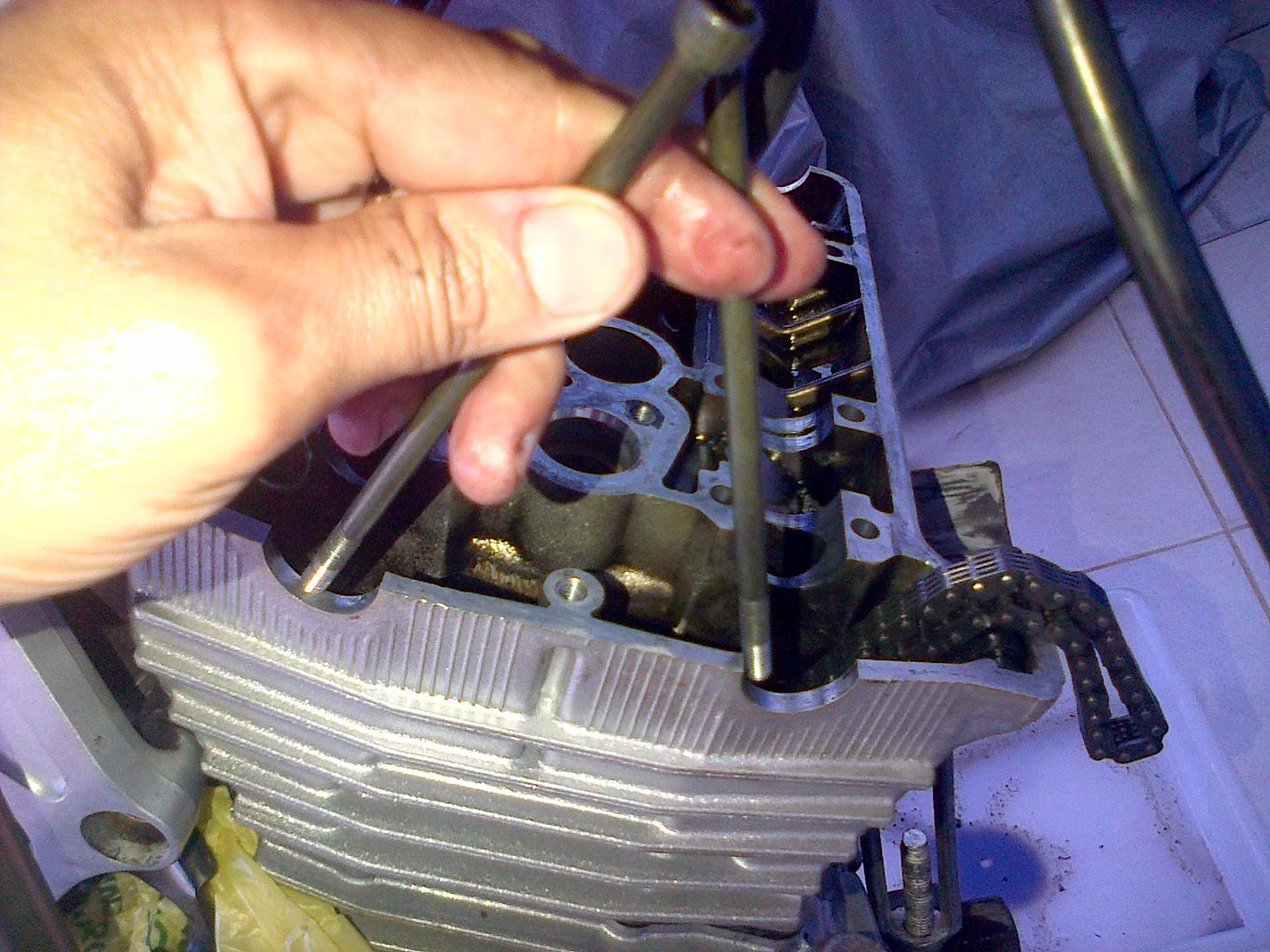

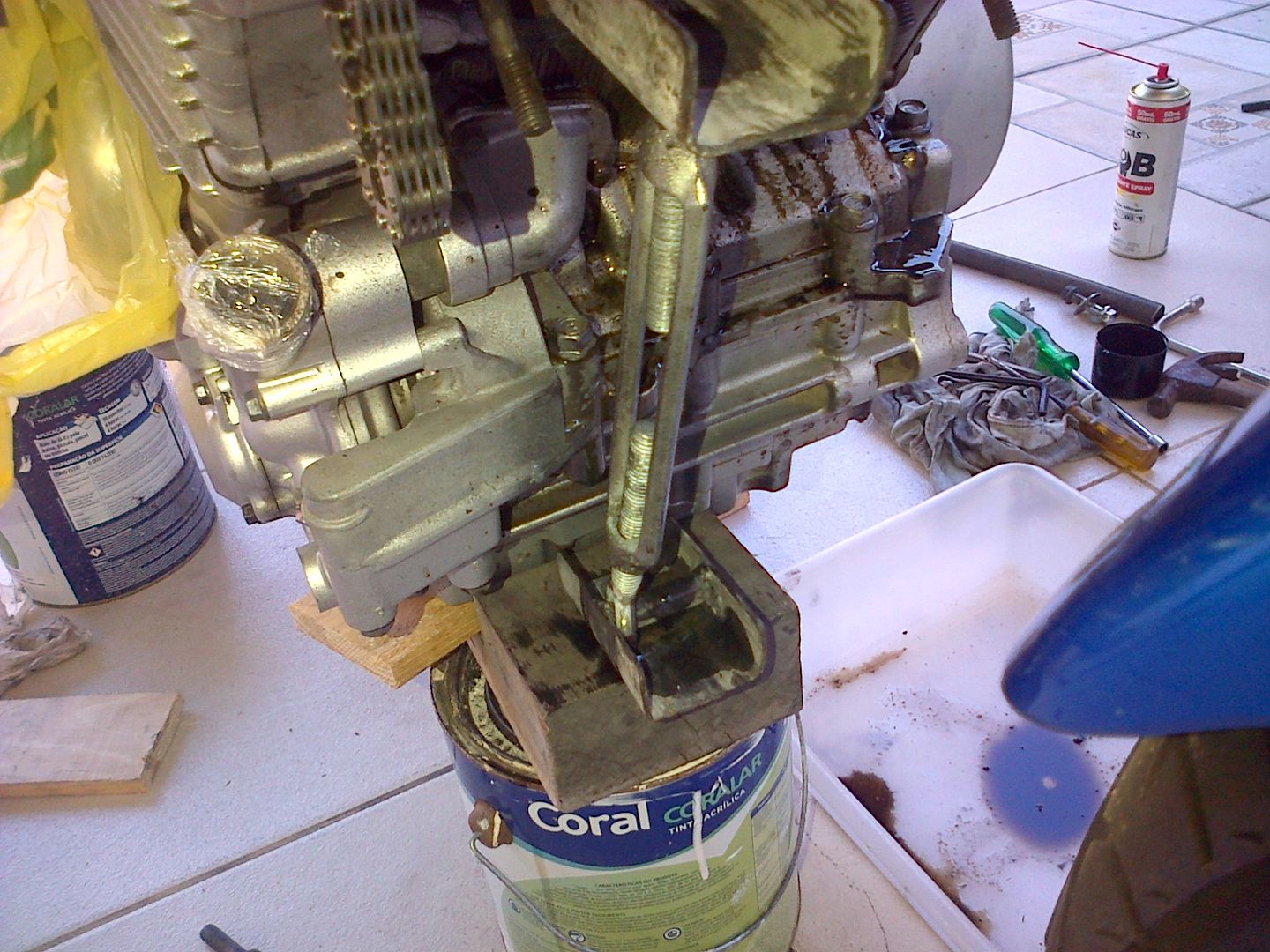

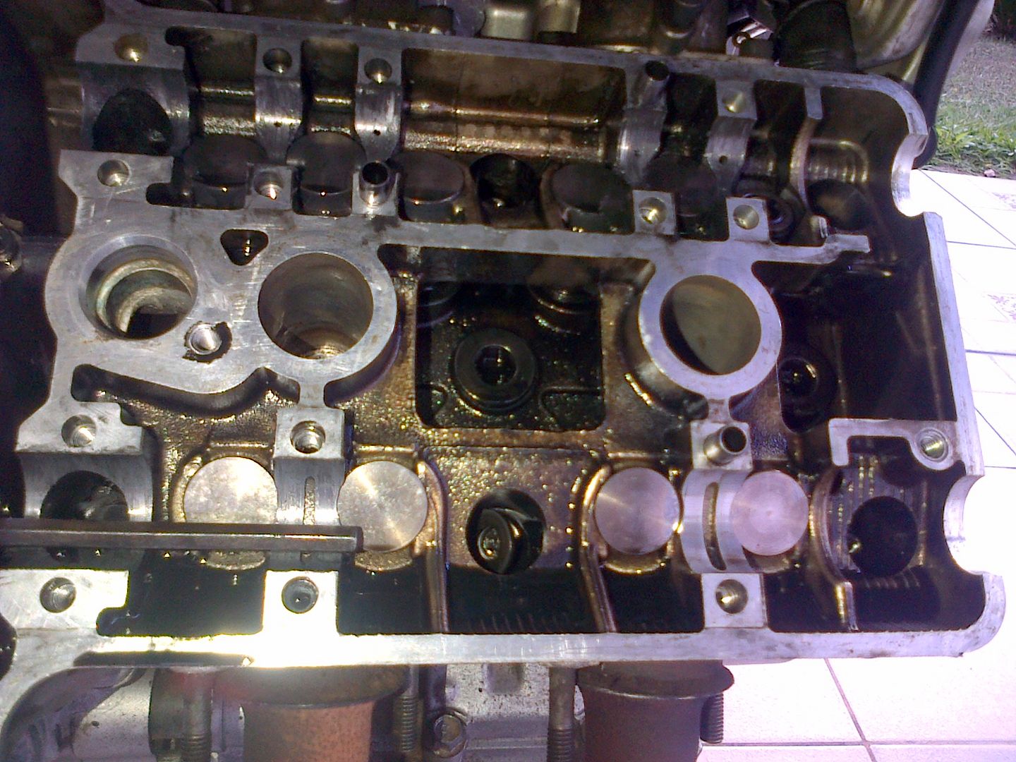

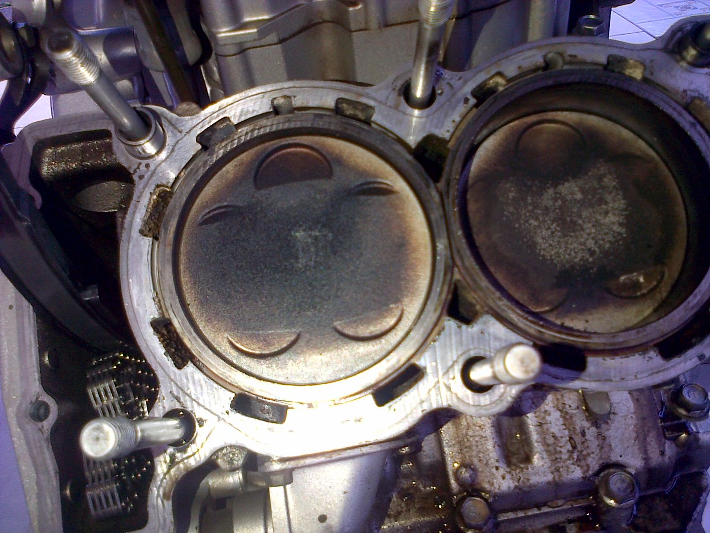

Hi to all!
I spent Sunday like this:
  removed
full interprise (without separating) and flanges left very easy.
fuel tank, carburetors, intake manifolds.
I had already removed the head cover and the 6 nuts holding the head to the cylinder.
Today after some time, I found the two long screws (allen), which are close to the chain of command.
The head took a bit to get out and I had to use a cable tensioner to push it. Fast and without problems
I had no problems with any screw. All they left without eventualities.
Tomorrow after work, I clean the parts. Yet this week will bring the head to assessment by a professional grinding. The laps of intake side were marked and  generated fine swarf. The lubrication holes were restricted.
I am optimistic. But I am also realistic, we will await the opinion of the professional.
http://i1067.photobu...zps5cy1kasp.jpg
http://i1067.photobu...zpsbqijlat2.jpg
http://i1067.photobu...zpsp0shpcam.jpg
http://i1067.photobu...zps7zqe1eou.jpg
Cheers!
Edited by Sidarta, 05 September 2016 - 12:39 am.
Att
Sidarta
TDM850 ano 2001
 Honda XLX 250 1988
Honda Tornado 2005 - Honda CB400 1982
Honda CB350 1972 e 1973
#2197 fixitsan
  • 4,855 posts
Posted 05 September 2016 - 08:07 am
Sid, it looks good on the pistons. No wet oil.
