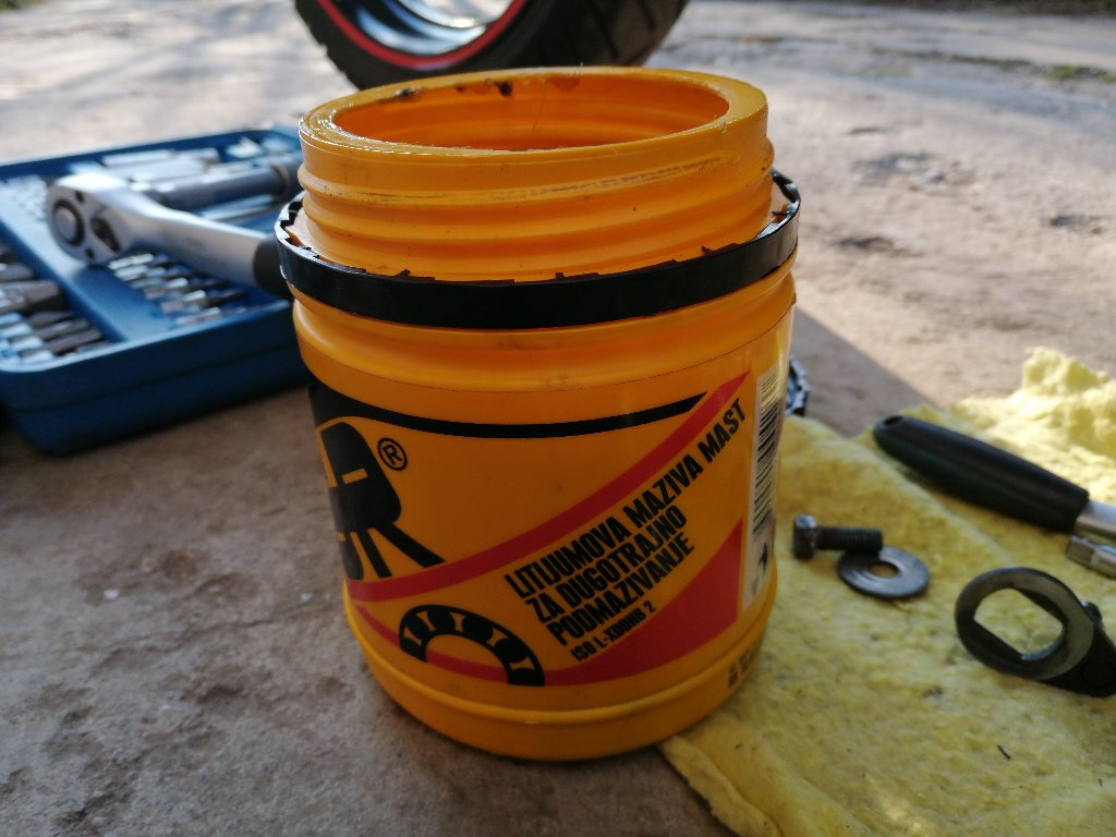

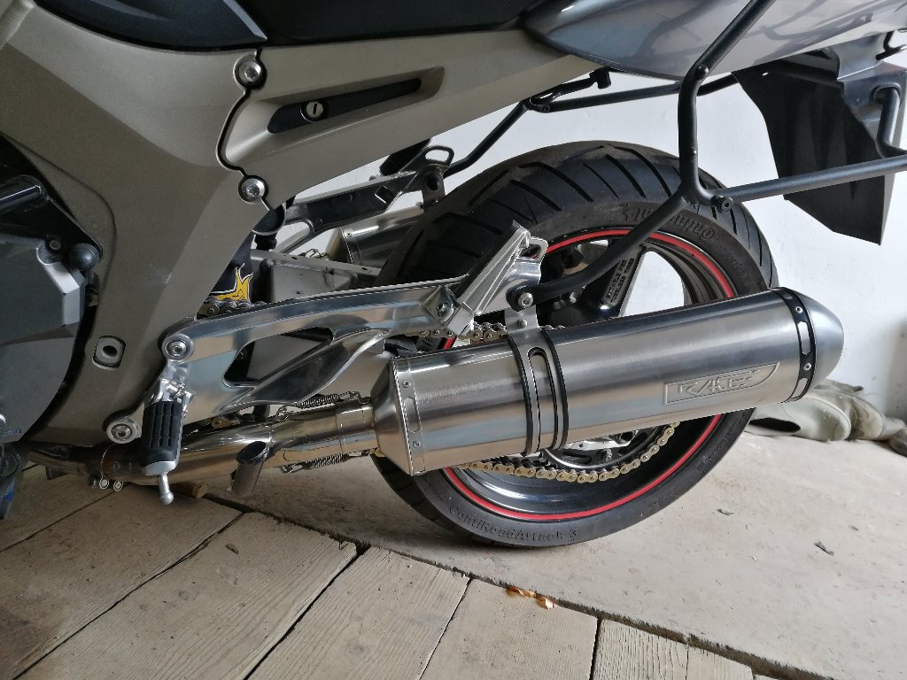

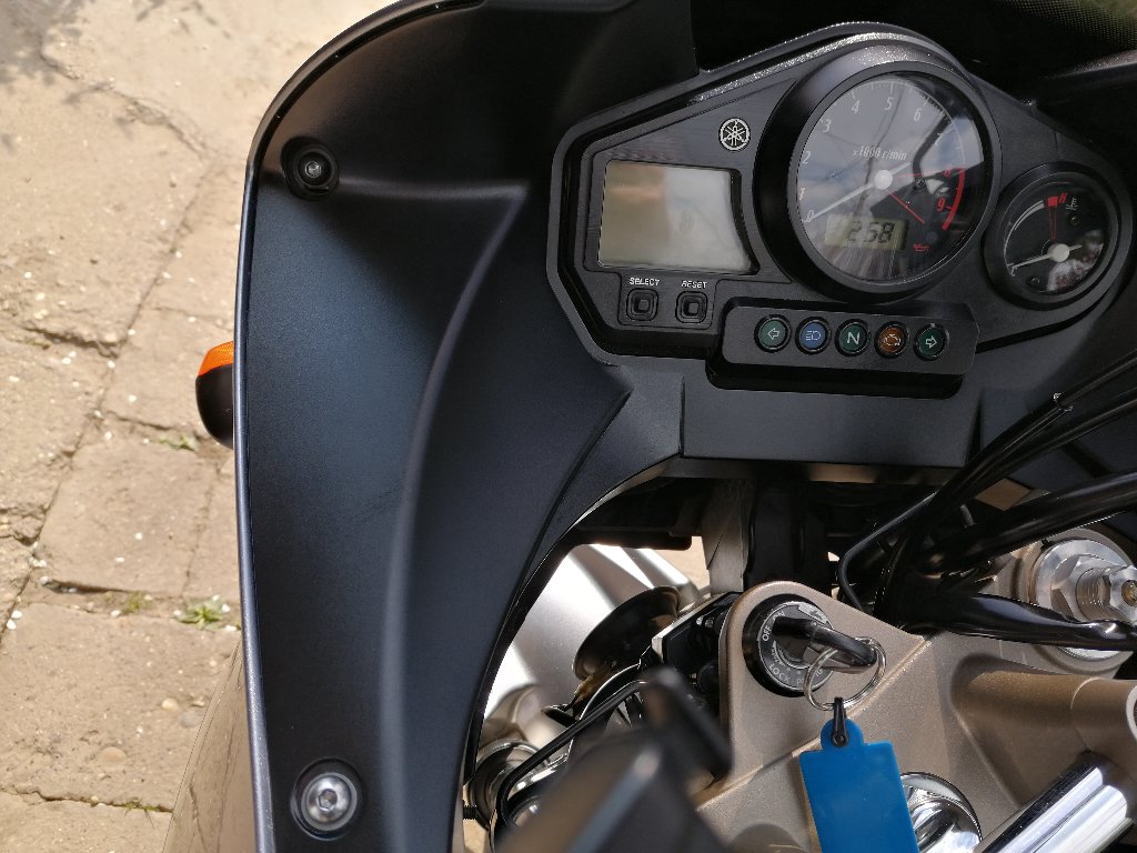

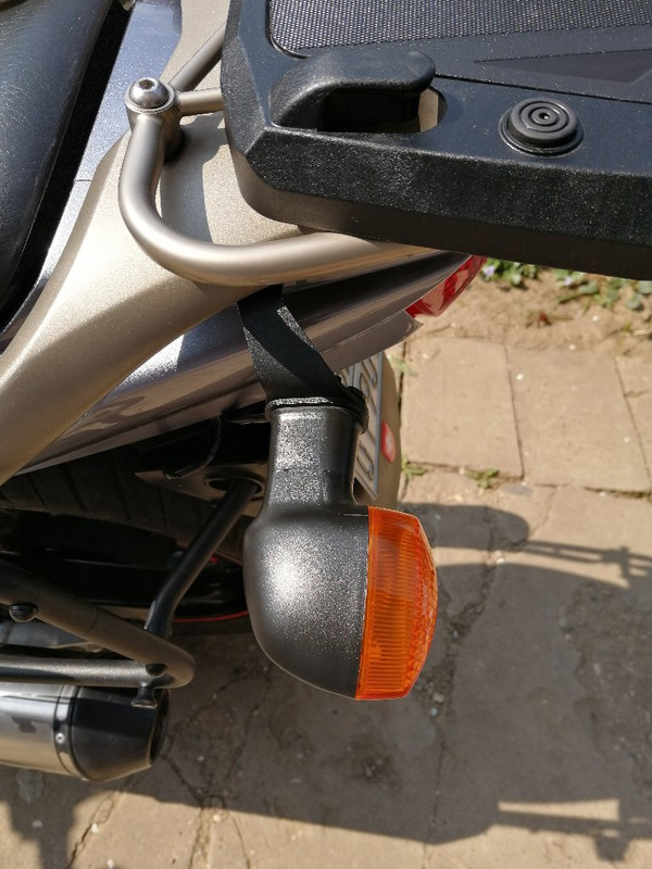

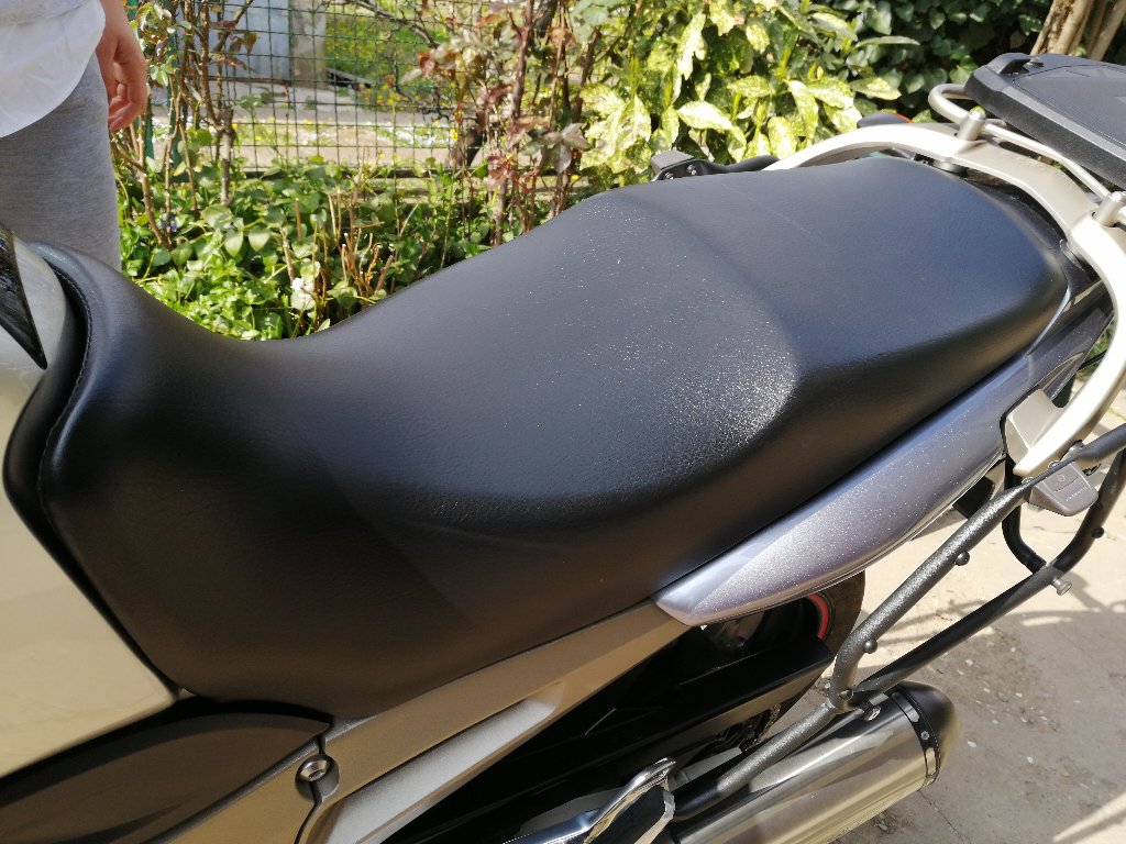

New riding season require prepared motorcycle. Nothing wrong with TDM, but it need attention in order not be ashamed in company with new bikes.
Lets clean this and polish:
Done!

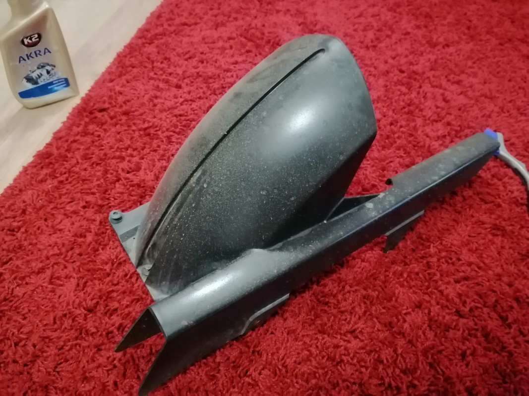

Hugger in unacceptable condition.
Seems better.

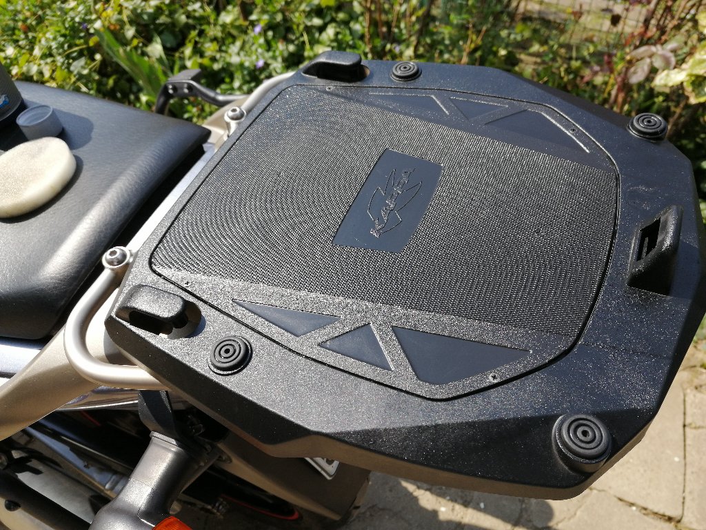

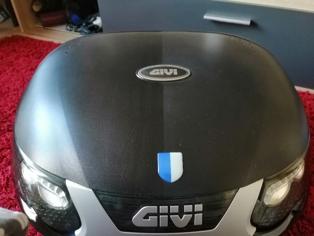

Luggage need some care to. See the difference?
Those hard to reach areas are free now therefore are cleaned.

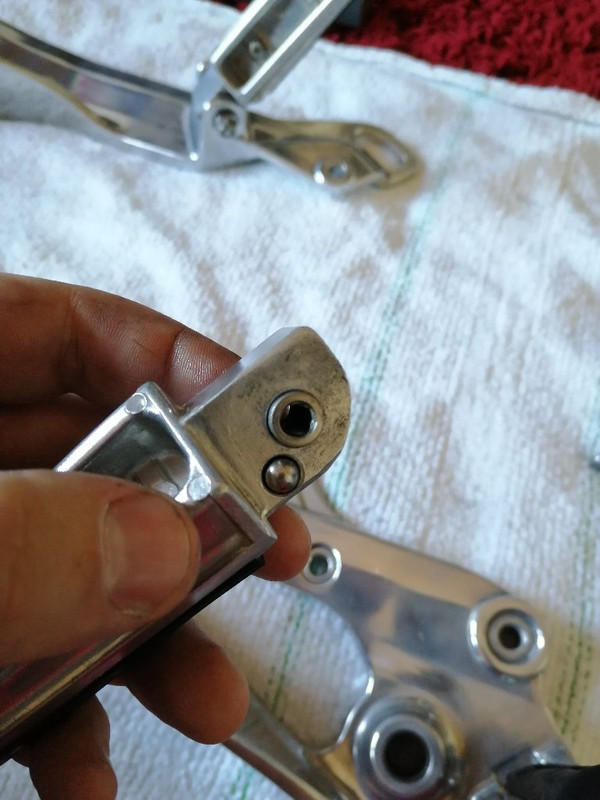

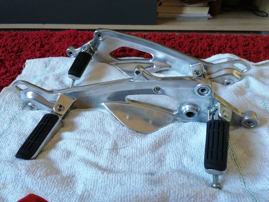

This is polished by my friend. He did good job. It always amazes me how quality components TDM have. U wont find this big, polished, cast aluminium parts on new bikes.
Do u hate when u touch something on bike and that doesnt feel right? Scratching, jamming? Must be cleaned!
There!

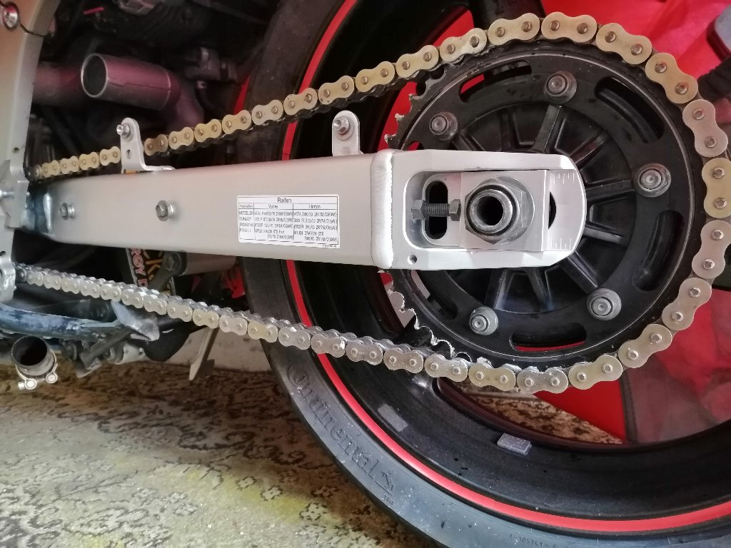

Lube with lithium grease.
Assemble.

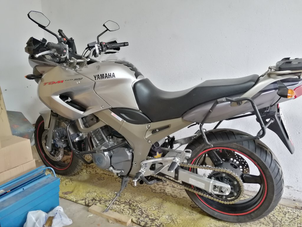

Now to garage.

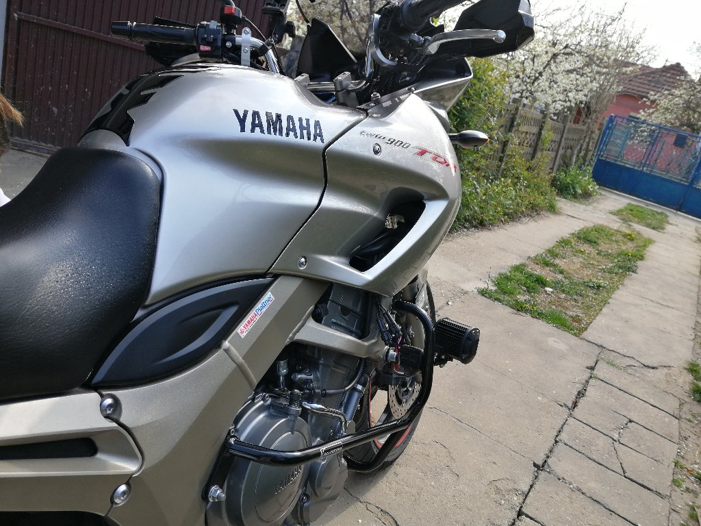

Loos awesome. Cries for supersprox sprocket and titanium nuts. Will be at some point.
Dog is there also to check all. Its very dangerous and aggressive. Chops people.

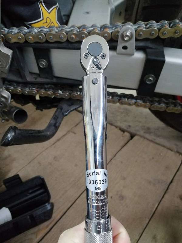

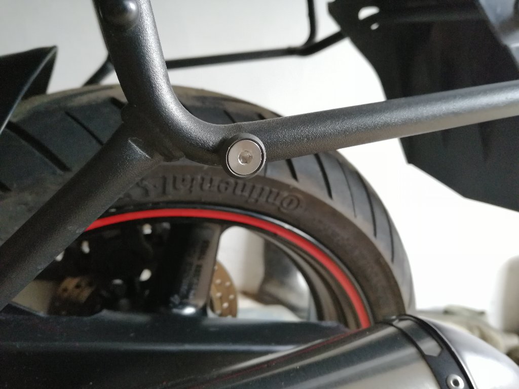

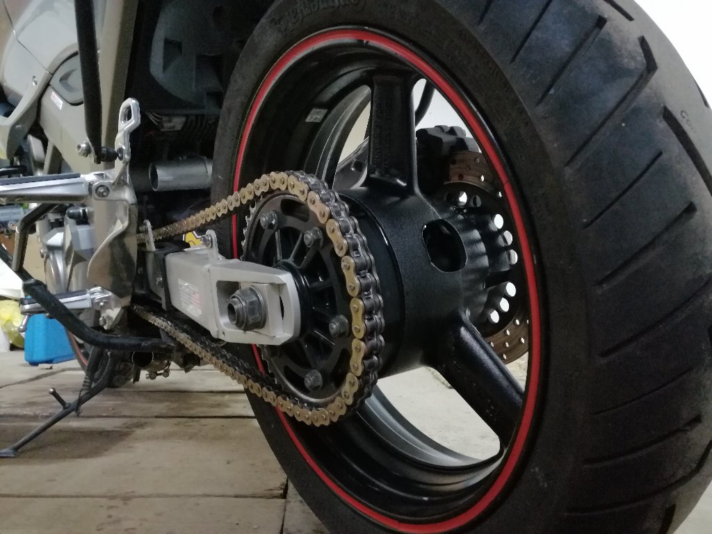

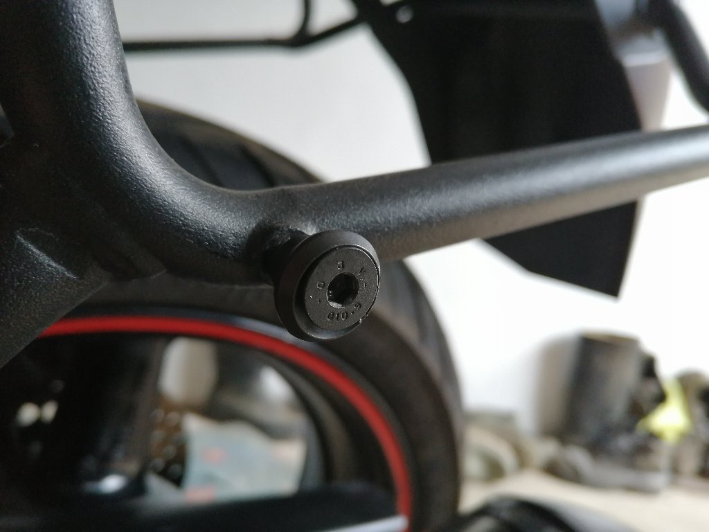

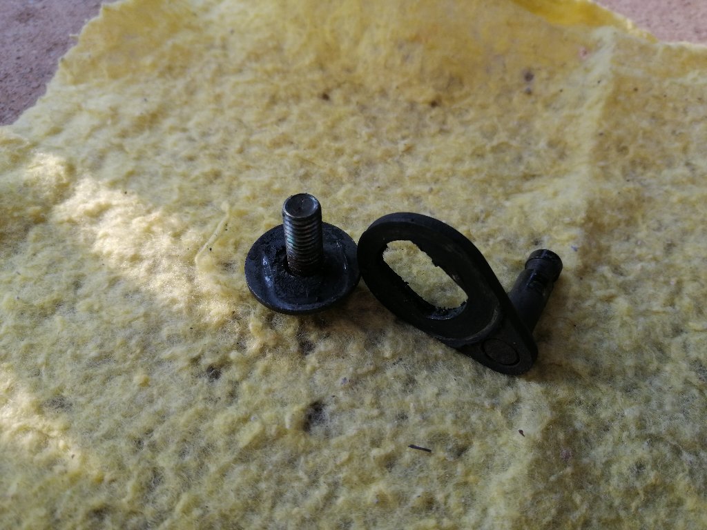

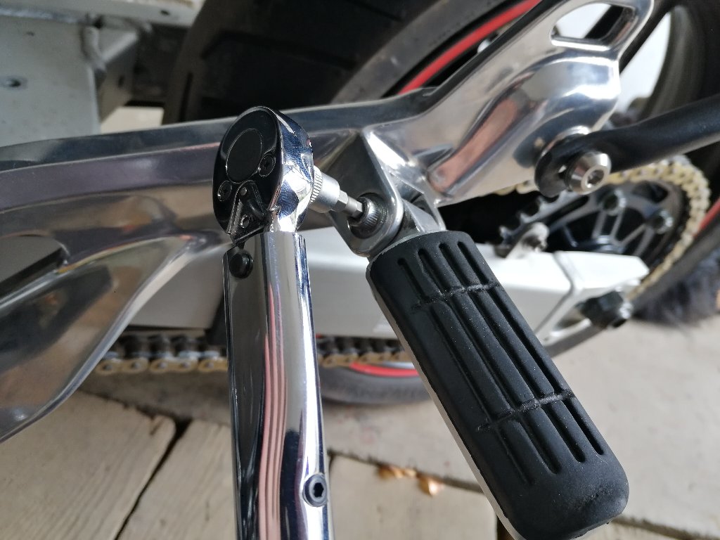

Now to tight bolts n nuts. Chain slider on 10nm. Sounds strange. But lets follow Yamaha specs.
Snapped... But snapping bolts with torque wrench. That is uncomfortamble. I dont like ugly bolts. Luckily i have two titanium M6 with hex head. Just ordered new fancy washer.

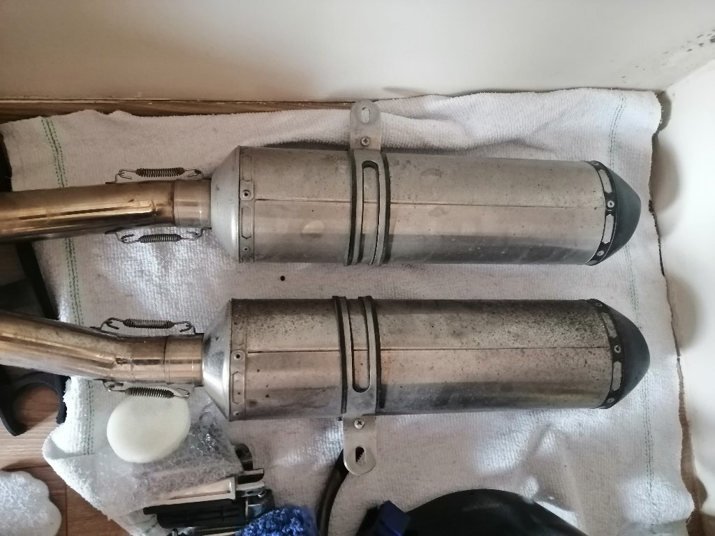

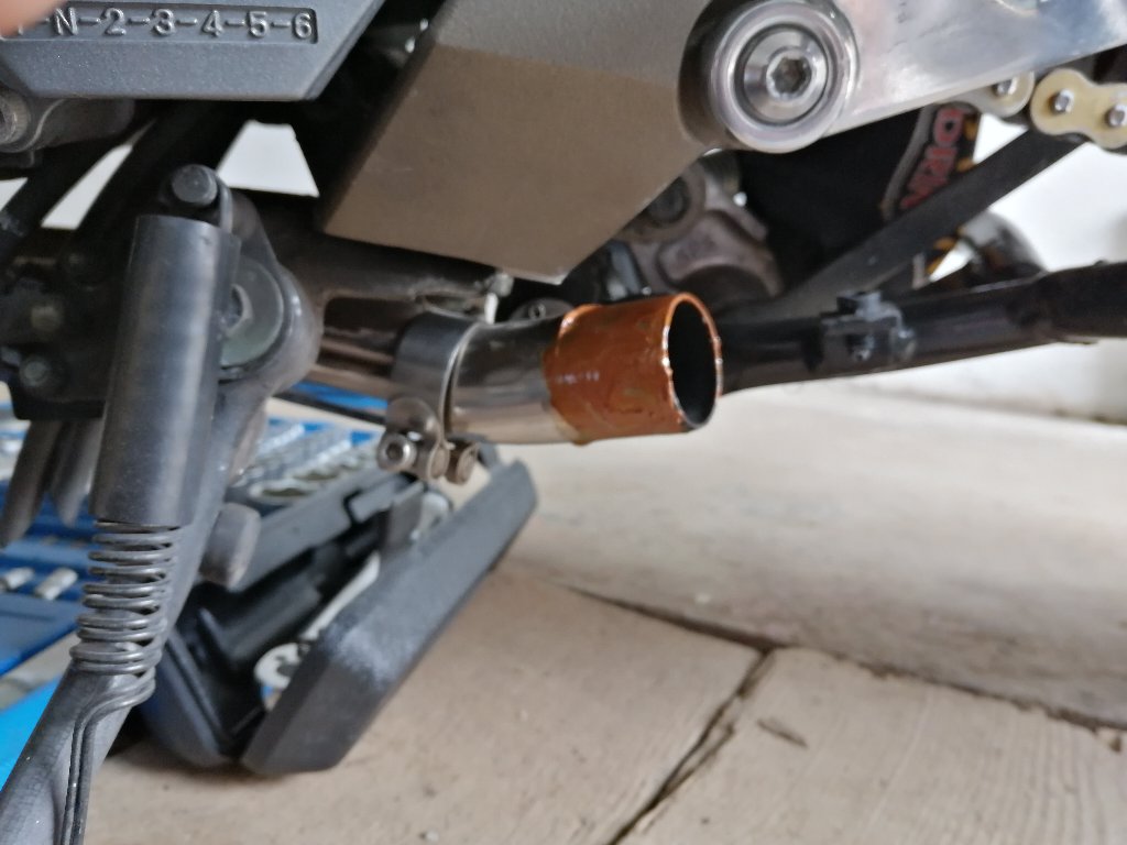

Exaust joints alway need to be treated with copper paste.
Looks good!
Lets bring back hugger and replace rivets. Old are tired.
Ugly.
Better! Small detail. Lots of small details makes bike more attractive but suptile.

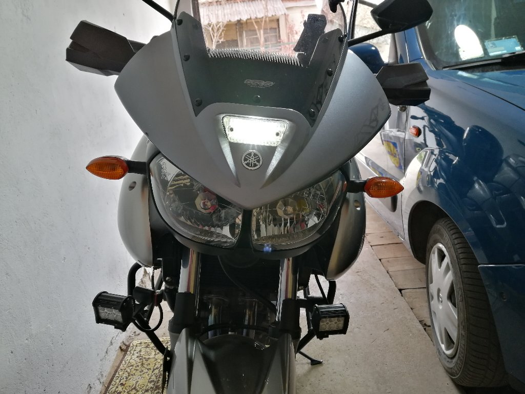

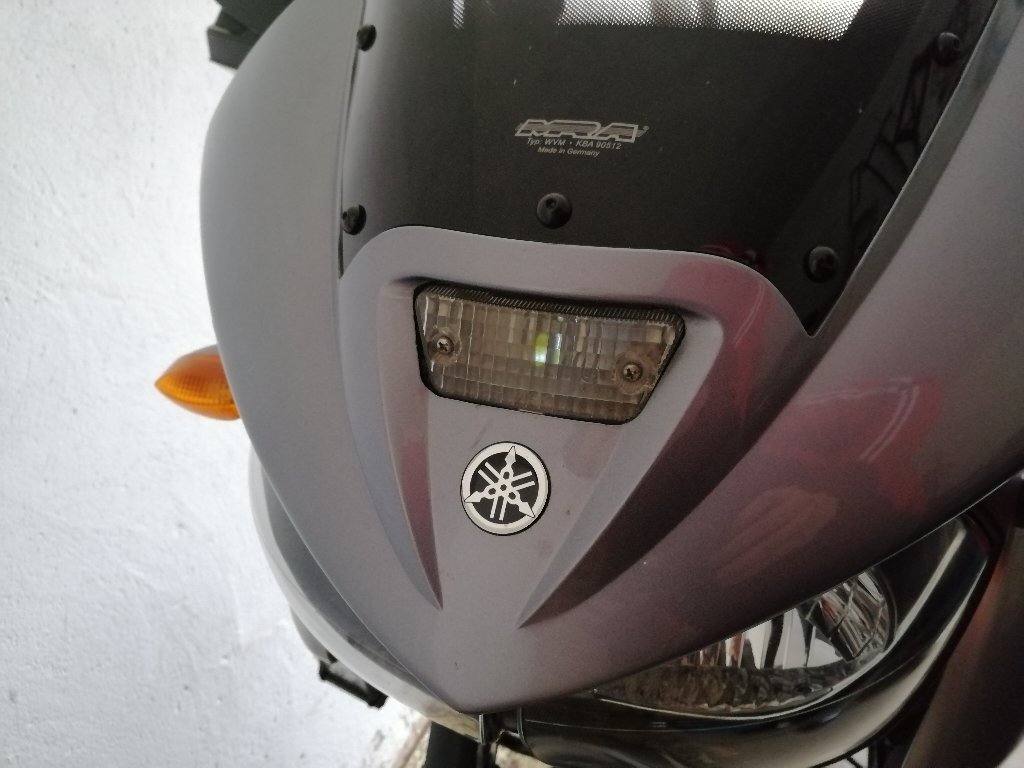

LED had its time.
Lighting! BAAH! Must upgrade aux lights also with something better.

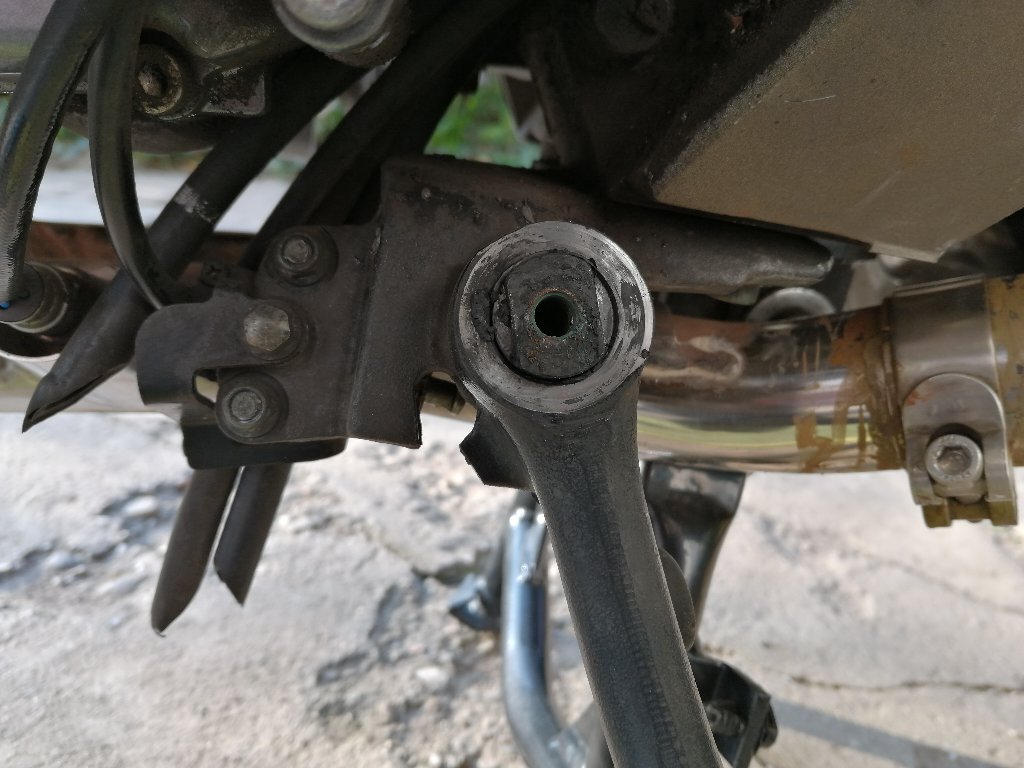

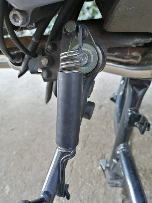

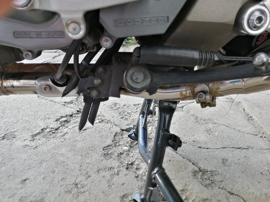

Sidestand is sticky. Doesnt feel right.
All this sticky mess.
Damn.
Clean it.
Lube it.
Extra carefull with springs. They store energy. Always use gloves and protective googles.
There!

Posted 01 April 2020 - 08:40 am

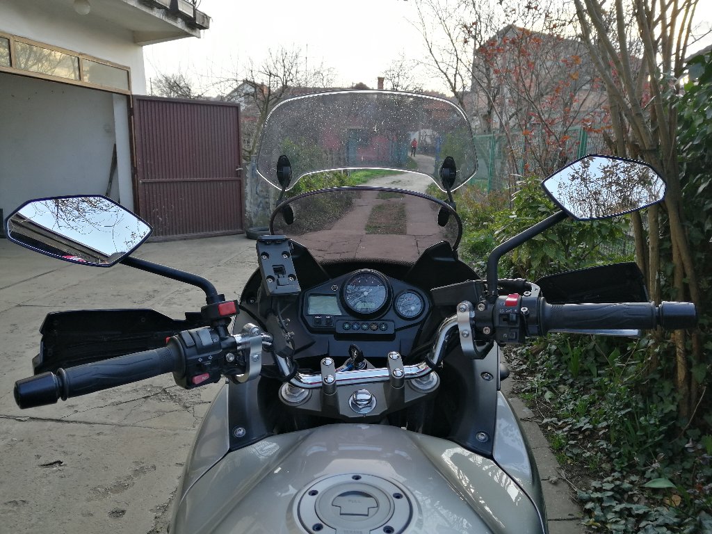

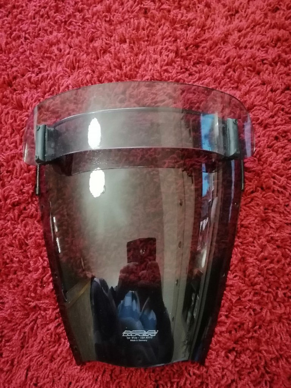

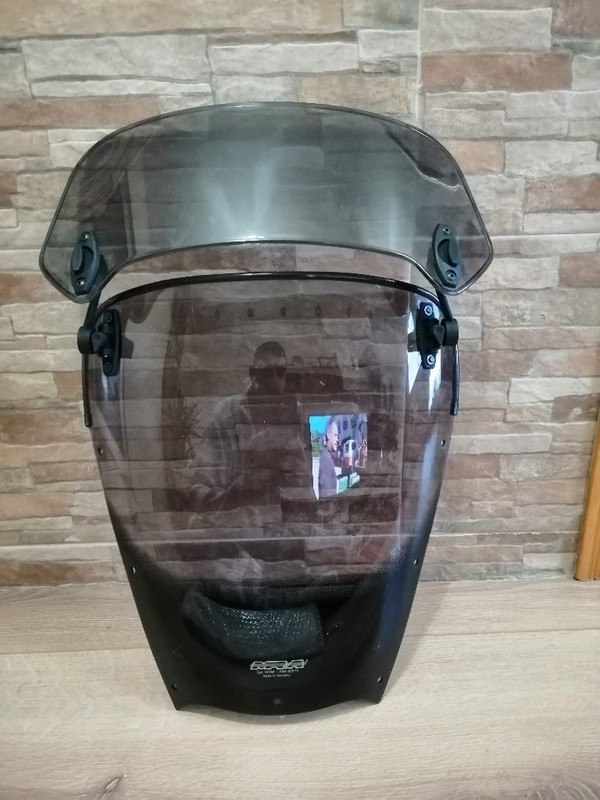

Well done! Let us know what you think of the new screen - or did you just change the deflector?
#3945 Alekre
Alekre
  • 31 posts
  • Location:Serbia
Posted 01 April 2020 - 09:14 am
That is MRA Vario Screen, base is slightly taller then OEM. If person isnt taller then 190cm it will work. I have more so it doesnt cover my head. There is version that attach like a clamp on screen edge. I think that would give that few cm that are needed to cover.

Hugger rivets, you can use M4 stainless screws bonded washer and rubber well nuts.

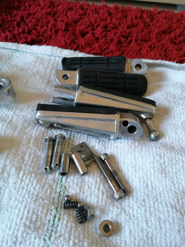

Raised the front footrests by 24mm and changed the handlebar risers mmm feels nice n comfy.
Raised rests takes the edge of the standard seat off the inside of my thigh and helps with airhawk plus sheepskin set up.

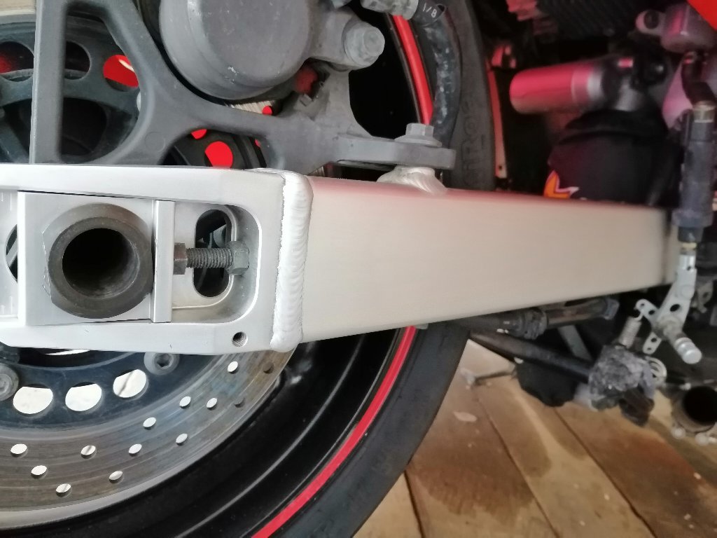

Took the swingarm off, cleaned it, greased all the bearings,
I must have been really bored, but a pain of a job out of the way  :good:
But it looks like you have gone from a vario screen to the Xcreen?
