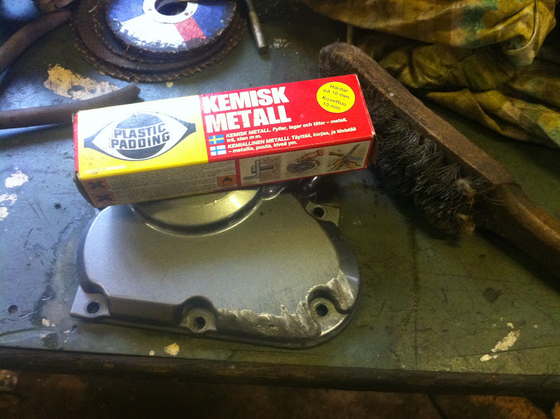

The work continues
I took of the damaged oil pump cover. The damage was not so big, only one small crack.
The bushing that centrates the cover was shered.
Out of interest I compered it to the cover from 850 engine.
The 5PS cover with the 4XT(?) gasket on it on left. The 4XT cover on the right. They fit between the motors.
I fixed the 5PS cover with chemical metal. I did the fix on the pustside so if the metal comes loose it will not end up inside the engine.
