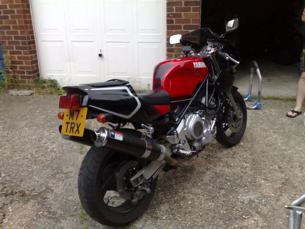

ok, story update....
the replacement engine thats now in my bike was actually Guinness' old mk1 that hutch bought earlier in the year
It needed a new output shaft, i gave all the engine and all parts required to Jenna at RaidXtreme (they pretty much run the Super Tenere XTZ750 website/owners club)
they rebuilt it and i had delivered it to Hutch but we hadnt got round to installing it yet (hence why he is on his TRX)
after the mess up with Wemoto feckin up my order i decided to cut my losses and leave it be, Hutch offered me his TDM engine
a quick road trip on Wednesday night had the engine collected and delivered to JHTs
Thursday lunchtime we started the strip and rebuild of my bike
engine was installed and i rode home at around 11pm
back to JHTs on Friday morning for a pootle round to run the engine in
on the way there lots of smoke, i had done approx 25miles on it
the oil was leaking from 2 places, the starter motor o-ring/oil seal and the input shaft cover (the round thing with an o-ring that cats has pictured above)
replaced both but no luck, there was WAY too much oil pressure behind the input shaft seal and it was actually pushing it out huh.gif
we admitted defeat lastnight (friday) at around 6pm
phoned bennetts assist and had the bike recovered and delivered to RaidXtreme
the recovery guy got stuck on the motorway, his truck broke down (electrics failure) and it was delayed in being delivered
(turns out it was the 3rd truck the guy had issues with in his 12hours shift blink.gif ) it arrived around 00:30 this morning
anyway......Jenna at RaidXtreme spent until 4am stripping the bike/engine
she gave up at 4am and grabbed some kip before resuming a couple of hours later
we arrived there at 10am this morning after being stuck in the Silverstone traffic for a few hours to find a complete TDM sitting there
its was done! she had rebuilt it overnight and replaced the input shaft seal and the gearbox fork arm rod
i took it a for a 'spirited' test ride evillaff.gif it went lovely and no oil leaks biggrin.gif
for info....
there is an oil feed coming out from the crankcase and input the output shaft bearing
from there it goes through the input shaft seal and into the gearbox fork selectors, this then has 4 very small pin holes(which is assumed where the blockage was, most likely caused by gasket goo)
which puts the oil back into the main body of the motor
now i gotta do an oil filter change, pack my stuff up and then we are good to go cool.gif
thanks to Jenna for rebuilding it so quickly
thanks to Cats for his assistance and humour keeping me sane
main thanks goes to JHT, the man is a god! i owe you big time matey!
he spent 2 full days helping me switch the engines and fault diagnosis (and even dropping me home last night)
we had long exhausted the supply of cake
i'm sorry to his missus for delaying him so long
now, about that early night........
ZZZZZZZZZZzzzzzzzzzzzzzzzzz.................
moral of the story never give up! dont let the bastards grind you downtheres always a chance to get it fixed, especially with friends like those on carpe and a healthy supply of cake/curry/coffee!
