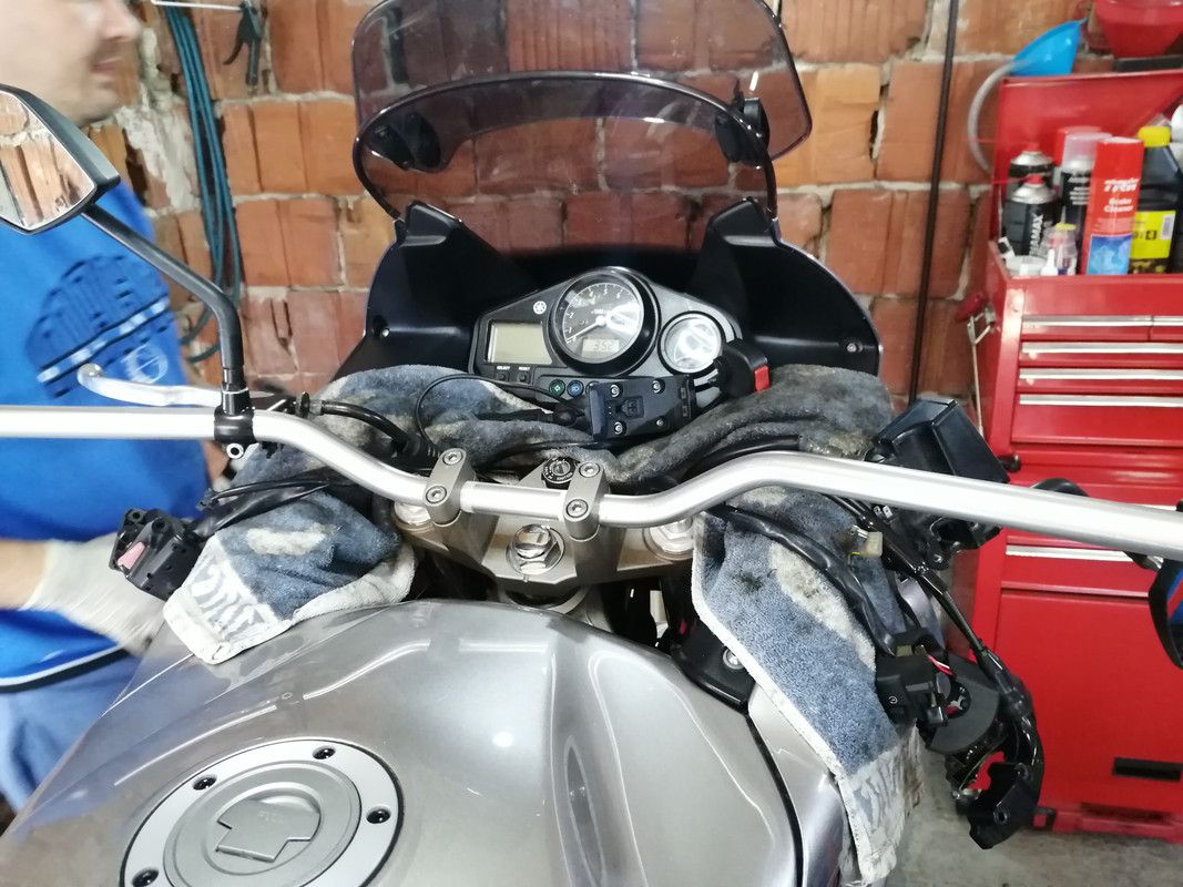

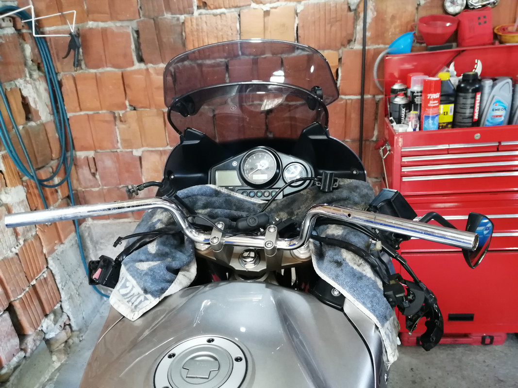

Second topis is i tried and failed to install new handlebar. Its full aluminium MOTACC.
Problem occured that this superbike handlebar is to low so handguards and brake hose doesnt have enough clearence. Both down and forward because handguard touch so no full lock.
Anyway i ridden bike without handguards and i was like WTF motorcycle transformed into. New alu handlebar is more sturdy, no flex, no resonating and leverage was awesome. Handlebar is lowered but i have long hands so now im not like praying mantis. Front end is more stable with awesome feedback. This i think is mostly due body position is more forward so there is more weight on front. Noticeably i was faster and more secure in turns.
So i think aftermarket handlebar is must have and real improvement for 900.
Usualy if something doesnt fit my 900 100% or im not satisfied with quality i discard those items. Because, few of this minors will make whole bike junk at the end.
But in this case i realy like how it handles so i will try to solve clearence issues with handlebar risers.
This lift about 50mm. Considering how low superbike handlebar i think it will be almost like stock one so cables shouldnt be issue. It also could lean it bit to me so i can have clearence for handguards.
If this works, i will order some original Rox risers or MOTACC. They are hefty price but l will order it when my wife doesnt notice :)
If someone have this setup, let me know what to expect. If this fail, i think Renthal 755 is safe and straigforward option?

I have those risers, only in black, with a Rental 755 also in black. I have shifted the bar forward and have the same experience you describe - more forward, more weight on the front wheel feels a lot better.
