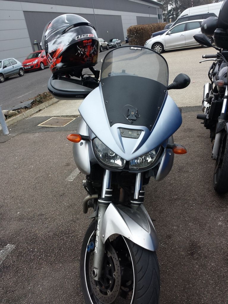

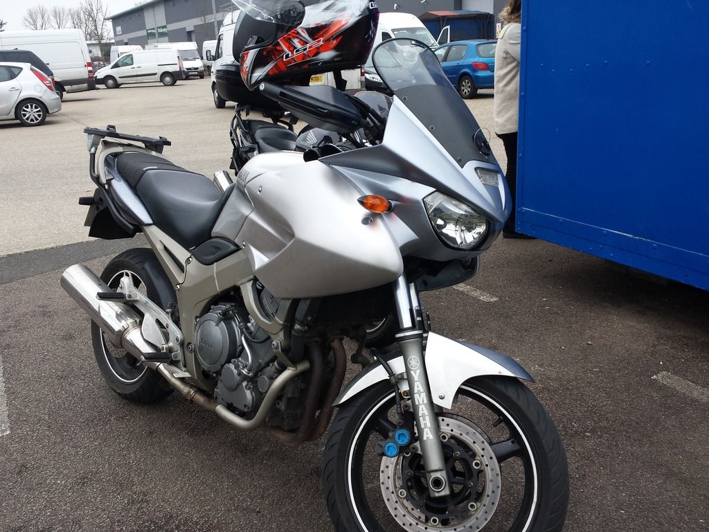

Nothing special or interesting, but just fitted some DL650 handguards (excellent fit and have a good 'angular' look), Oxford Adventure Hotgrips (the width of them is fine, some people fit a relay with switch live but I just hardwired them to the battery as the grips have a battery saving mode and turn themselves off after 2 mins of engine not running by sensing electrical fluctuations or lack of it on the battery) and a phone mount thing for navigation.
Also checked the condition of the front fairing as I'm slightly concerned about fatigue in the plastic with the huge screen mounted on there, but there's no obvious signs of trouble. Clearly I don't ride over 70mph but if speed limits would allow it I would cruise at 90mph max and only go to 100mph in short bursts because of fairing concerns!
I was hungry and tired so didn't get to it today but the next task is to fabricate a mock undertray and engine front guard out of cardboard so that my metal fabricating friend can then make the real one in aluminum!

Hi Humbertronic,
I like the handguards, did they fit straight on without any modification?

Just have to machine a slot in teh bar end weights, or buy different ones. There's plenty of info I think if you do a search. Other than that a perfect fit.
