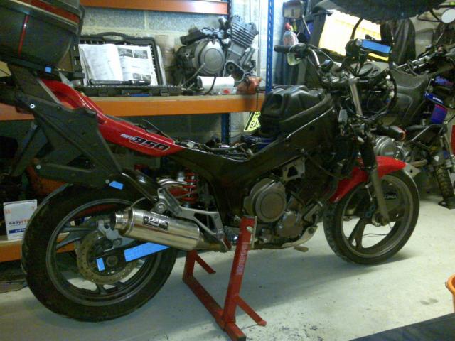

well the hightemp paint wouldnt stick to the rust coloured stainless headers, it kept flaking off dry.gif
so ended up having to rub those down again as the GF had given up for the day rolleyes.gif
exhaust fitted, turned her over but its too late to try and start her (laser pro stock exhausts badgrock.gif
battery on charge
and i just noticed i havent fed the clutch cable thru one of the guides so will need to do that tomorrow

Yup, good decision to paint the frame black, gettin there innit !
Any problems getting the chain clearance with the Pro Stocks ?

not so far, they were a pain to fit tho while on the abba stand

well she fired up on 1 pot but wouldnt run above 1500rpm then died
trying to work out whats going on at the moment
i know the battery is a bit iffy but got me jumppack on it
its been stood outside since G bought his 9er (3years?) so no idea if fuel pump, carbs or coils are anygood
left pot spark very week so trying new coils......

its got a 3VD coil fitted, prolly the original
i've got a spare after market TDM coil somewhere that i bought ages from wemoto and then i turned out to be just leads
my XTZ uses 3VD/mk1 TDM coil already
also got a couple of 3LD tenere coils in me box of bits
still hunting for it, i need to get really geeking and organise my boxes of spares dry.gif
#59 TonyDevil
Posted 18 January 2010 - 07:03 pm
BOOOOOOM headshot!
had to modify the mounts on the after market set as the holes were 102mm apart instead of 90mm dry.gif
it runs on tickover lovely, can increase the revs with choke but she only fires on 1pot when i twist the throttle
that sounds like carbs to me, so they are coming off when the smoke clears from the garage and i can breathe in there again
