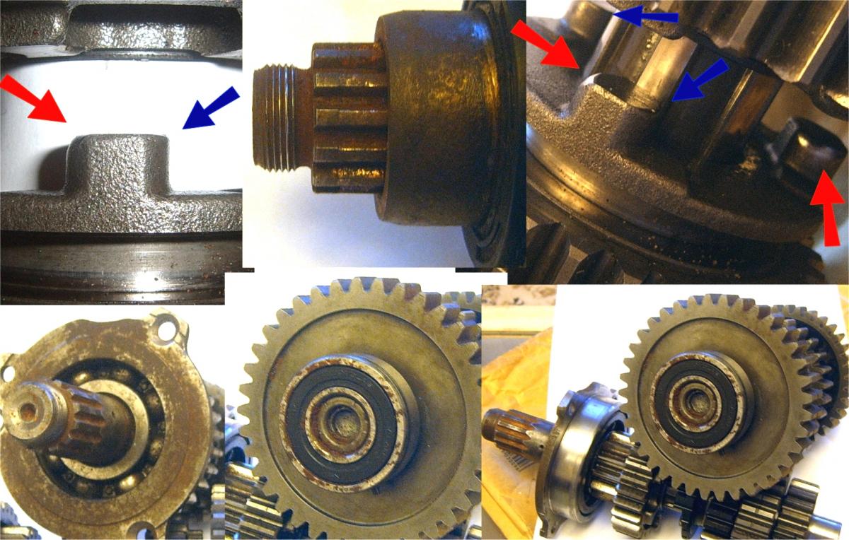

#59 Studley Ramrod
Posted 10 January 2013 - 09:08 am
Yeah, you should be looking at the dogs n cogs. :)
The arrows point at the cogs and the holes they slide into are the dogs.
http://www.carpe-tdm...c=26613&hl=dogs
#60 TYREDNGRUMPEE
TYREDNGRUMPEE
  • 1,627 posts
Posted 10 January 2013 - 10:06 am
You should look at everything really, as wear and bad behaviour in one area often leads to wear in another.
Check selector barrel, the channels that guides the selector forks. The selector forks. etc.
