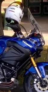

I got a really bright LED indicator/beacon unit. It had 2 yellow LEDs on the left and 2 white ones on the right, and you can set it up to flash in various patterns. I swapped over the LEDs so there was 1 yellow and 1 white on each side, because I didn't want it to appear too much as a flashing yellow beacon.
Figuring out how to mount this behind the screen now. They're bright enough to punch through the tinted screen, and would still be very visible during the day. I was thinking of hooking them up so that they operate for a maximum of three seconds (variable) with each activation. Not sure if it helps, but I thought I'ld give it a go and see
