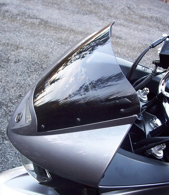

I tried another option today. I cut the shortened Yamaha touring screen a few cm. more; this time a curved line as the photo shows:
Took the bike out for a road test, without earplugs this time. And guess what? Significant noise reduction and wind pressure around the helmet! Increased wind pressure on my chest, though... And the bike felt more unstable, especially when cross-winds hit me and there's still some turbulence/buffeting when driving in traffic (driving behind cars, when overtaking traffic etc.).
But the wind noise reduction tempted me to keep the screen on the bike. But I did not, because I still think that MRA racing screen is the best option for me. It gives best protection against the wind and it hits me clean and steady most of the time.

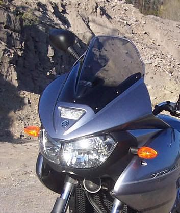

It's also a matter of looks. I think that TDM looks better with MRA double bubble fitted:
