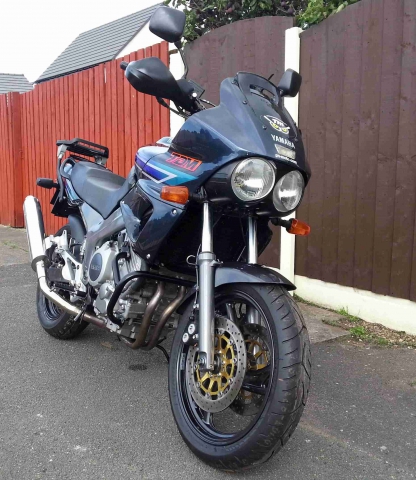

Posted 26 July 2020 - 08:04 pm
Update long overdue eh....
Well works a pain in the arse, sunny when i'm working and then pisses down for the most part when i'm off, neighbours had all the fences out to be replaced, rock faces and paving slabs getting lifted and cut, sand and cement getting mixed, wood being cut and a new roof getting put up behind us, so along with the ever present wind we have here i aint been up to much at all, plus me stamina has gone on holiday since Covid... so that's the excuses all out the way...
Gave Gerty a blert up and down the road a couple of times to make sure she worked, needed a bit of choke which is making her a bit to rich but then i'll adjustments to make anyhoo but did 1 mile  :lol:  and seems okay.
Got around to dropping the sump on Friday to seal it again without all the above shenanigans going on, this time i've sealed it with Loctite 5990 sans gasket and left it to go off, refilled with oil today and kicked her over briefly, so far so good, fingers crossed..
I had hoped to have her all ready by the end of the day for an mot on Friday but noticed today that the handle bars stays are a bit loose for some reason so will have to check that out after work, yep that's Friday and then the weathers shit next week when i'm off so fook knows !? but the long slog, boy has it been a long long long slog, is very near completion.....yes nearly, belly pan to go on when i'm sure it aint leaking from the sump anymore and the oiler needs setting up.
So for your perusal and enjoyment the following..
Edited by dablik, 26 July 2020 - 09:08 pm.

Looking good Dabs! We all know the Mk2a is by far the superior model of the whole lot but I still recon the Mk1 is the better looking bike, sometimes you just have to comprimise between looks and piss poor engineering....... :P
#716 dablik
Posted 26 July 2020 - 09:24 pm
Now now Dave, funny though cos i love the mk2 for back roads but, the oil glass sight thing screwin about, is it full, half empty, just boils me piss, and as you so rightly say the mk1 is drop dead gorgeous innit  :D  :wub:  :wub:  and thanks..
#717 Studley Ramrod
Posted 26 July 2020 - 09:26 pm
Looking good Dabs. :cool:  Deffo better looking than the hamster chops mk2's :D

2021 calendar pic roight there.
#719 dablik
Posted 27 July 2020 - 09:17 am
Cheers Ken, i'll be grabbing some in a nicer setting...
#720 Studley Ramrod
Posted 27 July 2020 - 09:19 am
I notice you've routed yer front brake lines behind the forks, whereas mine go around the front.  Do the lines on yours rub against the rad or is there plenty of space ?  Only asking as I'm thinking of re-routing mine.
