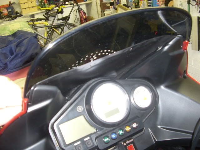

I took two pieces of Lexan, each piece is about 6" x 8". I mounted the first Lexan piece at the bottom half of the fairing. The top of this Lexan piece terminates about 2/3 way up the fairing. Then I overlapped the bottom screen with another piece of Lexan screen on the top. The top piece begins about at the middle of the fairing and terminates about 30mm about the plastic fairing tops. I have a 15mm gap between the two pieces of Lexan that is fixed with spacers. It is like a Lexan sandwich with a 15 mm gap that is scooping air flow between the two screens. The scoop inlet is about in the middle of the fairing and it terminates about 3 inches beneath the top of the upper Lexan Screen. The top Lexan piece does not have the OEM lip. I think the most benefit came from eliminating the OEM lip.
Anyway, I'm sort of short at 5'6", but now the noise/turbulence is gone except for some wind smacking the tops of my shoulders. When I removed my rather large aftermarket mirrors, much of the shoulder wind is reduced. But I need my mirrors, so I may look into handlebar mirrors. My air pocket is now much cleaner. With a full face Caberg helmet, I am catching clean wind from the chin up now which isn't a problem for me at most speeds I normally ride.
Here is a bad photo, I stuck a piece of rubber between the two fairings in this photoshot only to give you an idea of where the gap is.
Here's a photo of the gap at the bottom of the sandwich:
Can't help but laugh at this photo, because when I see all of the bugs splattered on my fairing I am reminded of going to Harley rallies in the US of A and seeing the vendors who sell Bug Spray in aerosol cans to give your Harley the real poser image.
PS: I just love my TDM. It is the Ultimate Hooligan Bike, even for old farts like me. I jump curbs, ride up stairs to hotel entrances, and slash across roads that are really no more than goat trails.
Edited by kiko, 19 September 2009 - 01:21 am.

No I did not try the cut down lip screen only without the lower Lexan sandwich in place. Part of my fairing has been repaired with some plastic epoxy and I noticed that it was beginning to crack up again after I installed my revised screen so I really don't want to mess with the screens and fairing anymore.
The reason I suspect that cutting off the lip is the most bang for the buck is when I test rode the bike with both screens in place, I placed my ungloved hand into the gap between the two screens at a speed of about 120km and I did not feel any rush of air coming up from the gap. Some air is coming thru the gap but not nearly as much as I suspected would be coming up.
So I really do not know if the gap is doing anything. Either way, it is a real relief to be able to ride fast again without all of that noise/turbulence blowing all over me.

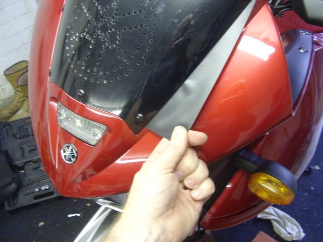

On my screen I have the holes drilled in which did help.
But by adding a second skin the effect is dramatic. I used a tough black polythene to stretch across the back of the screen before screwing it down and cut off the surplus, so it was tight like a drum.
From the top you can see the gap.
I took it up to 75 mph and the ride is much better, at 55mph its like your just rolling along with no effort.
Obviously it is temporary, but it proves your point.
I will keep my eye open for something more ridged, but as an experiment....... yahoo.gif
Its Brilliant.

I've drilled the Yam logo in my standard screen (thank you Geordie Guy). Looks great. It does make a difference and things are OK up to about 60, but at motorway speeds or above the wind gets tiring and the noise returns. For longer trips at motorway speeds the MRA Vario does help to keep the wind off quite a bit in comparison even though it is darn noisy on my set up. Next try, the dual screen idea using a polythene sheet or whatever.
#80 Geordie Guy
Posted 21 September 2009 - 09:42 pm
Mecrox,
I used the back of a A4 folder from college in the picture.
I am sure I've seen some semi-ridgid black sheet somewhere, which I will try next.
But it is going to be a perminant fixture now.
