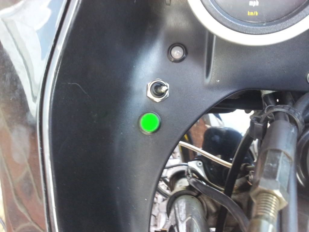

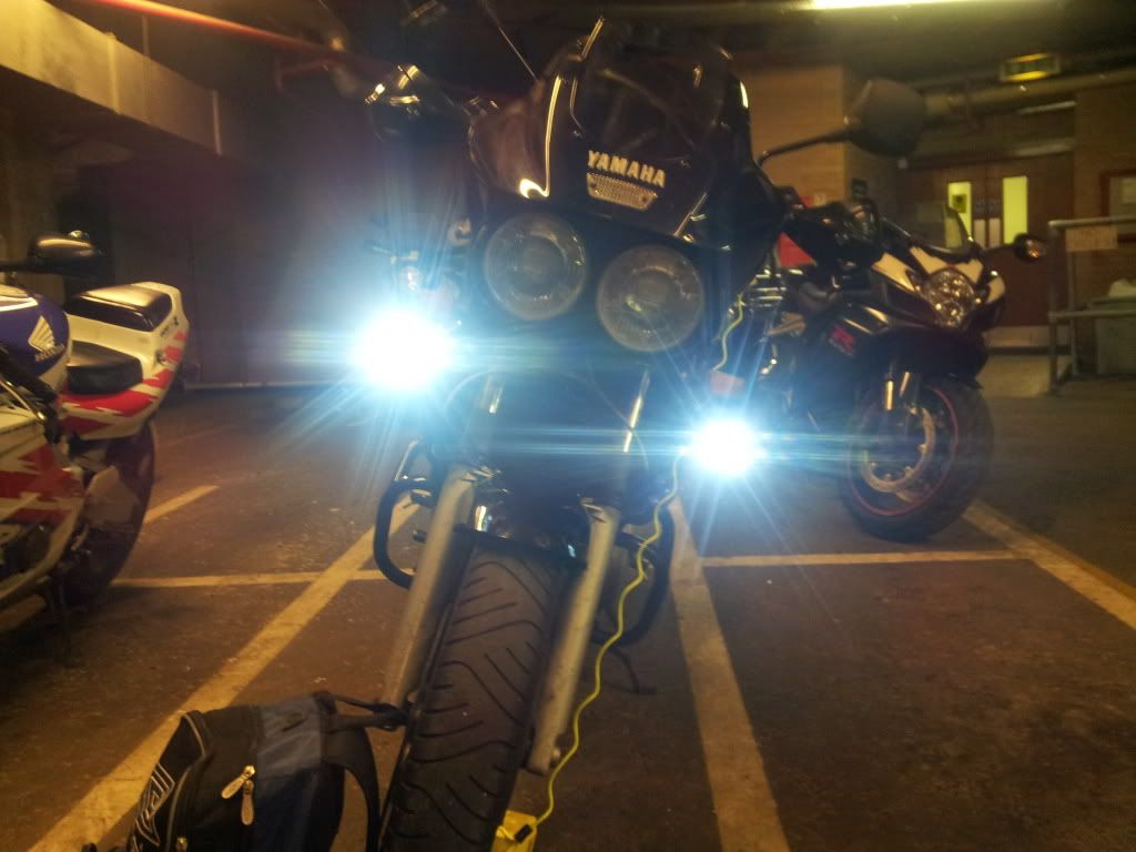

These are the ones I bought from you and recently fitted:
I did post this image after I'd fitted them, but after the Carpe crash, it lost the thread!!
They only look bright because Im in my underground works car park with my camera phone a few inches in front, but for DRLs, they work really well. Already started to see a difference in car drivers and how they notice you more easily when running with these.
I've wired them in to the ignition switched relay for my heated grips. Took a live from the output of that, to a simple dual pole toggle switch, the live feed from the lights to the other side of the switch. Earthed each light separately to the frame. I also fitted a little indicator lamp in the dash next to the switch. Live from the side of the switch the lights go to, and earthed to the frame. Hope this helps!

Looking cool mate, ....

AzzA, I've just bought some similar to these, how did you wire them in mate...
I also fitted heated grips at the same time and ran the lot through an Eastern Beaver relay unit... but, if I remember correctly, you could happily tap these into your front parking light without threatening the fuse (do check the current rating though; I could be in the early stages of senility) ;)
