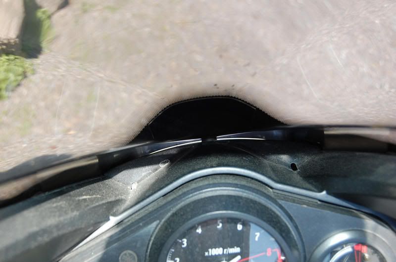

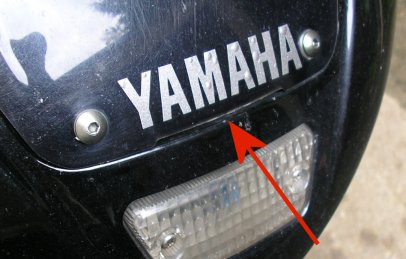

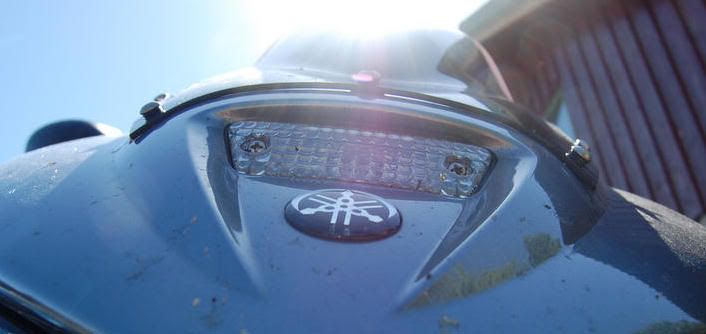

I did an experiment... just like one here suggested:
I put washers beetween the fairing and the screen (I used rubber washers...), bought some bolts/screws in real metal (same grey colour as those used by Yamaha to keep the fairing in place...) and raised the screen from the fairing to let air come through between the screen and the fairing - take a look at the pictures below.
The gap is not a big as this: .
8 mm was it?
Mine is not more than tops 2-3 mm all around.
But it helped! The airflow is a lot smoother and no buffeting/turbulence other than what comes from other traffic.
I really believe that this is a solution that works! Try it and check it out for yourself.
Later on I'll try to increase the air gap to tops 5 mm and check out if things gets better or worse...

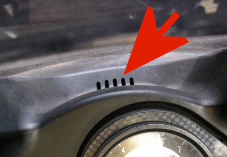

Unless I am mistaken, this type of solution is already standard on the 850 MK II:
It's a small opening but apparently effective enough to get a turbulence free air-flow yahoo.gif
