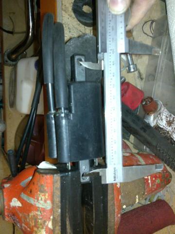

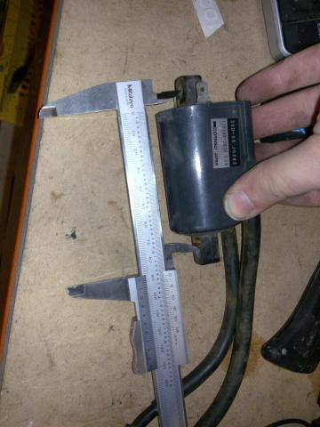

a few pics of problem investigation
coils - OEM
coils - aftermarket, i drilled holes to match the normal frame mounts

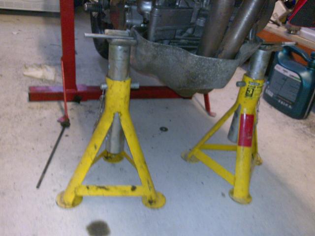

the bar thru engine mount and axles stands method of doing work on front end

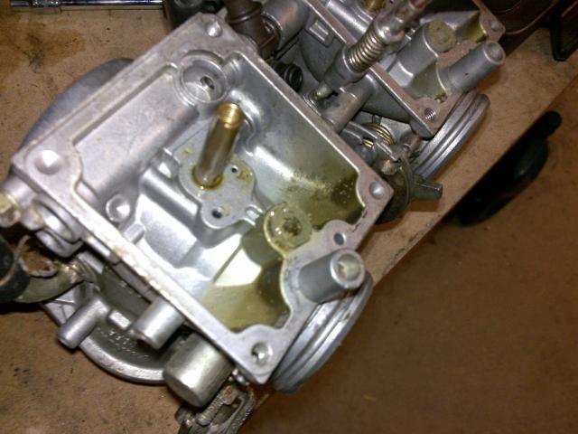

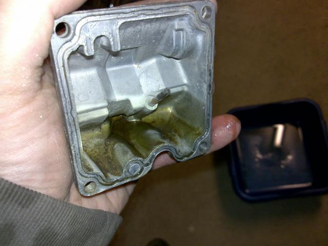

carbs, what a mess

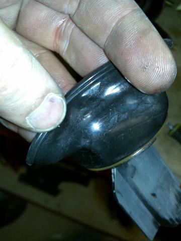

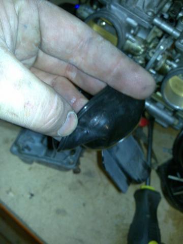

damaged diaphram, not done by me. it hadnt been refitted properly

I reckon the damaged diaphragm is a result of removing/replacing the carb tops with the carbs in situ. The diaphragm tends to hang and it's tricky to actually see if it's seated properly.
Are there any markings on the coil you've used ? Be good to know of a suitable replacement as they is getting hard to find.

maybe.....they are pretty trickey to fit when petrol soaked anyway....
nope none, i think it was an xtz750 one from wemoto
obviously as theres no plate/tax/mot etc i havent had a chance to run it at any speed yet or up to a decent temperature
will report back once i've done that on how the coil copes (i have atleast 2 spare 3LD xtz750 coils here)

I thought the wemoto xtz coil only had 90mm centres, same as mk1.
Just bought a used oem XTZ coil, mainly cos it's got good caps on it. It's got 90mm centres. I might throw 'em on and see if there's any difference.
Interestingly, and bloody typically, a used mk1 coil has just surfaced on ebaygum dry.gif

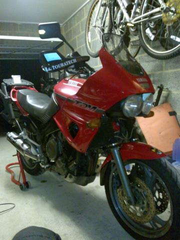

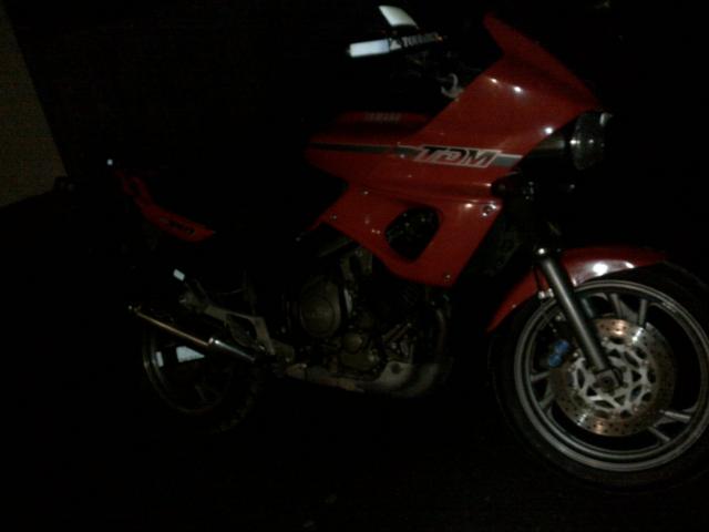

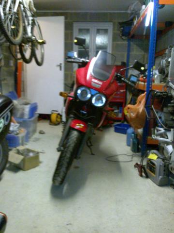

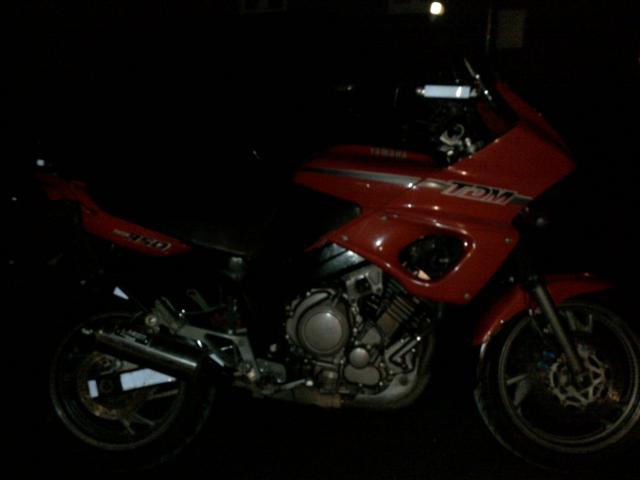

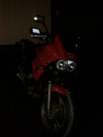

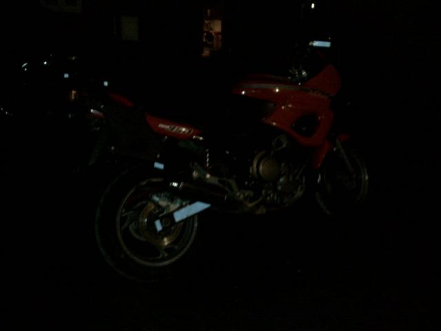

just aint worth the hassle when i already have a spare TDM frame in my name
#95 TonyDevil
Posted 24 January 2010 - 09:26 pm
and she's together and all appropriate nuts & bolts have been double checked & torque correctly etc
she leans over along way....need that modified sidestand....
will ask Kris to take some better photos in the light tomorrow and post up cool.gif
