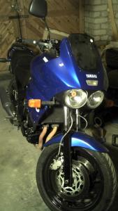

Guys,
just got installed new pump. Was annoyed of blowing into gas tank each time when carbs get dry.
Got it from ebay - cheap and easy chinese product:
http://www.ebay.com/...GB:1120&vxp=mtr
Ordered it last year, but installed only now :) Payed 50 buks.
Attaching was rather simple. Just needed to get fuel line adapters from 10mm pump size to 8mm line size. One wire soldered into flasher relay brown wire that was located near to accu and another one connected to minus on battery. Decided to go without extra relay. With few plastic fasteners attached the pump to frame where old pump stayed. Will check later if some more solid construction should be made.
The pump itself is the same vacuum pump, but driven by some electric motor. When it pumps the pressure into carbs it just stalls unitl bike is running and it works again.
No more any plastic coke bottles are needed  :tup:  :D :D
