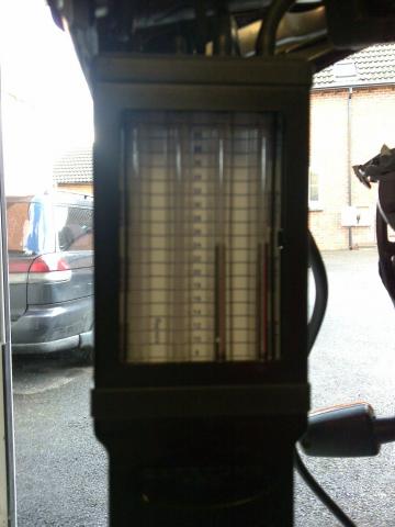

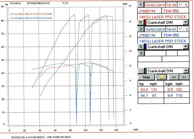

the balancing screw is seriously sensitive, vid of it running on carb balancer http://www.facebook.com/v/296872522668
fueling is sorted she runs perfectly throughout the rev range, 12.5 to 12.8 on the dyno sensor so mildy rich
best multigear run
and the other 3 top gear runs
and Cliff/Dablik is coming to collect her tomorrow and will take a couple of pics in the light in the morning

QUOTE(Studley Ramrod @ Sun 7th Feb 2010, 01:01 PM) <{POST_SNAPBACK}>
82bhp, I'm gonna have to find 12bhp to get near that blink.gif but I'll have a go smile.gif

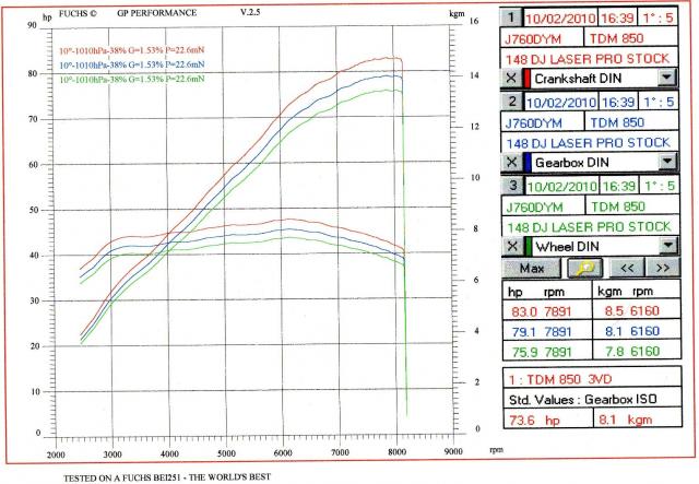

#137 Guest_GuyGraham_*
Guest_GuyGraham_*
Posted 11 February 2010 - 12:39 pm
QUOTE(TonyDevil @ Wed 10th Feb 2010, 07:26 PM) <{POST_SNAPBACK}>
I only see 76hp at the wheel, & 83hp at the crank on your dyno graph which is about right for a TDM
The 84.7 was at the crank, through the gears, which as the power was held on and it got warmer resulted in a too rich mixture on the last gear resulting in the 83hp (at the crank)
Edited by GuyGraham, 11 February 2010 - 12:42 pm.
#138 TonyDevil
Posted 11 February 2010 - 12:51 pm
#139 dandywarhol
Posted 11 February 2010 - 05:07 pm
Red graph = crank power
Blue graph = gearbox
Green craph - rear wheel
Kinda self explanatory - even if the dyno guy doensn't know what he's talking about/bullshitting you Tony.............................nice spread of power though - ironed out the usual 5,00 rpm "glitch" and up around 6 horse from a new tight one (bottom box) good.gif
