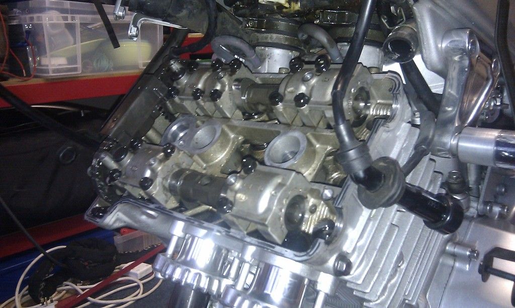

Today I added an oil preassure switch. I chose this location because it is the furthest place where oil preassure has to reach, so if oil preassure should ever dissapear, it is the first place where it will hapen. Also there was M8 threaded hole in there.
I bought an oil preassure switch whitch had M10x1 thread on it, so I had to rethread it.
Sorry my Iphone does'nt make good pictures...
Had to grind off engin rib a bit to make it fit: (pic is in a wrong angle...sorry)
Work on my bike hasn't ended jet!

I am afraid that not enought oil pressure on that cylinder head hole it waisted for camshaft oiling and line was devided between camshafts, it will not engage your switch. Why you did not put it to that line where oil going to head?
Check manual, you will see all oil lines there
Edited by eerik, 19 March 2012 - 08:45 pm.
#130 aircooled68
Posted 19 March 2012 - 08:44 pm
QUOTE(eerik @ Mon 19th Mar 2012, 08:24 PM) <{POST_SNAPBACK}>
I am afraid that not enought oil pressure on that cylinder head hole. It will not engage your switch. Why you did not put it to that line where oil going to head?
Oil not at pressure there... only flung round off the cams
Edited by aircooled68, 19 March 2012 - 08:49 pm.
#131 Margus
Margus
  • 133 posts
  • Location:Estonia
Posted 19 March 2012 - 09:02 pm
Yes oil is under preassure in there. It is a oil pressure channel. I looked into them when I adjusted the valves.
I will test it in this weekend whether the oil pressure switch works in there or not.
#132 aircooled68
Posted 19 March 2012 - 09:10 pm
Must be different to mk2 other side of that bolt just leads to a well in the head ..... still sure it would never operate a pressure switch, hope im wrong
Edited by aircooled68, 19 March 2012 - 09:42 pm.
#133 Studley Ramrod
Posted 19 March 2012 - 10:18 pm
Margus is right actually Dave. Just looked at a mk1 and a mk2 head and you can see the line the oil feed pipe takes from the oil pressure check bolt from the outside. You'll also notice that it branches off twice, this is where the pipe feeds the 2 cam bearings and the pipe ends at the 3rd cam bearing. smile.gif
I'm not sure if the pressure switch would work or not though, there seems to be very little pressure when the oil dribbles out of the bolt hole. unsure.gif

QUOTE(Studley Ramrod @ Mon 19th Mar 2012, 10:18 PM) <{POST_SNAPBACK}>
I love the fact you have a mk1 and a mk2 head close to hand so you can check. rotflmmfao.gif
#135 fung
fung
  • 84 posts
  • Location:South East Queensland
Posted 20 March 2012 - 05:32 am
QUOTE(Matlock @ Mon 19th Mar 2012, 11:23 PM) <{POST_SNAPBACK}>
cheers
fung
QUOTE
I'd rather wear out than rust
#136 aircooled68
Posted 20 March 2012 - 01:23 pm
well fookme ... mine comes out the same rate with or without engine running ..
