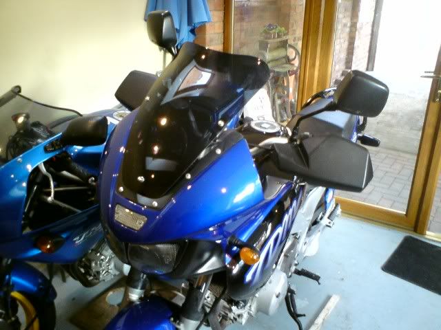

I'm actually a little embarrassed to admit it, but after cutting mine down (which fixed the buffeting btw) but not liking the look, I bought one of these on ebay
Cheap and nasty, it fits poorly, there are areas of distortion from sloppy moulding, don't know what it's made of, hope never to hit it at speed with any body-part....
But to my surprise, it seems to work better than the stock screen! It's a bit taller, and has the bubble thing going on, although not as sophisticated as an MRA or similar. But I landed mine in Aus for about AU$25, so I had nothing to lose. Done about 1000k with it so far, from dirt road to a 300km stretch of straight country highway.
Anyway, the point of this post was, if anyone is planning to experiment with cutting a screen down, perhaps you could buy one of these cheap rubbish ones and find something that works, before hacking into the oem screen.....

#151 Geordie Guy
Posted 13 April 2010 - 11:50 am
Well for £18.02 it is worth a punt.
Promise this time not to attack it with a drill.
If its no good for me I will sell it on here for someone else to try.

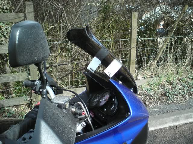

These were 2 of my recent attempts, but i have now gone back to a cut down std screen with the leading edge raised about 8mm off the fairing, this just get my helmet in clean air and i am 5'10".
96 TRX 36K Blue
