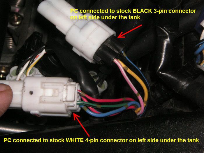

Having recently purchased a Power Commander for my 2002 TDM900 I set about installing it according to the supplied instructions.
The instructions provide a picture showing a four pin connector which it says to disconnect. This appears to be in a bundle of four connectors located under the fuel tank. The problem is that the connectors fitted to the power commander do not fit the four pin connector that appears to be indicated on the instructions.
There is a four pin and a three pin together a little further towards the front of the bike. The connectors fitted to the power commander do fit these.
Has anyone fitted a power commander to their 900, had a similar issue and can you explain what you did?

It all fits ok, but not in the fashion shown in the fitting manual.
I discovered soon if enough that something didn't add up the way I expected according to the manual. Figured it out on my 2006 model after some fiddling with wires and connectors and I took a few shoots that might be helpful...
TDM 900 2006 mod.:

That looks great, very helpful. Thanks for the info I will dive under the tank next week and have another look. Thanks again

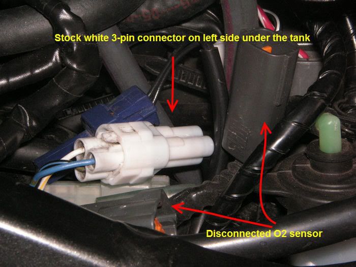

On the principle that you can never have enough useful instruction check out the pic below, which I used when I recently did mine. As AJ says the Dynojet instructions are misleading so use these instead and it'll be fine.

All these pics are great. Far clearer than the black and whites supplied with the PC III. I shall take another look next week. Many thanks for all the help provided.
