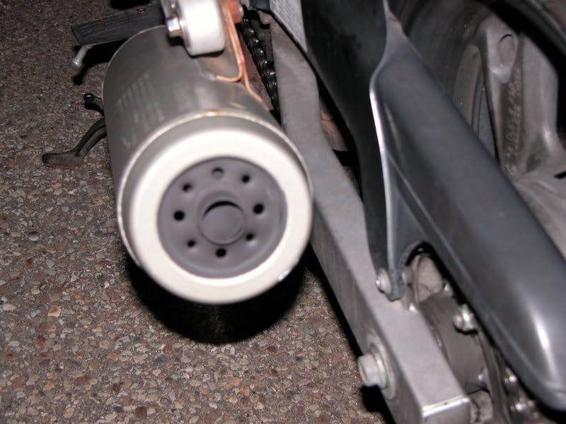

At first glance there's nothing too unusual about this bike, certainly not for the layman.
However, there a a couple of bits missing from each exhaust tip...

And the result is this
keep your first cut to just behind the outside weld, this will give clean edge and a flush fit for any replacement pipe.
The pipe that gets left in place is welded to the baffle wall, it's not going anywhere without significant force, so it's safe to leave it there.
In retrospect, I would not have gone as deep into the exhaust on the second cut, my bike is now quite loud. Not so loud as to attract attention through normal riding, but when you whip it it barks. So, if you were to do this, I would recommend making the inside cut about 5mm inside the can... ride it, test it, then make more cuts if you like.
A steady hand and gentle rocking motion will help give a neat cut, don't try and force it through the metal; it's stainless and it will chew the cutting discs to bits if you do. I used a dozen discs on the first can, but only two on the second can... guess I finally got my hand/eye together.
If you make the final edge as square as possible you can replace the cut pipe, returning the can to stock "sewing machine" sound again.

I've slipped the cut-out pieces of pipe back into place, with the bike running giving the odd rev', and it returns the sound to stock.
Short of welding in replacement pieces, to return to stock, you could use a bead of HT RTV silicon sealant to hold the pipe in place. (For a Road Worthy Certification etc)
Take it out again, by breaking the RTV, and it's loud again.

So if I want to get to there I would just need to cut out the section with the holes drilled into it?
How does your technique sound?

So if I want to get to there I would just need to cut out the section with the holes drilled into it?How does your technique sound?
I don't have an 850 to play with, so I can't say for sure, but it's likely to be so... from what I've read the the 850 can is three parts like the 900's, cut into the back end and you bypass the last section, which is placed in the middle of the can.

I drilled some holes in my old stock 850 exhaust went through the outside plate but went through the second plate which is about 2mm thick.
i only drilled two holes to begin with but found that ok that was louder didnt want to drill another 2 holes straight through in case it was to loud!
Looking at your pic you only went through the first outside plate is that correct?
Thought if i did F**K it up then could have a disc made up to fit back on.
How did you get your holes lined up equal all way round did you make up a template first?

I kinda understand the theory on the taking the centre of the exhaust, but get a little confused with how much to take out.
On the 9er, it's the middle pipe that is removed (the centre of the exhaust about 25mm diameter). Now with the cutting discs, do you go inside this pipe, and cut a further down (inside the main part of the exhaust).
I know that probably was obvious from Az's original post, but wanted to make sure before I start hacking bits off ;-)

Correct.
Kraft paper disk with a centre hole... on retrospect I would have used a punch, made dimples and then chucked the paper.
Sound is actually a bit 'deeper' just the way my digi picked it up.

VERY interesting, did you pull anything out of the center or just cut off the tube extending in the middle ?
It should let just a little (enough) of sound out.
Maybe you knew that the inside pipe is stuck on the other side but if I look inside I can't see where, somehow is stuck.
Your bike is from 2008 , isn'it?
Perhaps the exhaust pipes in 2005 of mine are different and they change country by country.
Here in Italy we have RN11 euro2 pollution law ,and RN18 euro3 pollution law.
Anyway inside my Can I don't see anything to support the pipe , except on the outside weld huh.gif

Yes, inside the pipe is where the cutting disc goes, it is much easier and neater this way... less likely to slip and leave marks, and the disc might be too big to cut from the outside anyway.Use a depth gauge on a vernier or just a stick/screwdriver to work out how far to reach in. You want to be behind the weld but in front of the wall (looking from the back of the muffler) for your first cut.As I said, gentle hand pressure, almost none, and small smooth movements for a neat cut and good disc life... but have some spare discs handy.

... did you pull anything out of the center or just cut off the tube extending in the middle ?It should let just a little (enough) of sound out....
Only thing that came out/off were the two pieces of pipe, as pictured.It lets plenty of sound out, only the real hardcore would want more.
