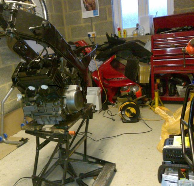

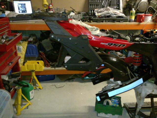

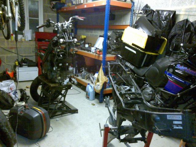

finally got around to rebuilding Gs old mk1 as the GF has killed her bandit again and i want my TRX back....
anyway a few photos
started with an engine on my work bench and plonked the frame on top(note the rest of bike on a heap at the back of the garage)

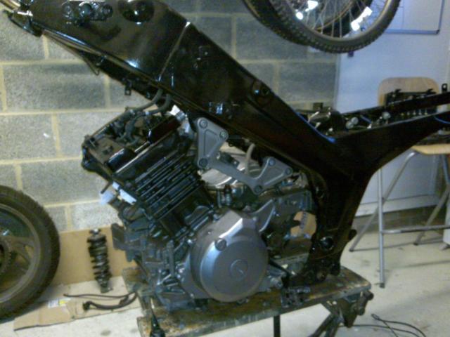

frame paint "black smooth" hammerite by the GF
wiring loom, oil system and yokes fitted
old frame with swingarm still attatched (about to be removed and hammerited
raditor & water pipes and topped up with coolant (one of the pipes had a leak so had to replace em with a spare set)
lights and more electrics fitted, had to modify the clocks as they were KPH, had a dead set with mph so a bit of fiddling and they sorted =)
carbs & fuel system, new hoses all round. swingarm painted and shock fitted, forks serviced and fitted all parts cleaned and tidied up where needed
note the heater in the background, 2kw under £20 from B&Q....fantastic cool.gif
all bolts replaced with stainless, alu or Ti depending on need (and whats in my spares pot)

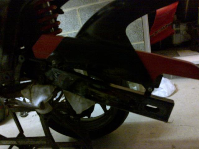

Liking the black swingarm, might be worth shoving some waxoil or similar inside it while it's all apart, or is there a risk of it getting out and on to the back wheel? Not so sure about the red bits on the chain guard but I'll reserve judgement on that until it's got the faring on.
Edited by ChrisG, 15 January 2010 - 07:06 pm.
#3 TonyDevil
Posted 15 January 2010 - 07:12 pm
the chainguard was red when i got it, think that was one of Gs modifications
the swingarm is getting black reflective tape down the sides with white carpe lettering etc, will do that in a bit once i've munched the veges i've just burnt dry.gif
will look into the waxoil thing in a bit

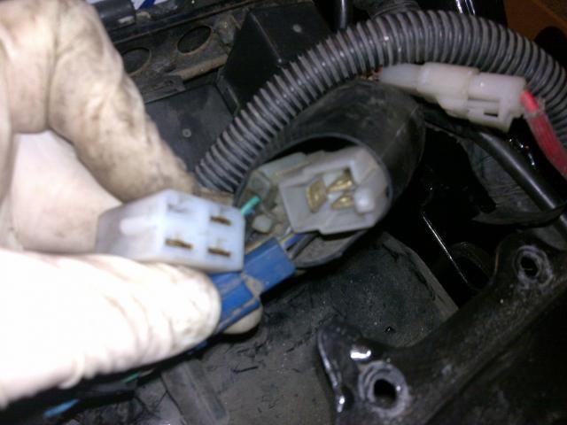

anyway...to the problem
bought an engine from a guy who had it in his XTZ750, although its a proper 850 3VD engine
on the right is the 3pin plug from the standard 3VD wiring loom, on the left is the 4ping plug (only 3 used) from the alternator cover
all the wires are white, which one goes where? or doesnt it matter?

Sorry I am no help with wiring. The 4pin is a 3LD modification he made?
i ruhroh, sent him as message and asked on the XTZ forum to see if anyone knows
i dont really want to start pulling my XTZ apart to check as its a complete arse to get to and i already have 2 bikes in bits dry.gif

QUOTE(TonyDevil @ Fri 15th Jan 2010, 07:12 PM) <{POST_SNAPBACK}>
It makes no difference Tony, any to any !

Far as I know, all three white stator wires effectively the same - any to any for those. Haven't tested that personally, but have that on good account.

IIRC the 3 white wires are the AC voltage outputs from the generator that goto the reg rec to be changed to DC, so I dont think it matters.

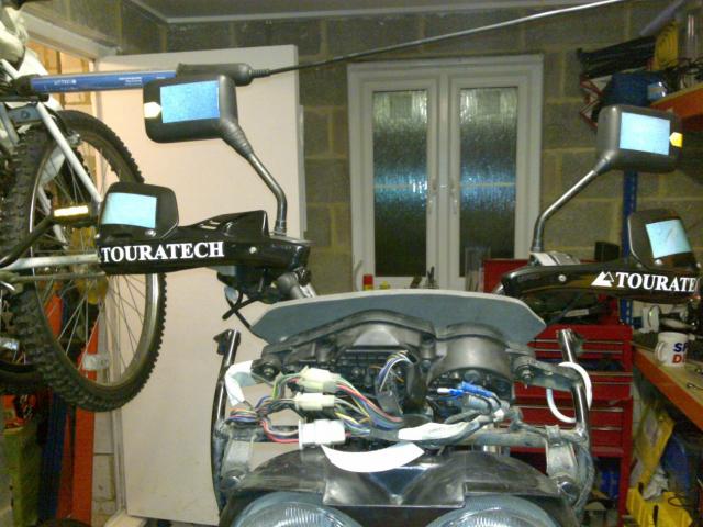

Posted 16 January 2010 - 12:33 am
reflective black tape (sticky paper) on swingarm with no flash

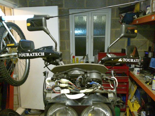

....and with flash
and same stuff on handguards and mirrors, no flash

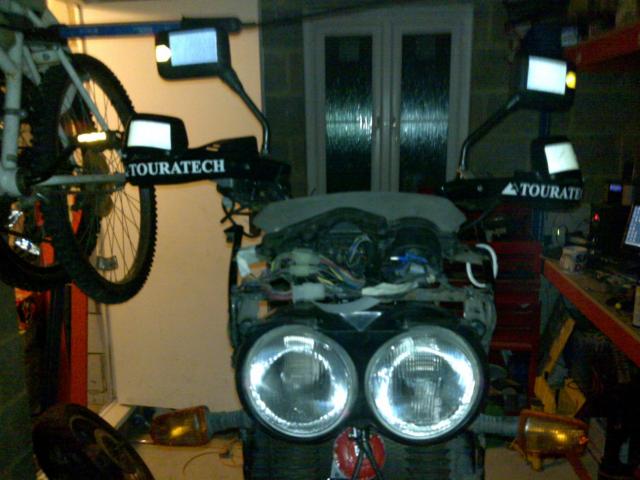

and with flash and in the dark
hmmm....may remove the big patch from the mirrors
i loike this stuff, canne see it against a shiney/metalic black paint except when light shines on it
and now run out of stuff i can do until wheels are sorted tomorrow....

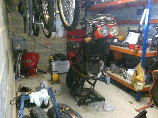

giv/kappa rack installed (just need the pillion peg mounts but the GF wants to paint them tomorrow rolleyes.gif)
quiz time : how many TDM engines are there in this photo? (not inc the one in the bike i'm working on)

#18 TonyDevil
Posted 16 January 2010 - 01:48 pm
QUOTE(Jolly Giant @ Sat 16th Jan 2010, 07:06 AM) <{POST_SNAPBACK}>
phoar....phwee
My daughter has that stereo and what a posh garage you have with a computer but what the hell are you looking at on it??
WMP by looks of it
this garage is nice
double glazing
2kw heater
docking station for me laptop
surround sound 250w
running water - need a mini kettle
only thing i need to do is seal and paint the floor.....easier said than done dry.gif
