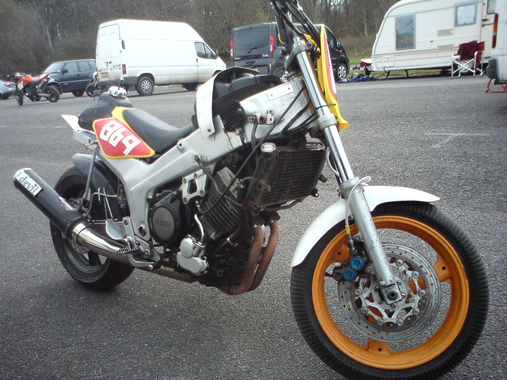

Ok it's been a long time coming but I have got there!! The race bike is (or should I now say was) completed and ready for the begining of the season!!
Hartland Quay is a great place to go for a hill climb but I think that has as much to do with going to the pub the night before as what the hill is like!! After many nights swearing in the garage the TDM was ready and started first push of the button, it got through scrutineering with only the need for a catch tank for the carb breathers!
The first run was somthing of a trial by fire having not even sat on the bike before so pre run nervs were on teh spin cycle in my guts!! Or was that last nights beer?? Well the bike feels superb after all my messing with it the only problems were a lack of top end power and a funny clonk (more on this later)!
The day passed without any problems and I managed to get close to my personal best for the hill and managed a spectacular last in class!!
Back in the garage I found the reason for the lack of top end in that the exhaust cam was one tooth retarded on the timing!! ohmy.gif
The beasty at Margam Park!!
I hope that worked!! I can build bikes but sometimes the interweb is a little beyond me!!
Right back to the story!!
After correcting the cam timing the bike pulled much stronger and was far better to ride and I was getting the hang of it to so much so I managed to come second to last in class this time!!
I was well chuffed about this but the funny clonk was still ther (said there would be more on this) well any way at the end of the day on my return to the pits the clonk problem identified itself when the engine seized solid!! Fortunatly I was only crusing in a straight line so pulled the clutch and was able to coast to a stop!!
Currently the engine is spread round the garage waiting for parts, the number 2 big end shell had spun!! But it's going to be all new and shiny ready for Gurston Down at the end of May!!
Now a little more about the bike??
Well the frame forks and swingarm are MK1 TDM form a 1996 bike, the engine is TRX850, the front wheel is from an FZR600 but I don't know what year, I think it's the same as a TRX?? Well that wasn't so easy to fit as I had to make my own spacers for it and move the clipers 2mm towards the wheel as the hub part of the rim is narrower than the stock TDM. The calipers are R6 blue spots and I'm using an R1 master cylender (just what happened to turn up on eBay). The rear wheel is from a 600 Bandit and to fit this I had to drill out the swing arm and the chain adjusters to take the 20mm axel from the Bandit, I used the Bandit cush drive, disk and caliper carrier which had to be machined down (I can't remember by how much at the moment) the rear caliper is of a GSXF750 and rather than make up atorque arm I chopped the TDM caliper carrier down so it could be bolted to the swign arm. The tank is mounted at the back and is from a Thumpstar pit bike as is the seat which I have shoved up to the air box to move my weight 6in further forward!!
The bike is well balanced with a 50 / 50 weight distribution even with me sat on it!!
More later hope you all enjoy!!

MK1 TDM850 road bike, FZR1000 Genesis front wheel, 600 bandit rear wheel with a 160/60/17!! Half worn BT016's!!
MK1 TDM850 race bike, MK2 forks, FZR400RR swingarm and linkage R6 shock, 900 barrels, 11.5:1 Wiseco pistons n stuff

The number on the side says 869 and the number on that bike is 859 they look suspiciously similar though.

How heavy was it after you stripped all of the fat off the bike?
It looks as if you could drop those yokes further if you needed to.
What bikes were you up against?
I wondered if anyone would notice that. smile.gif I think the action photo was from a run in March, but he is called Adam and is riding a TDM according to the results.

The two numbers are for two different clubs I was trying to get the same number to make it simple but failed!!
The bike weighs in at 175kg with fuel oil and water, I would have liked to get it a little lighter but it's a good starting point.
The usual collection of bike for the 1300 class is KTM 950 SM, a Ducati 960 special, GSXR1000 K5, TZR250 with an Aprilia RSV motor in it and an SV1000. I find it great coz of the wide range of machines and specials. Although the fastest bikes are the ex Supermoto race bikes.

How do you rate your TDM as a hillclimber? I guess that power is 'adequate' and the blue-spots are presumably good. How is the handling/grip?
What is the advantage of a Bandit wheel?

I like the TDM as a hill climber and I'm not the first to use one either.
The power is good but it's the wide spread of torque that makes it!! I was previously on a YZ250 so the flexibility of the engine is something new for me and I'm liking it!!
The Bandit read wheel is 4.5 inches wide so better for fitting a 160 section tyre as it's not pulled out of shape. I choes a 160 section tyre as there is a vast aray of racing rubber in that size and nothing in a 150.
Yes there is a lot of prep and traveling for the amount of riding done I think in a whole season my bike will not even do 50 miles but it's the social side of the events that make them good and hill climbers are a friendly bunch!!
