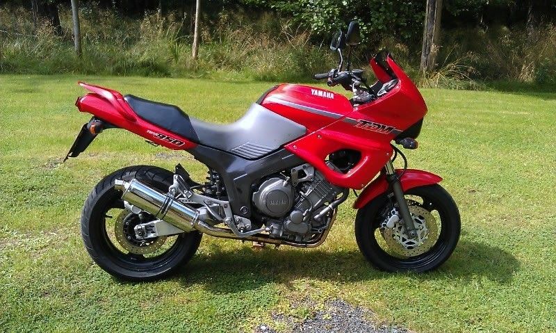

Not fitted the new bellypan yet but the new pipe is shiny...

Whole bike is shiny shiny!
Have you got an inch of fork through the yolk, or are my eyes lying about there being a nose down attitude to that machine?

Whole bike is shiny shiny!Have you got an inch of fork through the yolk, or are my eyes lying about there being a nose down attitude to that machine?
The forks are as standard. It's the 17" Exup front wheel that gives the front a lower look.
QUOTE(Studley Ramrod @ Sun 12th Aug 2012, 04:39 PM) <{POST_SNAPBACK}>
Very nice ! cool.gif What's the swinger off ? The rear looks to be way up there. unsure.gif

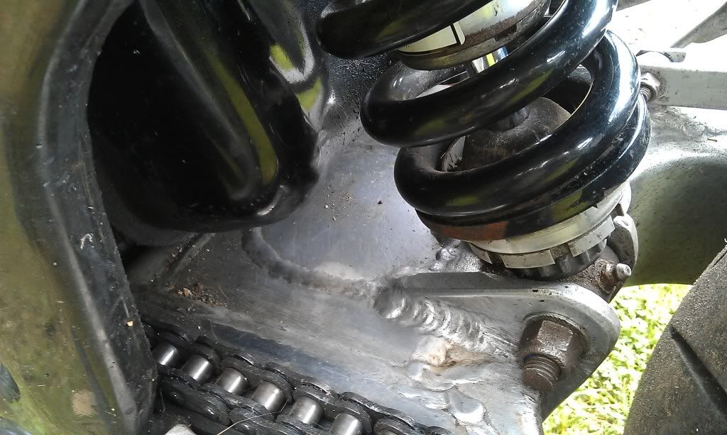

The swing arm and rear wheel are also FZR farzend. The shock mounts directly to the swing arm, which has had an alloy plate fitted where the FZR shock would have gone through, the same as the standard TDM set up. I guess the mount point is slightly different which raises the rear a tad.

Cheers Elv, interesting mod, does it handle well then ?
BTW I've got the same silencer and I can tell you, it marks really easily. dry.gif Already marked mine brushing past a small bush. Sounds good tho ! smile.gif

The bike handles and steers well enough for me. I would imagine the sharpened steering head angle is partially negated by the size of the tyres somewhat. It doesn't wobble or tank slap and appears to be pretty happy.
The pipe was excellent value I think. I haven't tested it's duribility yet but for £248 complete to my door I'm pleased with it and it does indeed sound lovely even with the baffle in. I don't wish it any louder.
